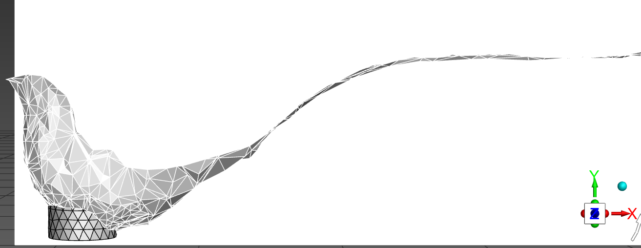

      The buoy is moving, however, it seems like the buoy acts on the water because the free surface is disturbed by it, but the buoy drops like water isn’t there, it even drops faster that free fall with no air friction.

          • 6DOF on, properties mass 75638Kg (Buoy: volume = 141.37m^3, mass = 75,638kg, resulting density = 535 kg/m^3), 1 DOF Translation on, x=0, y=1, z=0). Gravity y -9.8066m/s^2
        • Dynamic Mesh Zones: Created 1 zone with buoy faces, Rigid Body, selecting the created 6DOF properties craeted above, 6DOF on, the rest defaults which are all zeros.
      • Operating conditions: defaults: Pressure of 101325 Pa (atmospheric), Specified Operating Density minimum-phase-averaged
      • Initialization: compute from inlet, open channel initialization method wavy.
      • Calculation: timestep size 0.001s, max iterations per timestep 80, number of timesteps 25000.
      The picture was taken at 0.605 seconds.  The buoy dropped 12.5m. In free fall with no air friction it would take about 3 times that to travel that distance.
      Please let me know what I'm doing wrong.
