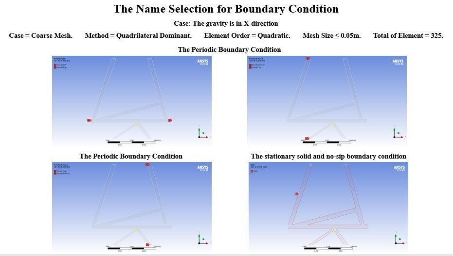

September 10, 2021 at 10:56 amP_Heng
I will send you the boundary condition picture.

September 10, 2021 at 10:59 amSeptember 10, 2021 at 11:19 amSeptember 10, 2021 at 11:21 amRob
Forum ModeratorI can't read that, where (and what) are the boundaries? Given your other thread, make sure you have enough mesh to see any flow profiles: you want 10 cells minimum across the channel.
September 10, 2021 at 11:55 amP_Heng
My prof said it doesnÔÇÖt matter how many cells do I use for the mesh, the flow should parallel the shape of domain.
Now, I can make the flow vectors parallel the shape of domain by use Presto for pressure (in method)
This picture is boundary condition .
if I run the calculation in Ansys Fluent, How can I know my process of running the calculation is Bouyancy or density?
My regards Pho Prosheng.
September 10, 2021 at 2:50 pmRob
Forum ModeratorI can't see what boundaries you have set, and are they flow, hot/cold walls etc. Buoyancy is calculated assuming gravity is on, and the material density can vary: otherwise the buoyancy term is zero. With a near zero velocity and coarse mesh convergence may be poor, and therefore results may be misleading. Refine the mesh, converge the solution and see how the result changes.

Ansys Employee:) PRESTO! is recommended for buyoancy flows and to avoid the velocity issues you saw nevertheless again your mesh is not adequate.
