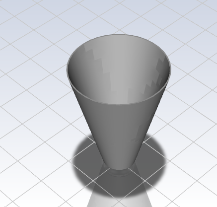

SubscriberI am attempting to make a model with a cone and a flat bottom plate, like this:
The bottom plate is set as a wall that is opaque with an absorptivity of 1 (absorbing all radiation from the sun and anything that reflects or emits off the walls). The cone is set as a wall that is opaque with various mixtures of absorptivity and reflectivity. The walls are set to zero conductivity. The top boundary is set as an velocity-inlet that is opaque with a transmissivity of 1.
The air is also set to a near vacuum (1e-5) and near zero conductibvity (1e-5) because it is attempting to model space, and it is initialized to 2.7K (ambient temperature in space). I have Monte Carlo radiation turned on to re-radiate any solar radiation that is absorbed by the walls.
Running this, I find temperatures that are vastly too high for what is expected in this scenario, and some areas max out at 5000K. Is there anything I am already doing wrong in the setup, or anything I may want to check?

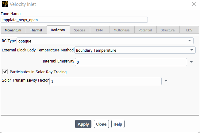

Can you elaborate on how you are setting the transmissivity to 1 at inlet for opaque surface? what is the temperature of fluid entering the inlet? Is the fluid flowing out?

And under the boundary conditions tab, for the inlet condition, I am setting the radiation to look like this:
I am setting the inlet temperature to 2.7K as well as fixing the air temperature to 2.7K under the cell zone conditions tab. I don't have the fluid flowing out anywhere because the bottom of the cone is closed; this bottom face is where I need to measure the temperature.
