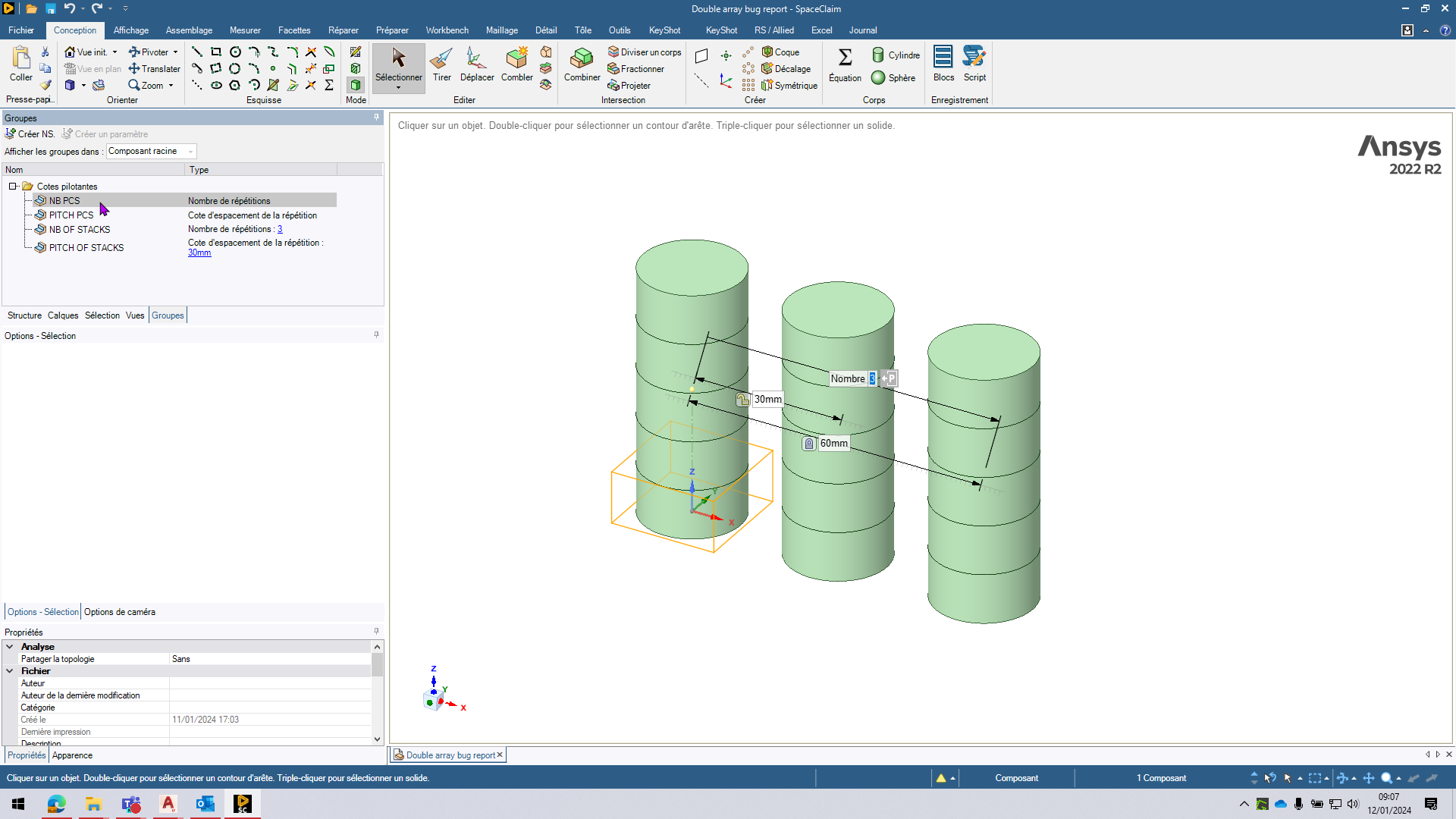

My target is to create an array inside an array and have all parameters a the head of the assembly (to pilot thoses value with an Excel sheet).
I take a first solid and make the first array, this create a first assembly.
I click on the blue "P" button to create :
- One parameter for the nb of pieces
- One parameter for the pitch of pieces
Then i make an array of the first assembly to create a second one.
- One parameter for the nb of stacks
- One paramter for the pitch of stacksÂ
Then i click on "import the components group" to have the parameters of the first array on the main assembly.
This issue is, i cannot pilot the values of the first array, the settings are there but when i click on thoses parameters, it takes into account only the second array, i cannot put a parameter on thoses values :
I encounter this issue only with arrays, if i do the same with other functions, everything is ok.
Below a link with two files wich contain :
- Double array bug report.scdoc
- Double array but report.mp4
https://we.tl/t-kyJAOBVrd0 (The link expire the 19-01-2024).
