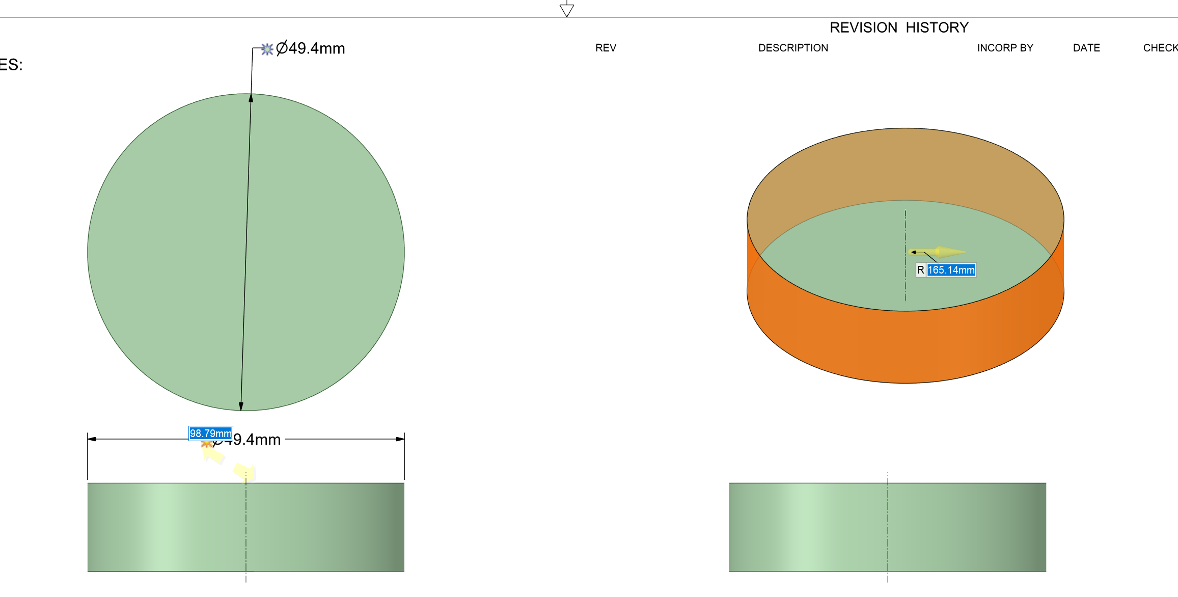

      Hi Support,
      Reporting a few bug with Diameters in the 2025 versions of SpaceClaim. When you add a dimension to a cylinder as below and then click the face in the pull tool and click the white star to edit the value is automatically doubled. If you then click in white space this auto confirms that value. Hopefuly you can see in the image the radius is 45 the value should say 90 once you click on the white star but it doubles.
      Also another geometry bug is the top cylinder in the image below cannot be made larger than the bottom cylinder.
      Thank you
    • Charudatta Bandgar
      This is quite unusual, and seems like a geometry specific issue. Can you try replicating it with other geometries? Also can you do a check geometry on this geometry to see if there are any issues with it? Especially for the second issue you have highlighted.
      Thanks and regards,
      Charudatta B
    • Tim Dukes
      No geometry issues. Geometry created in SpaceClaim 2025 versions just a simple cylinder. Should be easily repeatable by creating a simple cylinder and adding a dimension as below. You will see the actual diameter is 49.4 I am getting 98.79 on the bottom image and a radius of 165.14 on the top actual radius is 24.7
