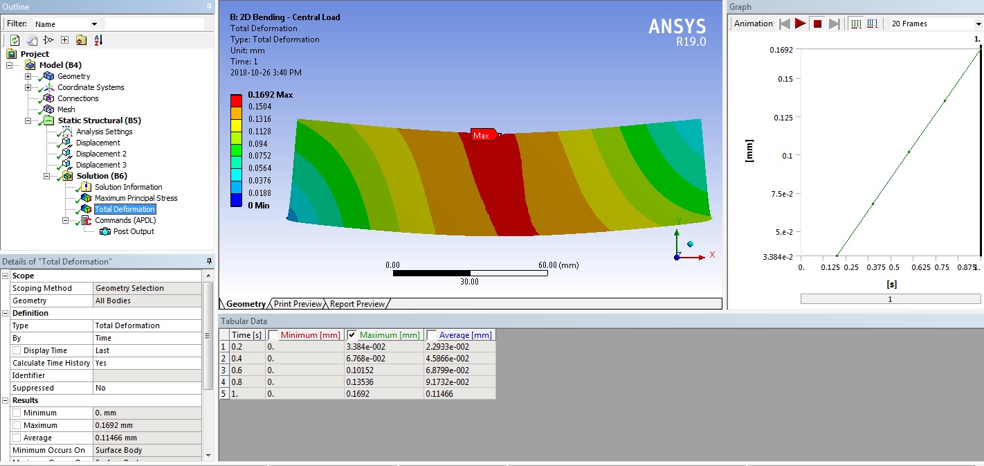

      I made the model in both 3D and 2D. Instead of drawing the physical rollers for the supports and loading, I have split the faces for the loading support at the top and bottom face for the two supports.For the 2D model it is quicker to solve but would be helpful if some expert may comment on whether the designed 2d model is correct or not.
       Jack,
      The 2D model is incorrect for a 3 point bending model because your displacement has selected the entire top edge and not a vertex at the center.  You can create a vertex at the center in DesignModeler by splitting the edge.
      The 3D model has created a narrow face to push on at the center. It would be better to put a remote point on that face and push down on the remote point, which will distribute the force to the face.
      The 3D model also is holding two faces on the bottom with 0,0,0 displacement. That does not represent a 3-point bending test that is typically on rollers. Please review this discussion and come back with any questions.
      The material you call concrete has no failure mechanism in it to generate cracks, but you can evaluate the Maximum Principal Stress and compare it with the Ultimate Tensile Strength to decide if a failure has occurred.  The Compressive Ultimate Strength value in the Material is only used by the Stress Tool to plot Factor of Safety.

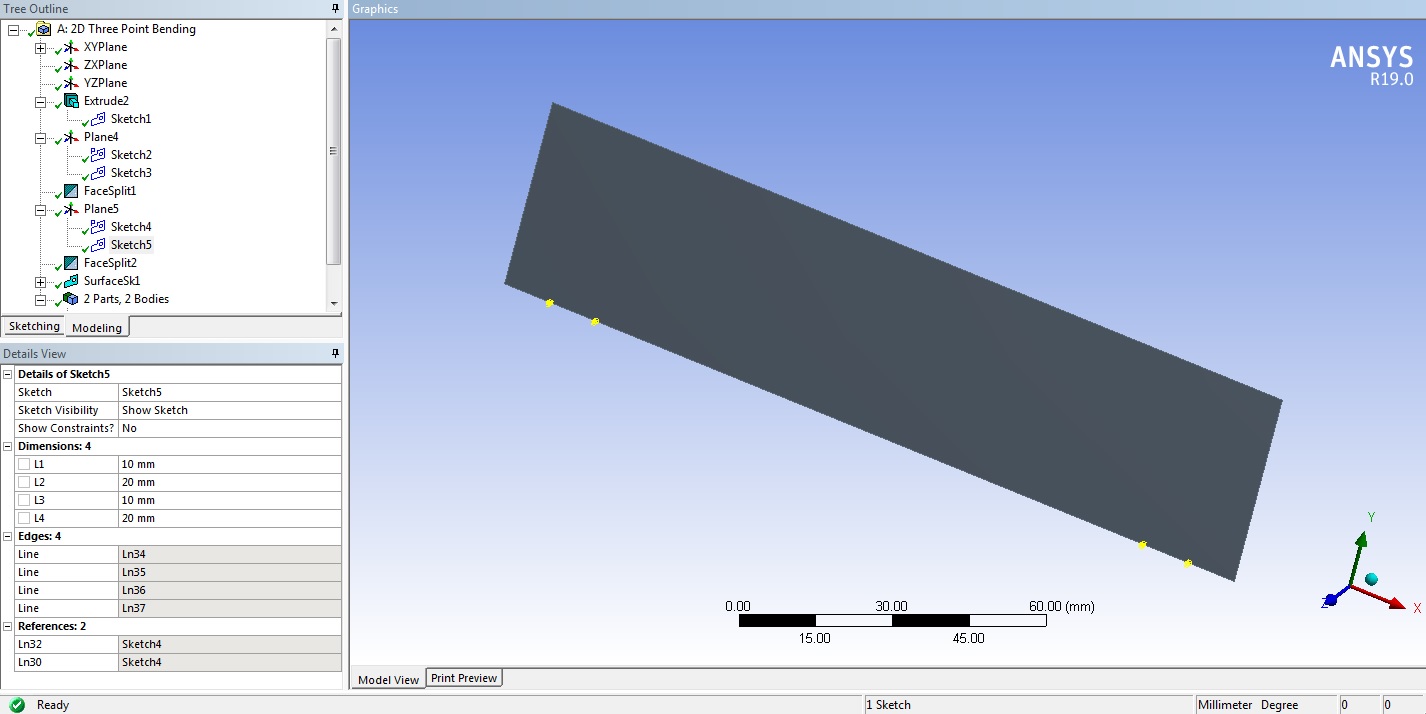

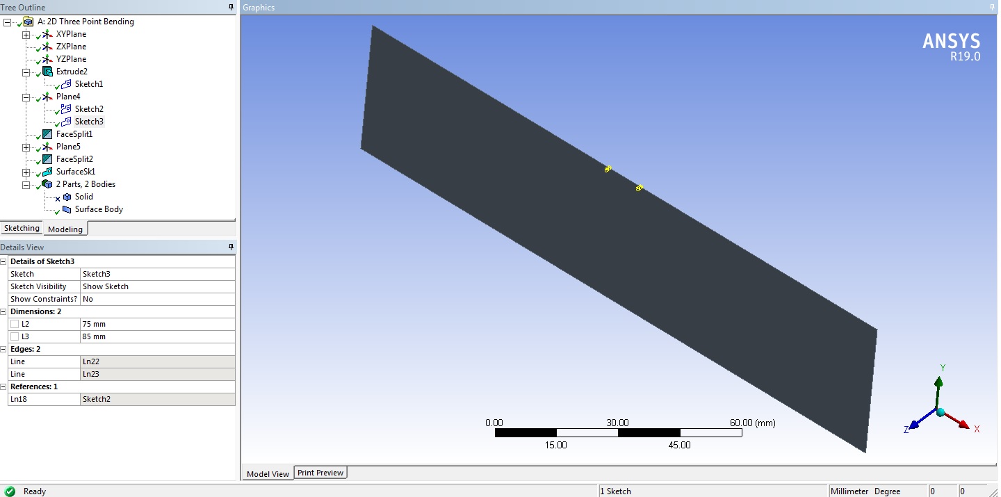

      3. For the 2D model, I split the top face while designing the beam in the Design Modeler.
      I also split the bottom face for two supports.
      But I did not get the split part when I had the final sketch. If you have time could you please take a look at where did I do wrong? It would be helpful if you may provide steps for creating the vertex at the center in DM by edge splitting? I have done face split for 3D models but for 2D I can not exactly figure out.

      3. You can put a plane at the center and use Slice, then put the two pieces in a Multibody part using Form New Part in DM.
      4. You don't need any overhang, you can just apply the supports on the corner vertices.

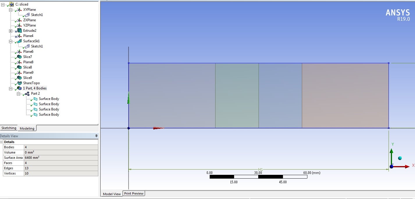

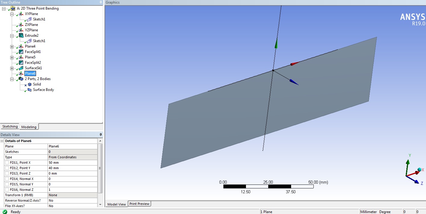

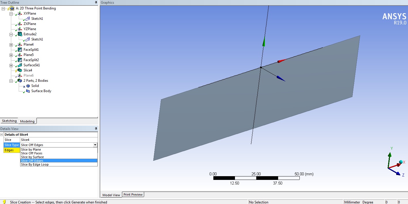

      I can not exactly follow this it would be helpful if you may show the steps graphically (screenshots).
      I created a new plane at  the center.
      Right click on new plane > insert > slice
      Then I get these options and for some of these I can not select the target body or the face for slice.
      The XY axis of a plane does the slicing.
      If you copy the YZ plane to the center, then that will be correctly oriented to do the slicing.
      You can change the Base Plane to YZ or you can rotate the plane you have at the center.

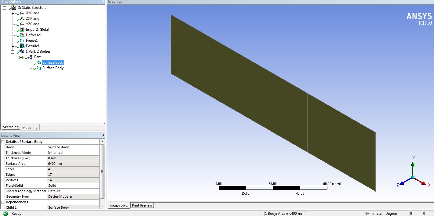

    • jackhero
      I followed the instructions and ended up with this.
      However, while applying load on the top surface I can't find the vertex using the vertex selector. I turned on to show all the vertex and the point I created is not shown in there. Have I missed something in the DM or I am applying the loads in incorrect way in Mechanical?
      In one of your earlier screen shots I saw a Solid that was suppressed and a Surface Body that was not.
      In your recent screen shots, I see the Solid has been sliced into two, but the Surface Body has not.  Delete the Solid Body and try the Slice on the Surface Body.
    • jackhero
      I re-modified the design to slice the Surface Body. After Slice I selected both parts and formed a new single part. This is the final design I get in the DM.
      I am not sure if I have followed your instructions correctly but I am ending up with this in the Mechanical. I had to separately assign Material Properties to both of the Surface Bodies under Part 2. Is it normal to have like this or I again have missed something in the DM?
      Yes, each body needs a material assignment. That is one of the benefits of Slice.  Instead of slice, you could have used Concept, Split Edge, and created a vertex at the 50% point on the edge.

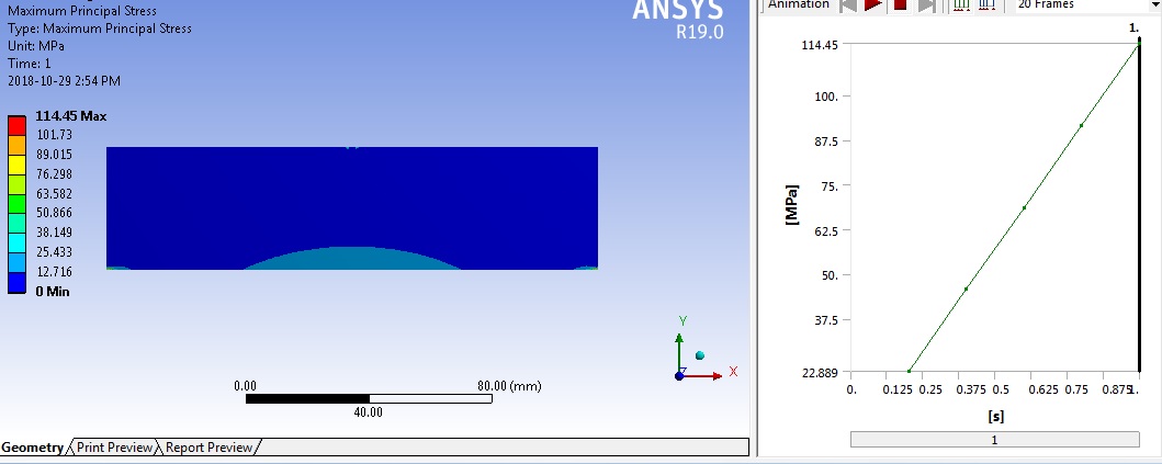

      I ran the simulation and request guidance on the following queries;

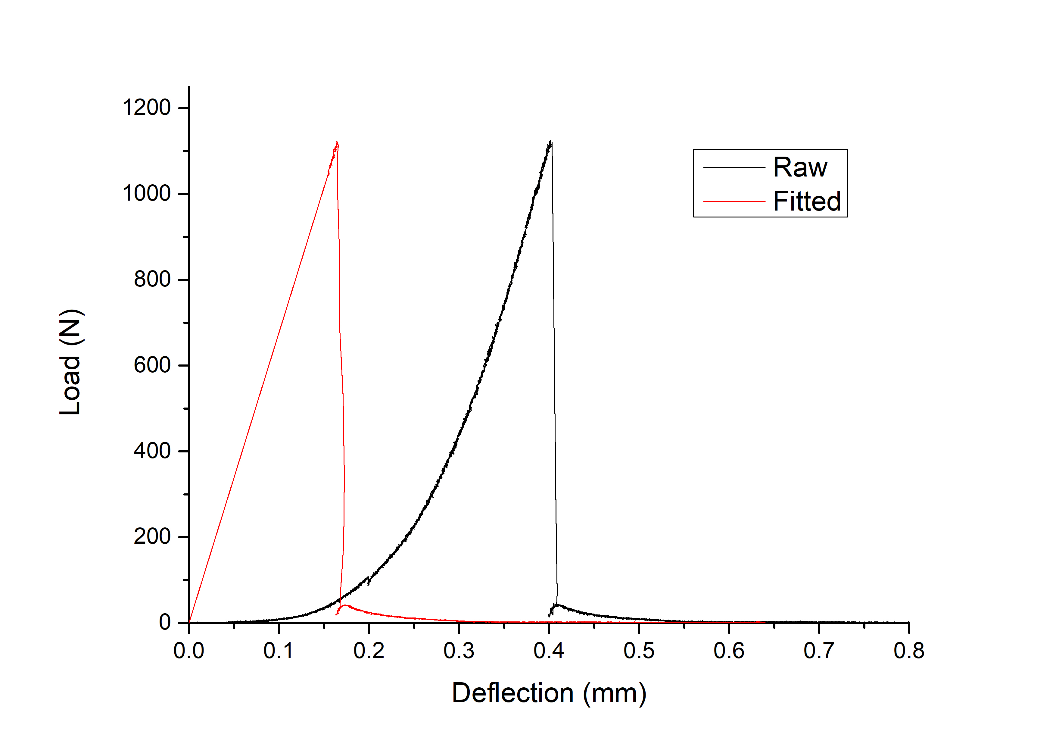

      (1). In the experimental result, the deflection at (brittle) failure was 0.16mm with a maximum stress value of around 3Mpa. The test was carried out at 0.5mm/min of the displacement rate. I would like to ask when running a simulation, and the aim is to verify the experimental results, how to decide or calculate how much of the displacement or load in boundary condition should be applied to get the almost same result as that of the experiment?
      (2). I applied the displacement of 0.16 mm and ran the simulation, I get the maximum principal value as of around 114Mpa. The resultant maximum load is too high then the expected value.
      I then ran number of times with different displacement boundary conditions until I had the maximum load value of around 3Mpa in the simulation. I had this value on the application of 0.004mm of displacement boundary condition.

      (1) In the experiment, you can measure deflection, but you can't measure stress. Where are you getting the 3 MPa stress value from.  The experiment applies a force, what was the force just before fracture? It would be best if you can get the force-displacement curve from the experiment. In the simulation, you can plot a force-displacement curve, export that to Excel and overlay the two curves.
      (2) The maximum stress in your simulation is coming from the support, so is irrelevant, because your support is on a vertex, which is an idealization that causes high stresses that should be ignored. One technique to be able to easily ignore the stress at the support is to slice the body at the 25% and 75% of the length, and put those three bodies in a multibody part and use Shared Topology to mesh them back into a single beam. However, you still have 3 bodies, so when you request a stress output, just pick the center body and the maximum stress should be in the center.
      (2-i,ii) Do the multibody part method.  You might need to split the top edge to make a small length to apply a remote displacement to avoid a peak stress at a single vertex on the top.

      (1). From the experiments I had the load-displacement values which I later converted to stress in excel to compare with the output of maximum principal in ansys workbench. If I could verify the load-displacement curve it is also ok. Attached is the load-displacement curve of the experimental test. The maximum load is around 1120 N. With this result how shall I calculate the value of remote displacement which I shall to apply to verify the simulation and experimental results?

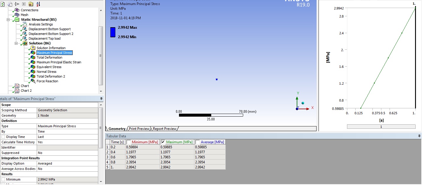

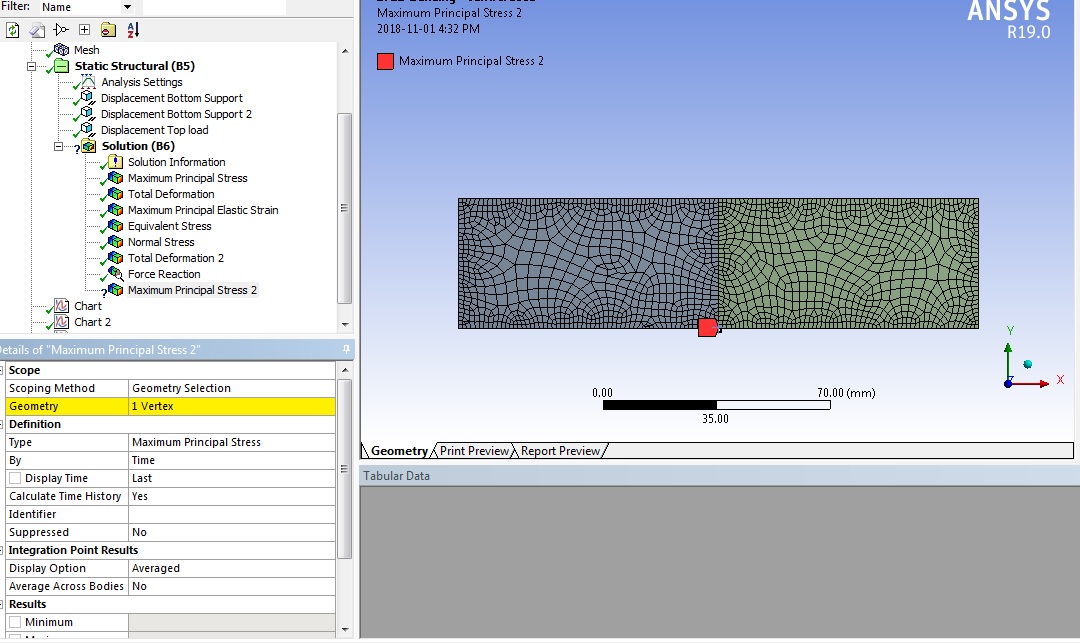

      To get the Force Reaction at the bottom vertex I tried selecting the bottom vertex but I got a question mark next to the Force Reaction.
      I selected the Force Reaction of Top Displacement and following results are all according to this Force Reaction results.

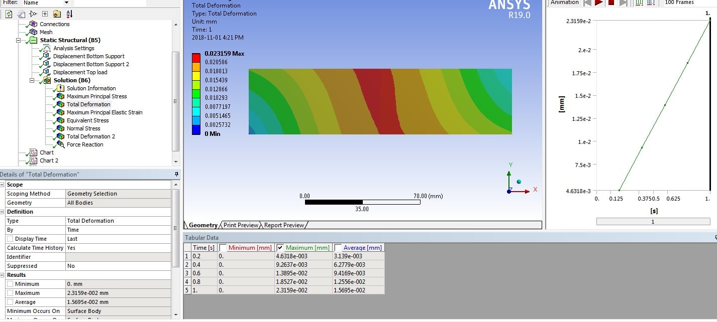

      The first simulation I ran at top Displacement of 0.16mm and I had the following Force Reaction (152.54 N) and Max Principal Stress (114.45 Mpa) values.
      For the load ratio I followed as,
      154.54 / 114.45 * 3 = 3.99N
      where 3 Mpa is the experimental max stress value.
      I re-ran the simulation with 1mm of Top displacement and had the Max principal (715.3 Mpa) and Force Reaction (953.39 N).
      953.39 / 715.3 * 3 = 3.99N
      The load ratio, if I have calculated correctly, is the same for both simulations which you have also mentioned that the ratio will be same. Does it mean that according to FEA the load at failure is 3.99N?

      Reaction Force is only available on Displacement or Fixed Boundary Conditions, which is why you can get it at the top.
      When requesting Max Principal Stress result, you must change the geometry filter to Vertex and pick the vertex at the bottom of the center of the beam. The screen snapshot above shows the whole body, which includes the stress concentration at the supports that we want to exclude.  Looking at your contour plot, once you do the vertex, the answer will be between 12 and 25 MPa.  Let's say it is 20 MPa. So at a force of 152 N, you got 20 MPa at the bottom of the beam.
      What is the published Ultimate Tensile Strength for the material?
      Let's say it is 3 MPa.  That means you pushed too hard in the model.
      Force at Failure would be  152.54 * 3/20 = 22.9 N.
      The displacement that would give that force is 0.16 * 3/20 = 0.024 mm.
      The above calculations are assuming the Ultimate Tensile Strength = 3 MPa.

      For either linear or nonlinear, it is best to configure the simulation end displacement to go past the experimental displacement at which failure occurred.  Though for linear, it is possible to go less and use the ratio, but for nonlinear, you must go past. The solver may stop due to convergence issues before the end simulation displacement is reached, but if that was because of material failure, that is okay.
      Peter

      I am unable to select the center vertex at the bottom of the beam for Maximum Principal, and even for the Deformation have the same issue. Can you please provide any suggestion for this?
      For the time being I selected the bottom center node for the results. The max principal value is 3Mpa with the suggested application of 0.0219mm displacement. Since I only selected the node for the results of Max Principal and Deformation therefore in the output I could only see that node. In one of the result I selected All bodies for the total deformation and I had the image like shown below. The maximum deformation, in case of All Bodies, has been shown to occur at the center and this is where, i think, the maximum was expected. But could I get same in the Maximum Stress image? So that I can show the stress concentration or max stress at or right before the point of failure. Maybe since I have currently selected bottom node so the results are like this, but if I select bottom center vertex maybe I could get image to illustrate the failure.
      Currently, I have the output values of Max Principal (at node) which I can plot with Total Deformation (at node) but the deflection value of experimental outcome (0.16mm) is different than that of the FEA Total Deformation (0.0219mm). Is it the correct way to plot the x-axis of FEA Total Deformation values and y-axis of FEA Max Principal along with the Experimental Stress values? OR plot the experimental x-axis of deflection values and on y-axis plot the FEA Max Principal and Experimental Stress values?
      Although the verification value is the Max Stress results, which for both FEA and Experimental output are same. But theoretically wouldn't be the two different x-axis deflection values be of any concern/question? And with the given 2d Model and FEA outcome, the only possible result I could mention/show to compare the FEA and experiment results, with FEA value reaching 3Mpa and we assume that the failure had occurred in FEA as well?
      I don't know why you can't pick a vertex. The purpose of selecting the bottom node for a stress output was to get a single precise number for the ratio calculation. Now that you have that, you can plot stress on the body.  On the Legend, you can type a new number for the boundary between orange and red.  Type 3 MPa to represent the Ultimate Tensile Strength.  Instead of Total Deformation, plot Directional Deformation and pick the Y axis.  You can use Reverse Rainbow for the colors on the Legend.

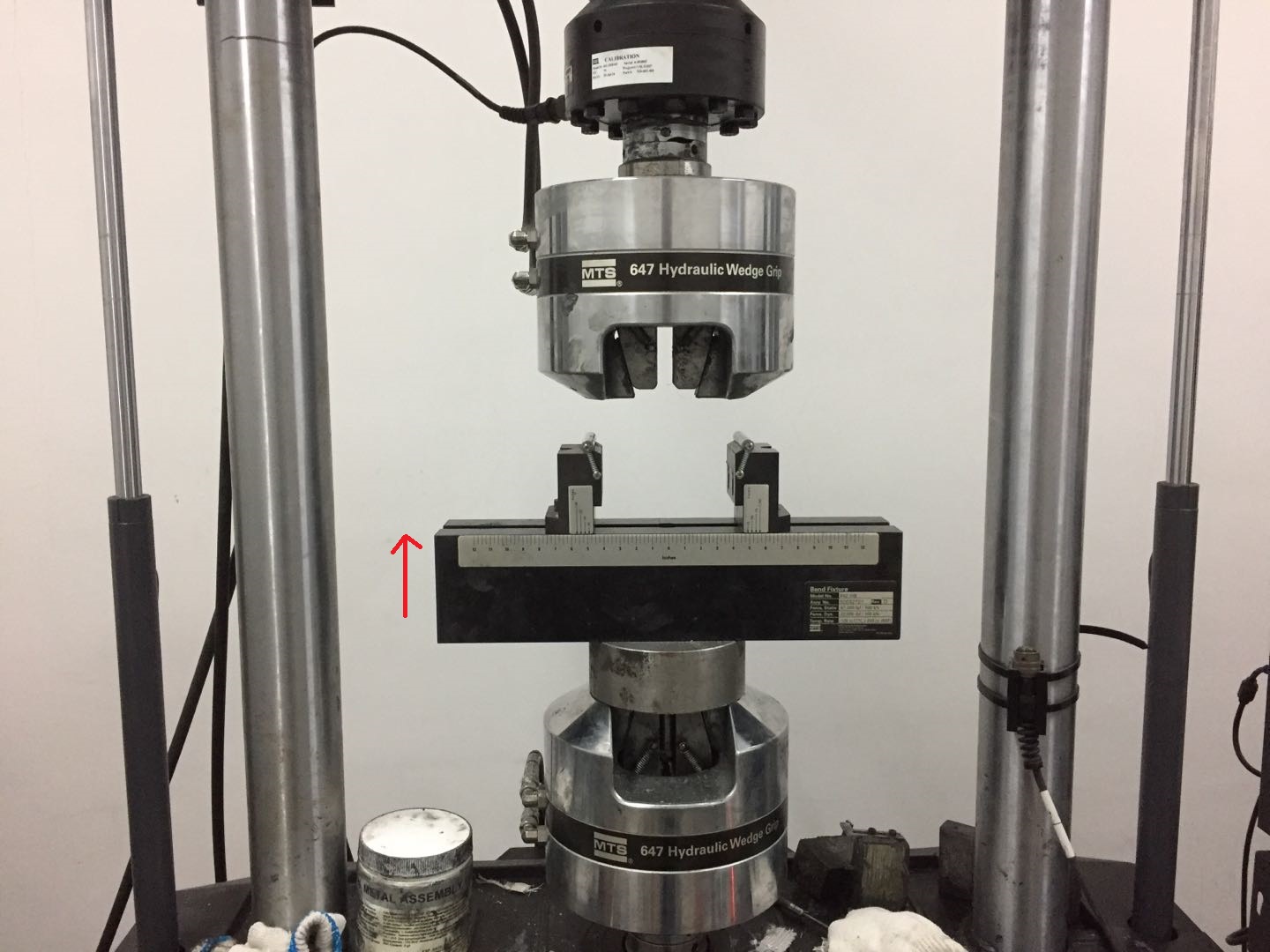

      Please reply with a description (photos?) of how the experimental displacement was measured. If the displacement was measured from the concrete floor, the deflection of the beam supports was also being measured. Please reply with a description of the force measurement transducer. When was it last calibrated?  What is it's full scale range?

      The deflection (displacement) was measured by the movement of the actuator (shown by the red arrow in the image below). Please mind the top grip that was later replaced with another one (not shown in image) for bending with one support in the middle.
      The force was measured by the load-cell with a capacity of 100KN, however the calibration date is two years old.

      Thank you for the description and photo. The experimental setup is missing the displacement transducer under the center of the beam. This is a standard method of recording data in a three-point bending test and typically uses an LVDT displacement transducer.  Here is one paper on the errors in using cross-head displacement.
      The Deflectometer or Displacement LVDT transducer should have been mounted to the base where the supports are. A direct measurement of the deflection relative to the supports is the most accurate measurement. Measurements made using the displacement sensor on the moving crosshead measure the combined displacement of the machine frame and the sample. What if half the measured displacement came from the flexing of the machine frame, and half was the flexing of the sample?  Maybe it's not that much, but you don't know.  One way to get an idea of the flexibility of the machine frame is to have no sample, and run the center pusher into the Machine Base. Run the machine up to the same load that was used to fracture the sample. What is the measured displacement of the machine frame?
      Another source of displacement error is the settling of the sample into the supports and nosepiece pushing on the top. Did the displacement output values have the offset subtracted from them?  Below is the output from a tensile test that had a small offset.

      I am attaching the data file with raw data values (here) and the calculated deflection and load values. I think maybe I did not do the fitting /offset correctly (the data doesn't include the fitted values). I had to subtract the initial actuator position value from the recorded displacement values to get the actual displacement. Apart from the displacement and load values, time is also given in seconds. In your knowledge could you please mention any link/guide on correctly offsetting / removing the idle part from load-displacement graph?
      Almost all of the raw data had the offset/idle part on the graph before the actual load began and I had to fit the data to remove the idle part. Your suggestion on error in offsetting deflection value is correct. It would be much helpful if you may provide any guidance on correctly off-setting the raw data. The raw data curve had this kind of plot.
      Thank you
    • jackhero
      I suggested earlier that an initial crack in the physical beam sample can significantly weaken the beam and cause the fracture to occur at a stress much lower than the theoretical strength of a flawless specimen. You can use Fracture Mechanics to introduce an initial crack length of 3 mm and calculate the failure load. Use different crack lengths to find the one that matches the experimental result.
      May be I didn't explain properly. Regarding the cracks, in my last post, I meant with reference to your above quoted reply. In the experimental work, I did not have any initial crack (or initial flaw) on the beam, so if I have to match the Fracture Mechanics results with the experimental result, as you have suggested, then how shall I match without experimental result values?  As currently the only experimental result I have is of the flawless specimen or beam, not of the beam having initial flaw in the form of certain crack length.
      In Ansys, I can introduce an initial crack of certain length, say 3mm, but how shall I estimate the failure load?
      When I plot the raw data in the spreadsheet you provided in the link, I get very different values of displacement compared with the image of the plot in your post.
      Below is the plot of the spreadsheet data. Why does this data go out to 0.7 mm while the data you show above goes to 0.4 mm? The post from 2 weeks ago has an even shorter displacement of 0.16 mm.
      I fitted two lines to show how to extrapolate from a linear portion of the curve back to the Deflection axis to find a zero point. There was a softening of the beam between the green and red lines. That could have been when the first crack appeared.
      Is it possible to trace the load-deflection of the testing machine when the nose is pushing on the support base without any sample in the machine?

      If I get access again I may run the machine without any sample. But I think without any sample, there would not be any load (in Newtons) to be sensed by the machine. Would it be ok if I run the machine, at the same displacement rate, for the same amount of time (in seconds) as that of the sample which we are discussing here. And get the data of load-displacement for the respective period of time.
      For the speciemen data I uploaded I will check again and then update this post.
      Jack, you run the machine in the closing direction until the pusher starts pushing on the base of the machine, then it will sense a load. If the machine won't close to the point when that happens, you move the supports so close together that they are touching and put a thick steel plate across them to push on.
      You are trying to measure the stiffness of the testing machine frame without a sample to bend.
    • jackhero
      The last data I uploaded is also from the same test but not the same specimen whose graph I upload previously. Please see the file here for the raw data. The first three columns is the raw output from the machine. The initial actuator position value was subtracted from the recorded displacement values to get the actual deflection given in column E. The resulted graph is shown as black in the image (having 0.4 mm deflection). I fitted the graph (data given in the file with red header) and resulted in red graph shown in the image (0.16mm deflection). I think the fitting is not correct and this is where I get the wrong deflection value.
      According to Ansys simulation I may get the maximum load around 3MPa with 0.022 mm, with the given Engineering data values. Issue is if the experimental deflection value, for corresponding maximum load, is not correctly interpreted the Engineering Data values also become  doubtful.
      The maximum load value is almost same for all of the specimens tested. However, the raw data deflection value vary, two of the samples we have seen here had raw deflection of 0.4mm and 0.7mm.
      You can create a Named Selection of elements from the center 50% of your beam and plot the stress using the Named Selection instead of the body.  The other way I mentioned is to slice the body into 3 bodies, then you can plot the stress of the center body.
      I followed the instructions of slicing the body into 3 to plot the stress of center body, and had the following output. I hope you meant to have the same.
      Yes, that is what I meant. If you turn on the Max flag, where is it?
      The stress along the bottom seems to show values that are around 3 MPa, but the Tabular Data shows 12 MPa. Is the Max value at the contact point above?

    • jackhero
      Please see the attached image for the Legend with Max flag. The Max value is same as that of the Tabular Data. The Max value on the Legend and Tabular is 12MPa while as for my model is around 3Mpa. Except the Max value I am able to edit the other values shown in the Legend.

      As per your suggestion, I tried slicing the center block to make a small length or area at the top of the beam (followed instruction given in here). But while meshing I am getting an error, I must have missed some step while slicing. The design is shown below,
      Due to the error in the mesh, the solution also could not be run. Hope to have your guidance on it. Thank you
      The graphics look like there are three bodies but I only see two bodies in the Outline. How is that possible?
      You can make two planes and cut top to bottom and get 3 bodies, then put all three in a multibody part.
    • jackhero
      I followed the following video for slicing, I added the link in my previous post but it didn't work so I am adding it here again.
      https://www.youtube.com/watch?v=HYN9WuNr08U
      The original geometry on which I was working before your suggestion on slicing the top for small area, is shown below.
      According to the video instructions, the first step was to select Freeze, which in my above shown geometry I couldn't do. Therefore, couldn't follow the rest of the steps. I saved the geometry and then imported it in new Static Structural Schematics. When I imported, the DM considered the four bodies, of the previous geometry, as a single body (shown as the first Surface Body under Parts in the image below). Since the geometry is imported that's why I have the Unfreeze in the tree line, I had to generate after import to get the geometry. I followed the instructions from the above mentioned video to slice and make the small area (shown as the second Surface Body under Parts in the image below). This is how I had total of two bodies, instead of actual five.
      I searched for making a small area by slicing but I could not find except this video, which i thought maybe relevant to my case/model. If I am going in wrong direction, please guide me on the mistake
      Thank you
      You don't have to make a small area, you need a short edge on the top. After you slice into three bodies, a left, center and right body, you can get a short edge on the top of the center body by using Split Edge instead of Slice.
    • jackhero
      I hope I have followed the instructions correctly. Please see the image for the Split Edge on the top of the center block (red arrow pointing towards that edge) and I have three bodies (left, center and right).
      I re-run the model and had the Maximum Stress values as following, I tried modifying the legend to around 2.9MPa
      The Maximum Stress value on the center block is 6.9MPa, lower than that of the previous result (shown in first image of the stress in my post here) and nearer to the value we are trying to achieve. However, the Max stress value is still higher than that of the second image in the same post.
      Delete the Displacement on the short edge and replace with Remote Displacement. For the Behavior of the Remote Displacement, there are two choices, Rigid and Flexible. Make sure to choose Flexible.  Enter only a Y component of displacement and leave all others free. If this doesn't work, make the short edge longer.
      Since you seem to be able to slice complete planes, you could make the following slices and break the short edge at 50% to apply the load, then you would have a small piece at the top of the center block to exclude from the plot, as well as the end blocks.
    • jackhero
      Yes, I have used the Remote Displacement on the top and Displacement on bottom vertices as support. I assume by Flexible you meant to choose the Deformable behavior.
      I changed the short edge length number of times until I got the Maximum Principal value of around 3MPa.
      Thank you for your suggestion, but I regret to say that recently I do not have access to the machine. I may not be able to try it. If there could have any other possible workaround, then it would be much helpful.
