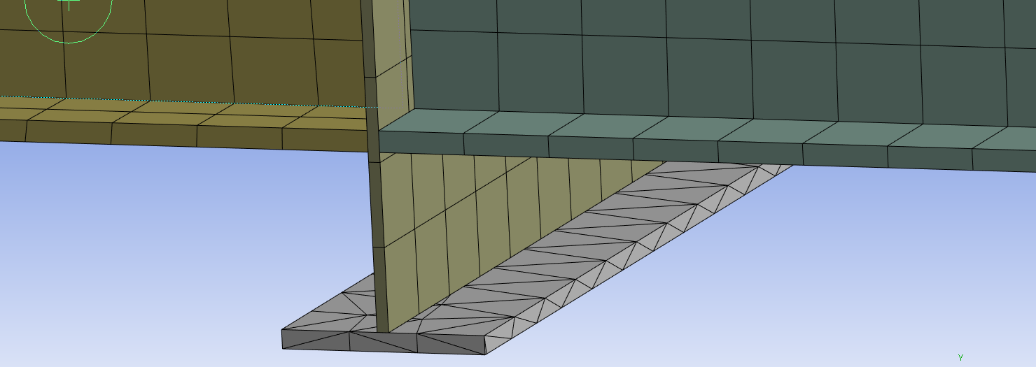

        Hi Peter, I will use 3D solids for the thin steel girders in the end. How can I tell the meshing program to do minimum four layers of meshing between two faces?

      I am analysing two different bridge girders (concrete and steel):
      • Concrete which have thick girders (the image shows a cross-section) (vertical elements are not piers, are girders (beams)).
      • Steel which have thin cross sections
      In order to use shell elements, should I use them in both typologies or only in the steel one as I am dealing with thin elements?
      For the steel girders, you have two options.
      Beam Elements
      SpaceClaim, on the Prepare tab, has an ability to convert a solid shape that is a clean extruded shape, into a beam element, which looks like a line but has the cross-sectional properties of the solid.  The advantage of using Beam elements is you can output Bending Moments and Shear Forces very easily from the analysis. However, there is just a row of nodes along the neutral axis of the beam so the deck connection has to reach down to that row of nodes using a joint.
      Shell Elements
      SpaceClaim has a Midsurface Tool on the Prepare tab. Shell elements allow you to connect to nodes on the top flange or bottom flange. Now there are girder nodes next to the deck nodes to make a connection, but it is more complicated to extract bending moments and shear forces.
      Keep the concrete girders as solid elements.
