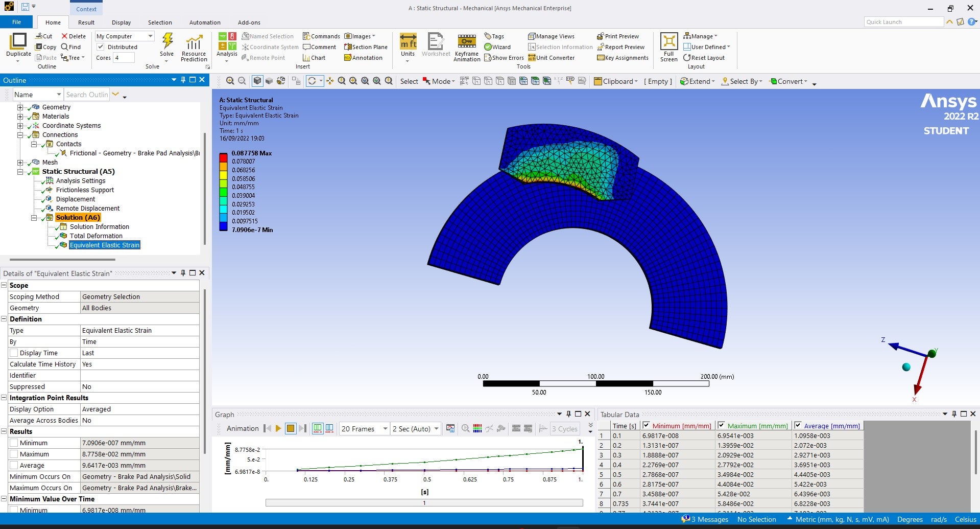

      Hi, i'm having a problem regarding the Brake Pad Analysis Simulation. when i tried to run the analysis, the solid / brake disc are not rotating within the axis, and result in the sliding of the brake disc, as shown in the image below.

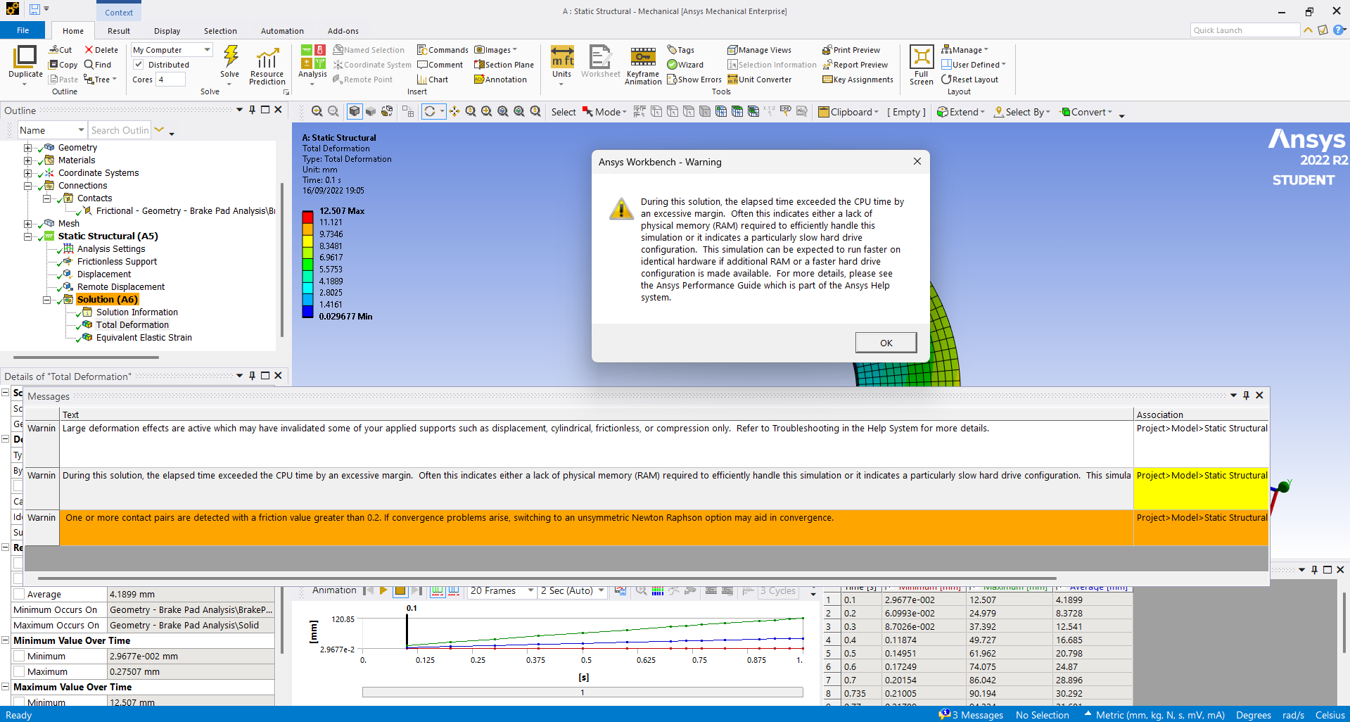

      also i found these errors when i finished the simulation :
      any help would be much appreciated

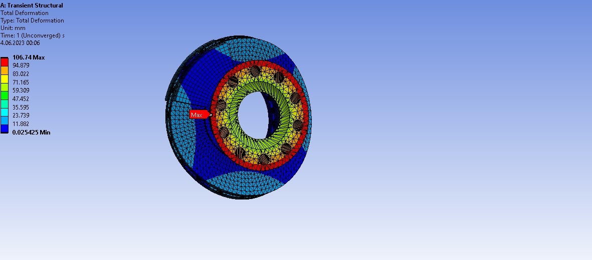

      Hello. I want to analyze the stress when the pad presses against the brake disc. But there is a large deformation error in the analysis. The disc does not rotate on its axis. Can you help?
