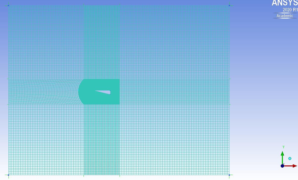

      I have calculated an y(distance wall to node)=5.1e-7m and therefore the height of my first cell to my understanding is yh=2*y=1e-6m. I attached two imagesof my mesh. I can't say if I have enough resolution to pick up the streamwise flow gradients. The angles of my cells are >27°, the aspect ratio is very very big due to the resolution near the boundary layer. I also can't say if the boundaries are far enough away from my area of interest.
      I hope this information is informative in order to understand my problem.
      Mesh 1Mesh_2
    • Kalyan Goparaju
      There is too much of a jump between fine region around the wedge and the 'far-field'. I would strongly recommend creating a smoother transition between the  different regions.
      You also need to review the mesh aspect ratio.  Have a look in the tutorials and/or online to see how the aerofoil examples are meshed.
