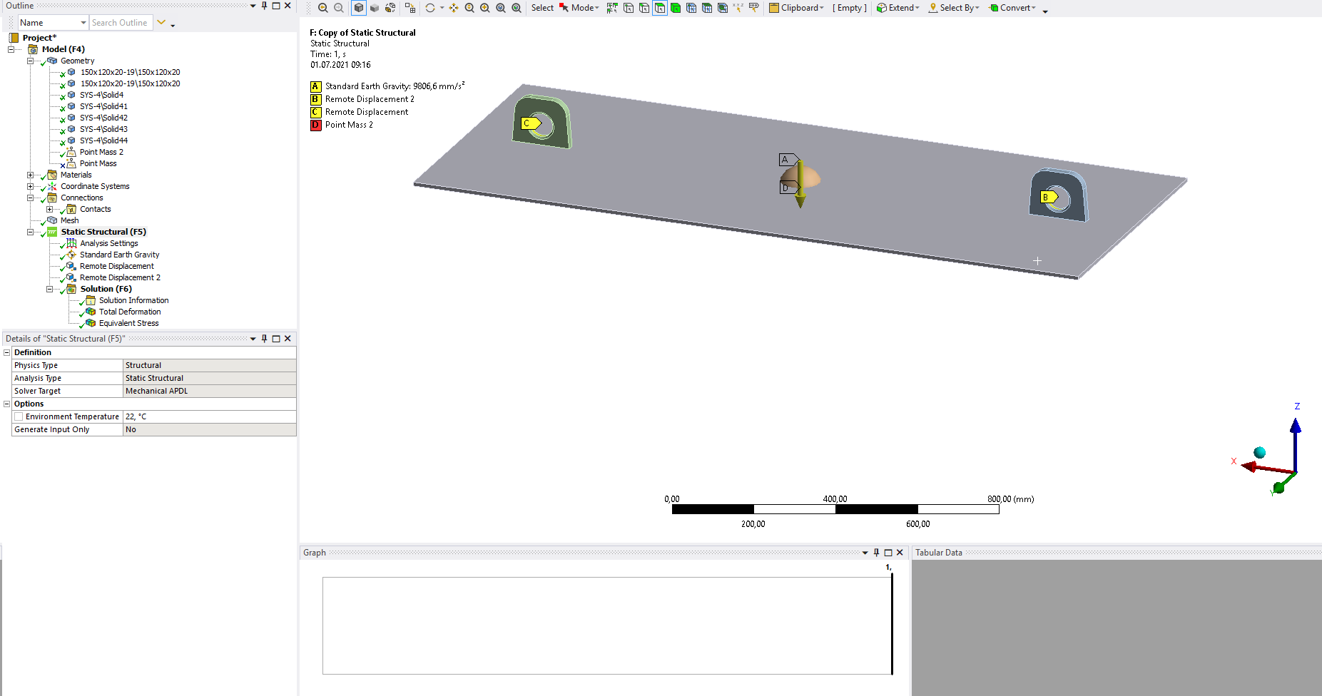

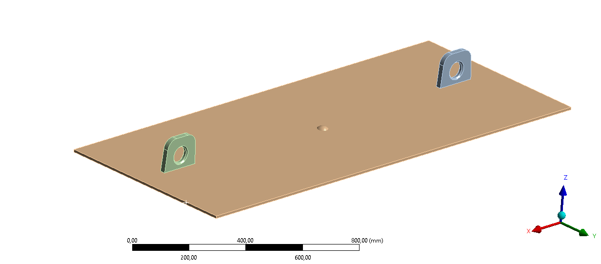

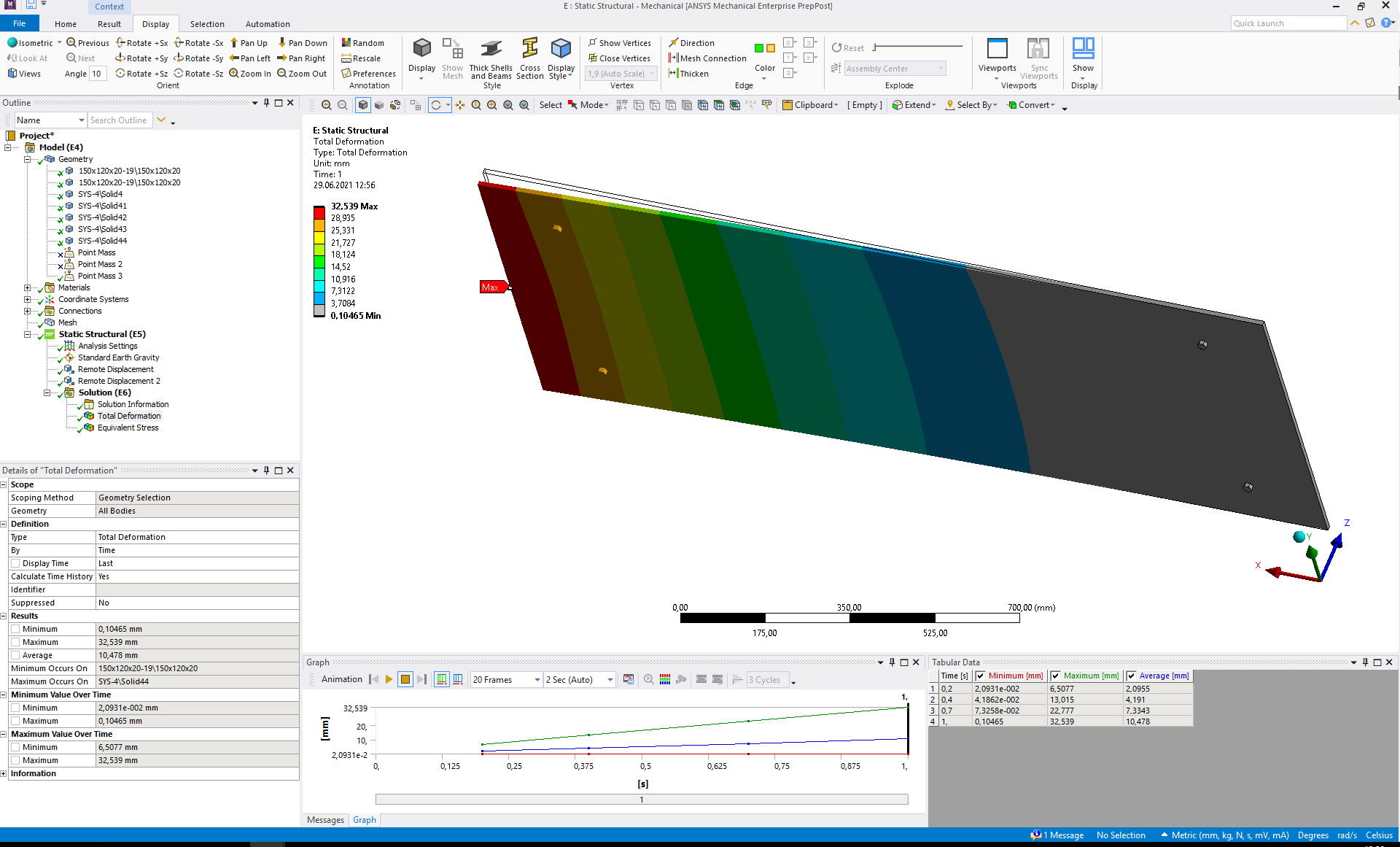

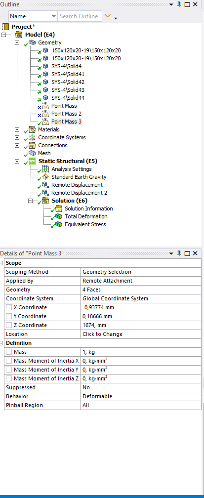

I am doing structural simulation of a cover plate. I have a cover plate with two lifting lugs attached on the top (as shown in figure) and 4000 kg of mass is attached at the bottom of the cover plate (which I took as point mass in model). This lifting lugs (holding cover plate with 4000 kg weight) is lifted by crain in Z axis. I want to see the bending at the cover plate.
For which I have considered the ''Remote displacement boundary condition on edge of the cover plate (I cannot take fixed boundary condition because it is not fixed) further more I have tried to add stiffenes on the wall but it is not stable.
Can anyone suggest me which boundary condition I need to consider ?
p.s.- I have theoretical result and practical result, which is quite similar, whihc is around 80mm deformation at middle of the plate due to lifting.
cover plate dimensions are 1750mm*720mm * 10mm thickness.
Thank you !

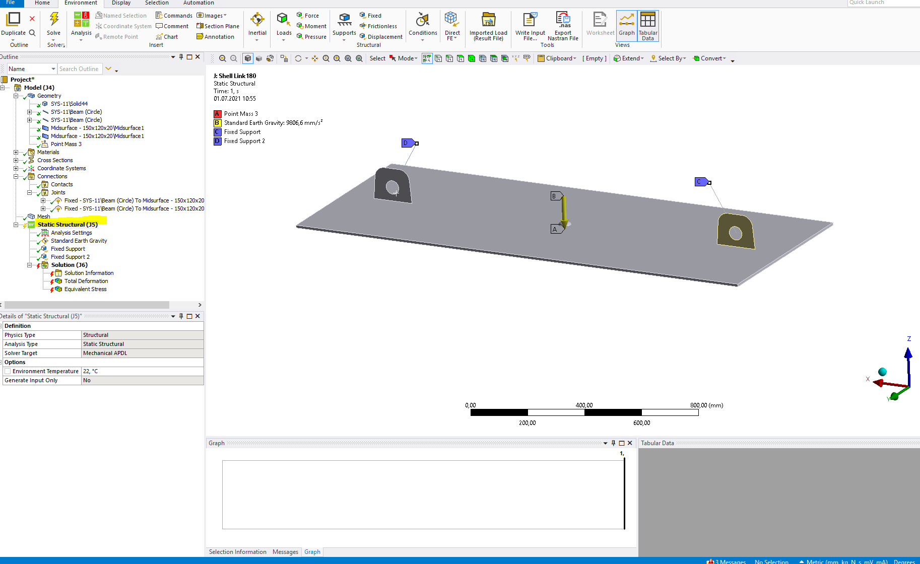

June 28, 2021 at 11:41 amerik.kostson
Ansys EmployeeHi
Try two remote displacements, so one for each lug (scoped to the inside lug face) - for both, restrain all translations (X,Y,Z =0) and rotations about X (=0).
The try to solve with a smaller mass - say 1 kg to see that the system is balanced and can solve.
When it does, include large deflections (ON), and run with the full weight - set substeps : /forum/discussion/9325/substeps
Also include an image in the next post so we can see how the structure is supported.
Thank you
Erik

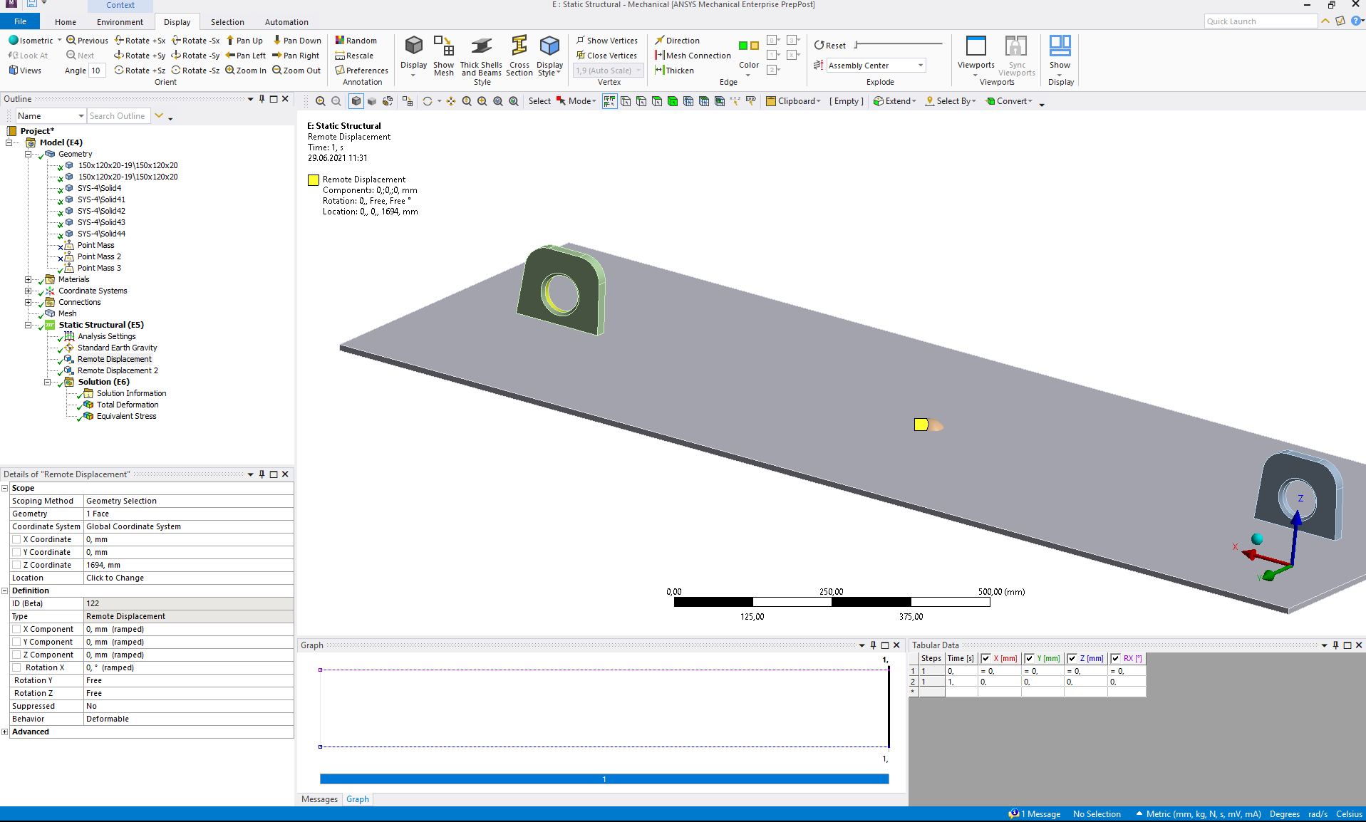

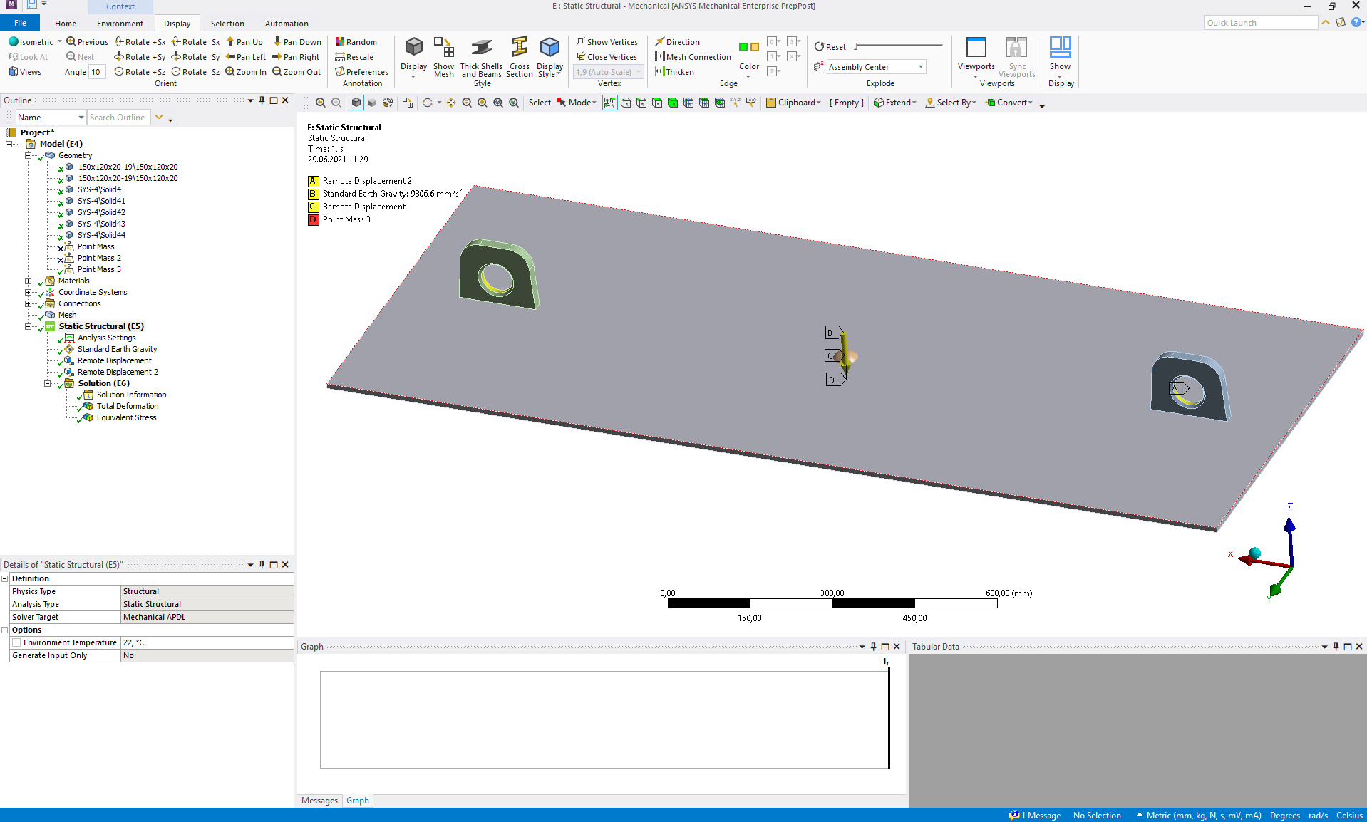

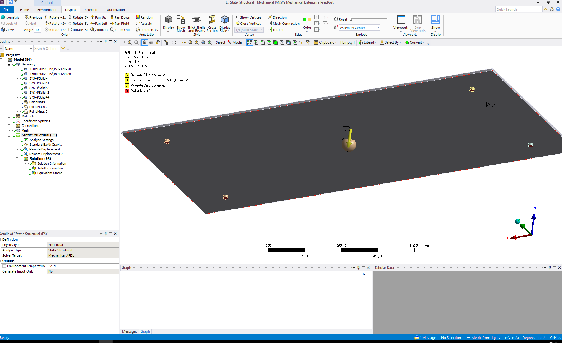

I tried approach related to remote displacement, (in attached picture you can the boundary conditions ).

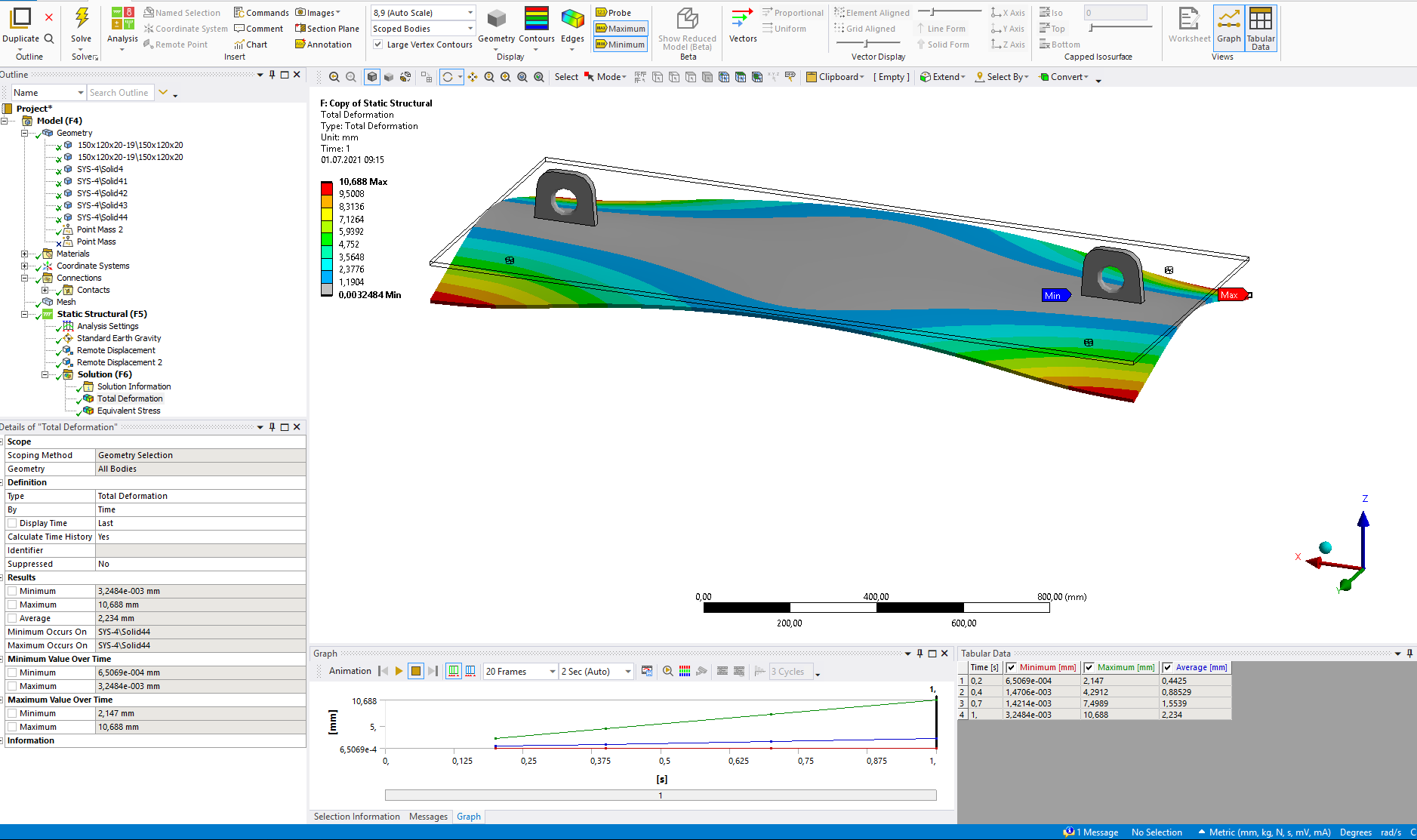

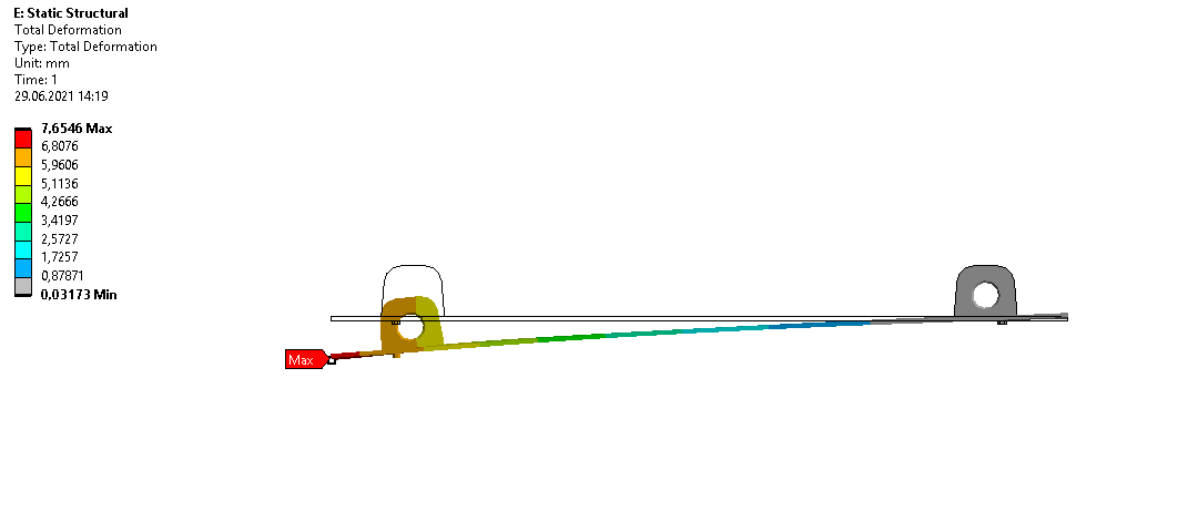

I have applied 2 remote displacement to each lifting lug inner surface with (X,Y,Z displacements to zero and rotation about X=0) and considered point mass 1kg with large defletion OFF. But in this case I am getting unbalanced deformation (in attached picture). My geometry is symmetric. I don't understand why is it so ??

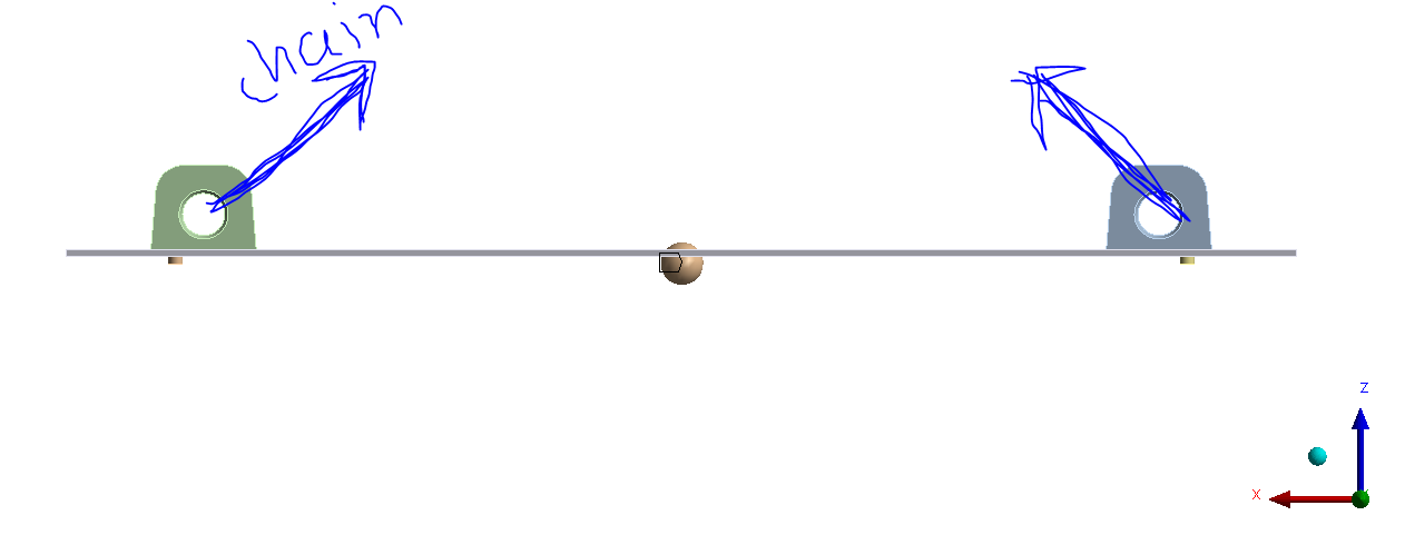

In reality Cover plate is deforming high in the middle (not at the corner) and lifting in reality is at some angle (in picture first picture) (This reality simulation I would do with ''Link180 element''- But I am looking for some tutorial related to this).
Thank you!
Best regards Vishal
June 29, 2021 at 11:46 amerik.kostson
Ansys EmployeeHi
Can we see the results from different views please.

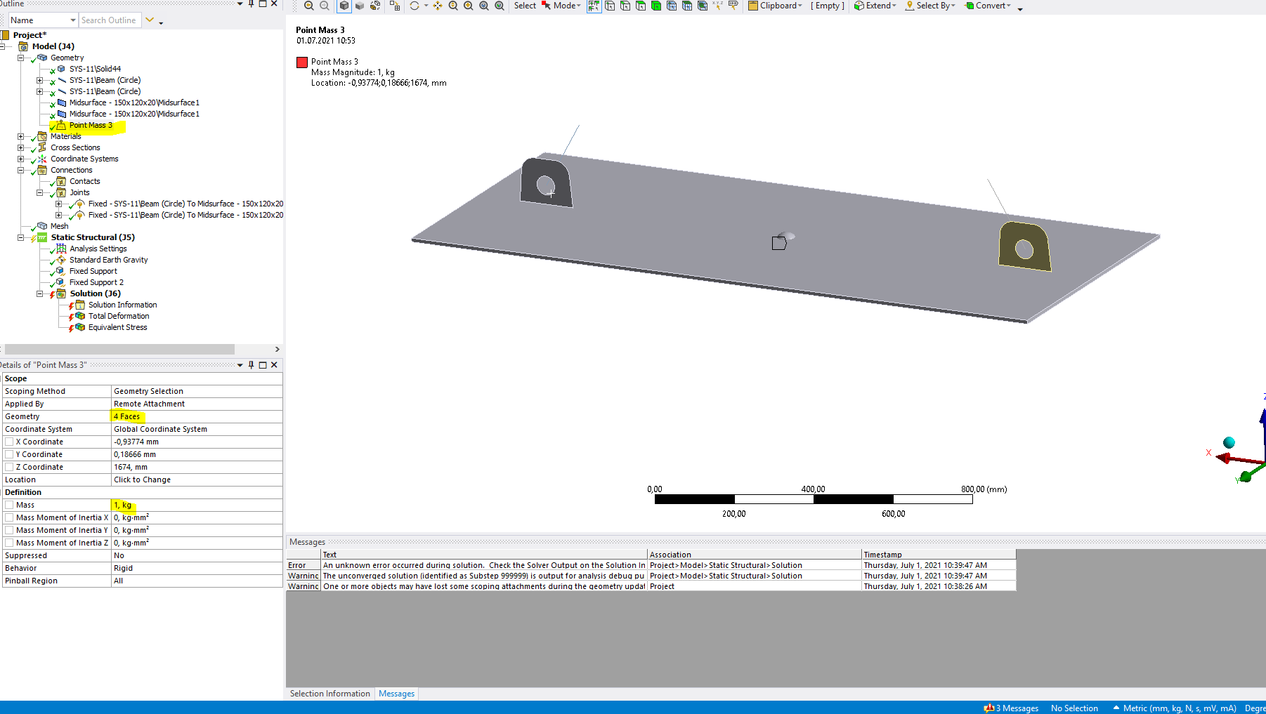

Also set the remote displ. behaviour to rigid, and also for the point mass.
Thanks
Erik

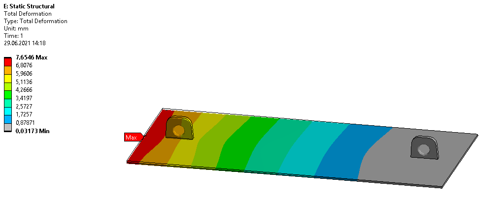

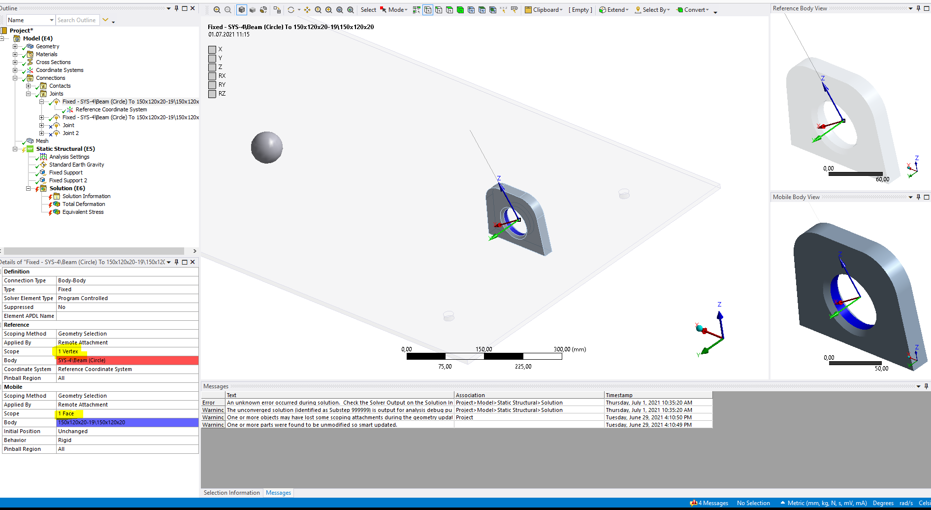

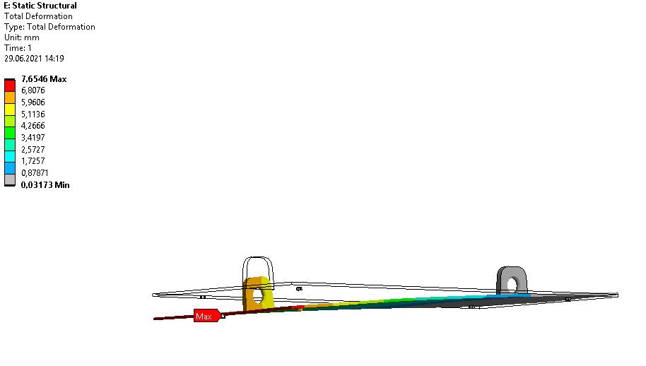

June 29, 2021 at 12:22 pmJune 29, 2021 at 1:35 pmerik.kostson
Ansys EmployeeHi
As we can see the left boundary condition (C in the image below) is not working, as that lug moves in the z direction so downwards.
So on one of the remote displacements (C in the image below) on this left lug is wrongly scoped. Make sure that remote displacement (C below) is scoped to the inside face of this left lug (lug that moves down), just as marked below.
Also for the point mass, scope as direct attachment, and to a node or introduce a vertex and scope it to that point/vertex.
Thank you
Erik
July 1, 2021 at 9:25 amvishal295
SubscriberHi Erik Thank you.
Exactly, as you mentioned in last comment remote displacement boundary condition at C was not correct (coordinates were not correct, surface was true).
Coordinates were different. I have selected the true surface. I don't know why coordinates were different but Now I have corrected it ! And after 1kg point mass with large deflection off, I got symmetric deformation as expected. And even after increasing the point mass to somewhat reality and with large deflection on, I got reasonable result deformation.
now I am getting symmetric deformation with this remote displacement at lifting lugs inside surface boundary condition.

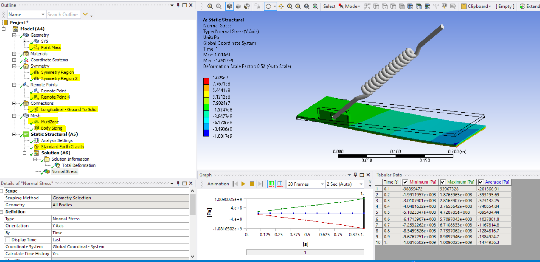

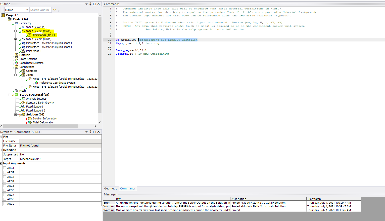

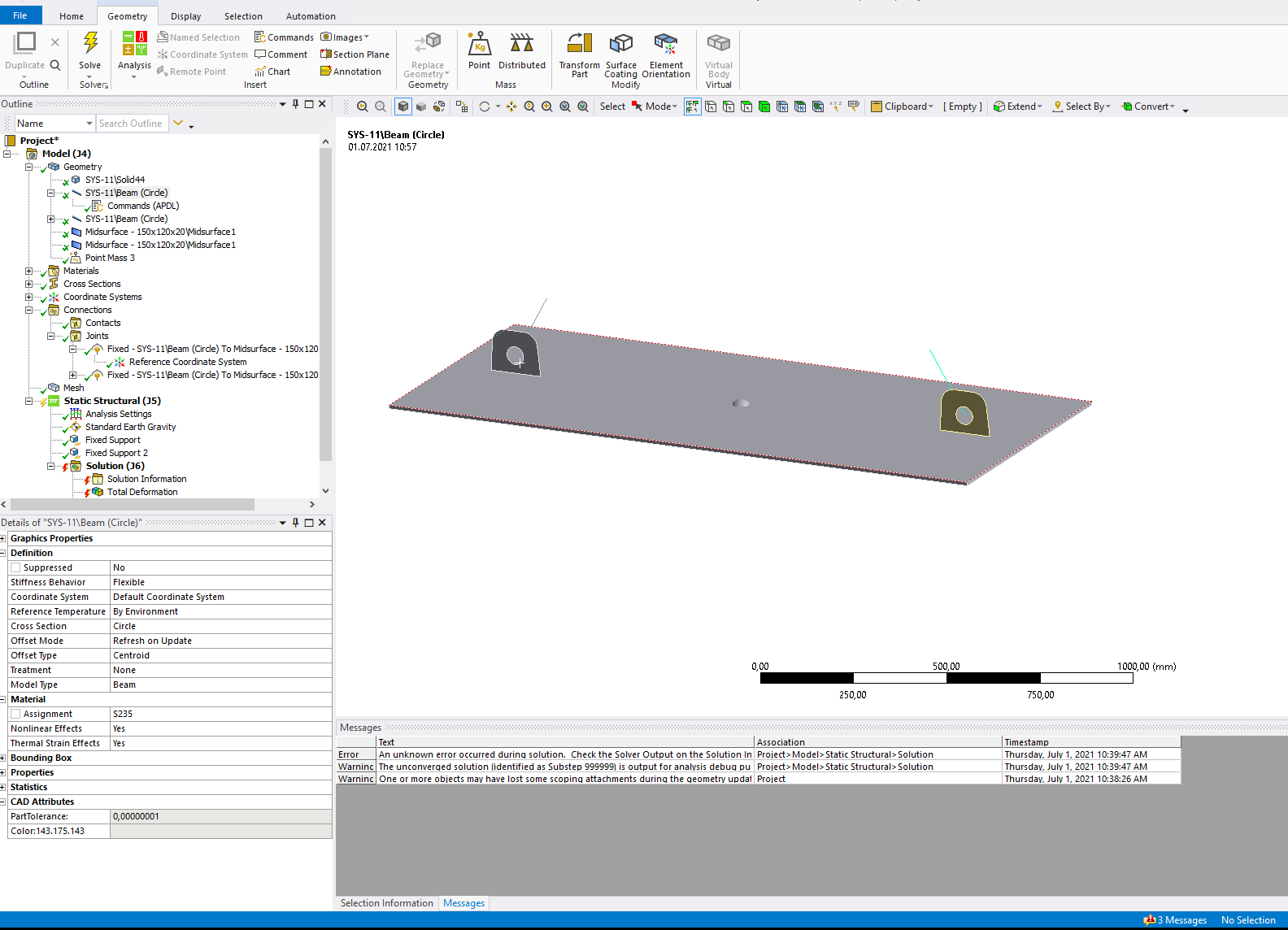

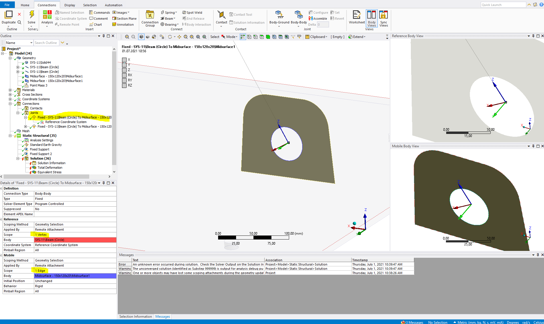

But when tried to use LINK180 to give more accurate boundary condition (like in picture) (because in reality is hanged by chain at some angle).
I have this settings as in attachment for LINK180. Is there any tutorial or video or discussion about this ?
I have created the rope/chain in spaceclaim. I applied Boundary condition as in attached pictures. I am getting some error. Can you please help me with this ???
Should I open new discussion for this or is it ok if I discuss here.
BR Vishal
July 1, 2021 at 9:26 amJuly 1, 2021 at 10:10 amerik.kostson
Ansys EmployeeHi
This is quite tricky - look on other posts and search to find some solution:
One search gave this:
Also I would use quarter symmetry (as shown below) and spring instead of link180 (they do the same thing here in this case - as shown below) to get balance and to get convergence since a full model on ropes/chains/slings is not stable.
