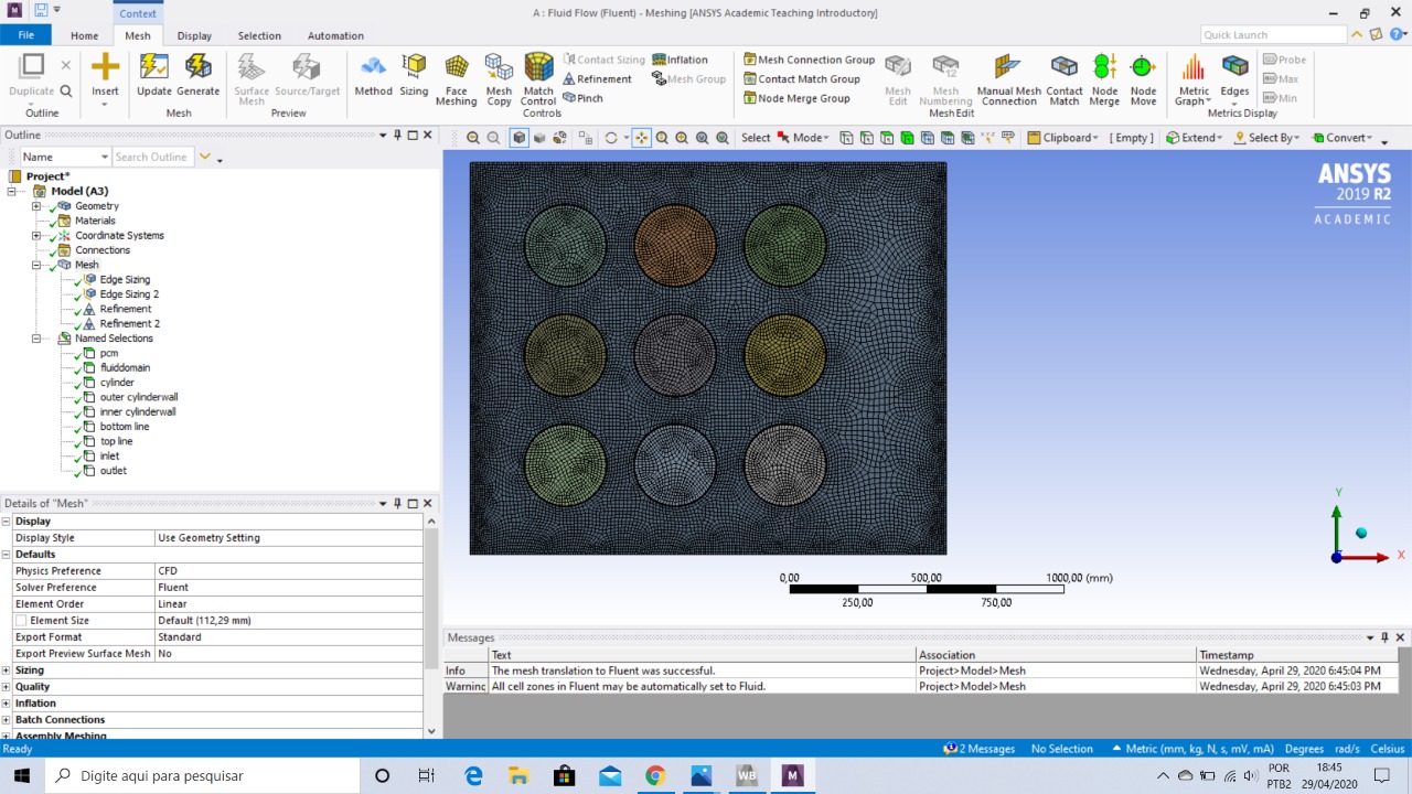

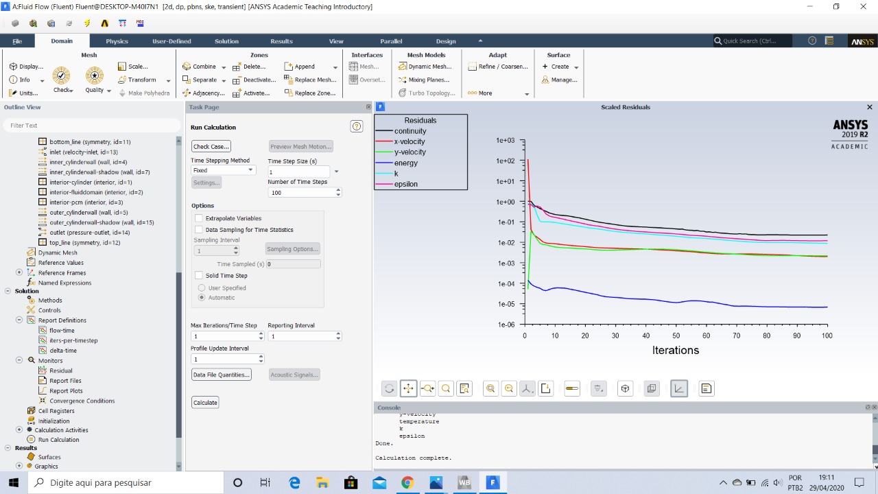

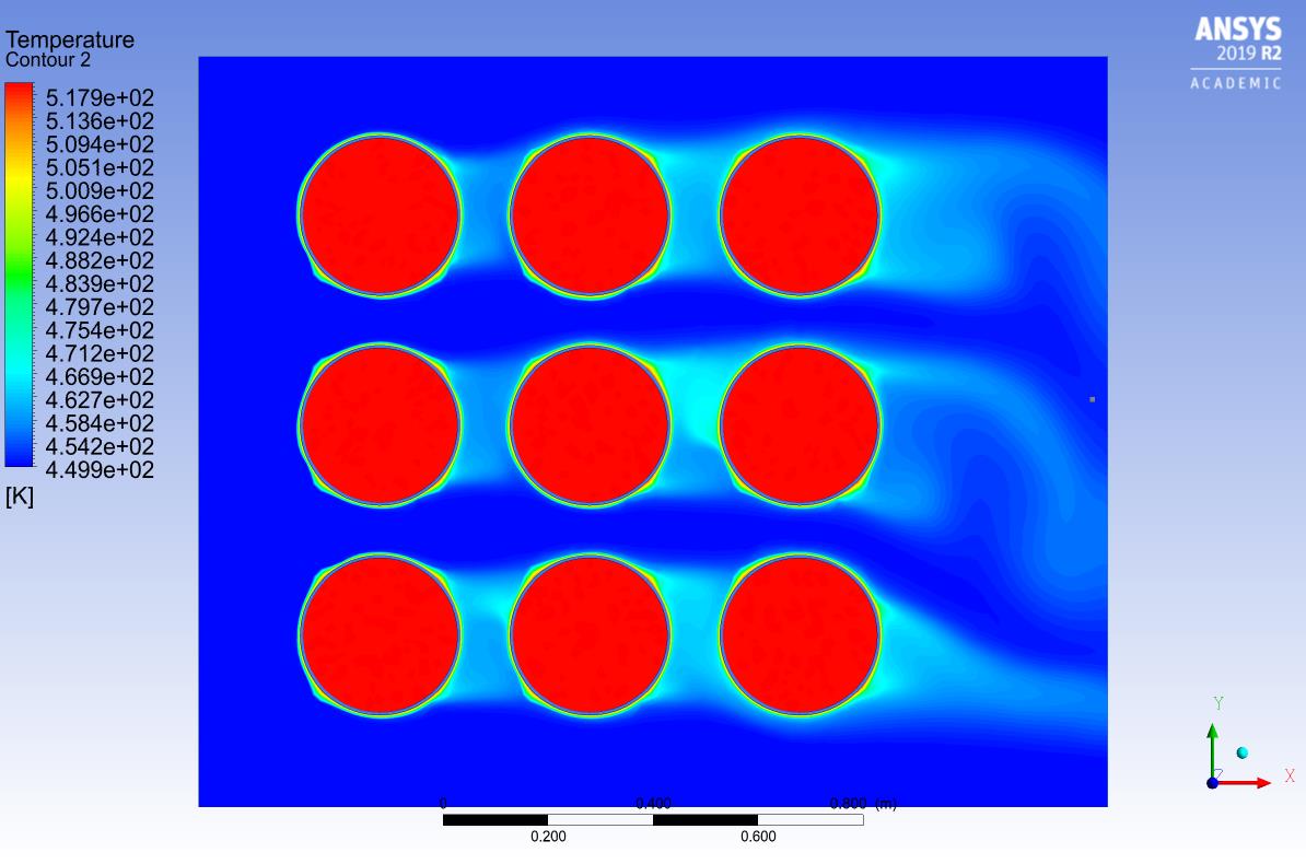

Subscriber   Hello! I'm trying to analyse the average temperature of the air in the outlet of 9 cylinders tubes filled with a phase change material (PCM) on it's melting temperature.
I'm considering a transient k-epsilon (enhanced wall treatment) with solidification/melting mode on. The conditions are:Â
Air Inlet:Â 8m/s and 450 K
PCM (T solidus = 494K and T liquidus = 511 K): 520 KÂ
Steel Cylinder: 520 K
The problem is that my results seem incorrects! I don't know how to set my model to see a decreasing of the PCM temperature (and liquid phase) ir order to increase the outlet gas temperature. Can someone help me? Thanks!! Â

Forum ModeratorIf you set a value that's what Fluent will use throughout the calculation. What you need to do is Patch the PCM temperature: it's done just after you initialise the model. Also, think carefully about your initial conditions as they influence the transient solution.Â
