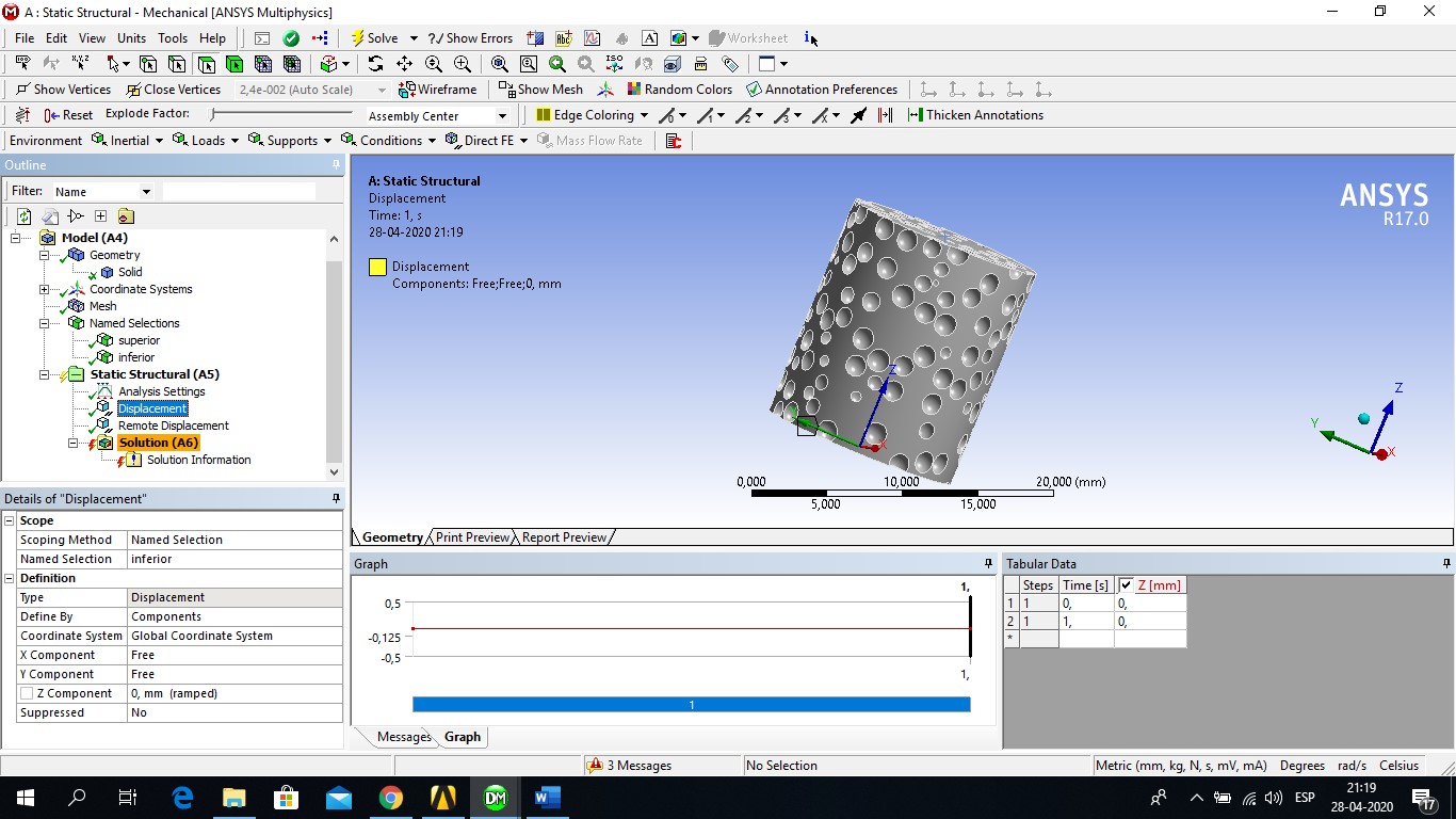

      Hello, I am simulating a compression test on metal foams. For edge conditions, I am replicating an undergraduate thesis where they consider the following:
      At Z = 0, an displacement 0 in z

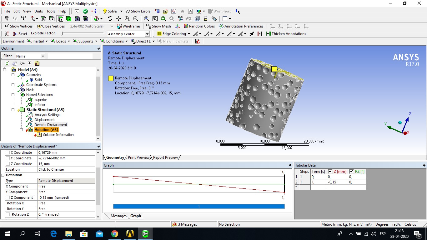

      At Z = H, a remote displacement where, to simulate the compression test, I add a deformation of 1% of the initial length and restrict the rotation in Z.
      The problem is that the simulation throws me the following errors

      Based on the boundary conditions that you have described, it looks like rigid body translation in x and y directions can occur. There are no boundary conditions to prevent that. Can you fix one point (may be the center of the base z=0) in x and y-directions?

      I tried applying displacement 0 in xy and z and above a remote displacement and restricted both rotation and displacement in the axes except Z. The problem is that the results are far from what I should get, supposedly the results were obtained with the conditions I mentioned higher but it doesn't work

      Could you describe your new boundary conditions again? I am not sure I understand them clearly. Also, is there a reason you chose to apply Remote Displacement on the top surface instead of Displacement boundary condition?
