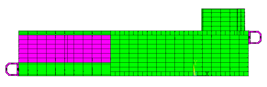

      Hi Again,nThanks for the response, I did what you said, and here is the close example of what I did, my final goal is to find a natural frequency of the this segment ( which is close to this one), and for the real experiment, we have to suspend the structure with crane to simulate free-free boundary condition, but since it is heavy , due to safety reasons, we can't so, we need to put it in 4 (set of springs) to simulate free-free boundary condition ( meaning put it on very soft place) , and then with a shaker and accelerometer find natural frequency(Modal part in ANSYS) and FRF function (Harmonic Response in Ansys), ( displacement 1 to 4 is for No movement in X and Y direction for edges in four corners)nso here as you can see the first 6 modes are translation and rotation modes, which we can ignore, but do you think, this is a right set up for the whole experiment to find natural frequency of the segment and FRF function?nThe reason that I am asking for, is because for the 7 mode, it just shows the segment goes up and down on spring like because it's own weight and almost no shaking or vibration is shown, but my goal is to let it go to the equilibrium point and then use shaker or impact hammer, and for the 8 to 10 modes shapes it doesn't show any movement at all.nThank you so much, I really appreciate your help n
      nThat looks like a reasonable Free-Free model and it is correct that the first nonzero frequency mode is the mass pumping against the springs. You can calculate that frequency by hand since you know the mass and the spring rate using f = sqrt(k/m)/2pi.nIn a Modal analysis, there are no loads, so you don't have gravity deflecting the springs to a static offset, but in a Static analysis you do.nIn a physical experiment, the first six modes in the analysis won't be measured. Mode 7 in the analysis will be the first mode that can be measure by an accelerometer.n
    • omidrastkhiz
      nI have been working on the model, and It seems it has almost the same natural frequency(NF) as I get from formulation as you said, which is for the third NF, and the seventh NF is start point for model and experiment to have compatible results, ( in case of only having spring in Y direction and no constraint in Z and X, which means I removed no displacement constraint), although I don't know why are the first six natural frequencies a nonzero result? nThose are 0 - 0 - 2.4 - 13.8 - 27.6 - 32.5(Hz) and the mass of the segment is 4250 and I used 4 spring with 252000 stiffness for each (in the formulation it should 4*K), and formulation result is 2.4 Hz.ndo you know what could be the explanation for these 6 nonzero results?nand do you know any book or any document for the explanation of mode shapes, which can help me to have a better understanding of the dynamic behavior results, like which one could be right and which one could be wrong.nThe 7th one starts from 57 Hz.n
      nWhen there are no springs to ground, the first six modes are the rigid body modes and the frequency would all be basically zero. Once you add four springs in the Z direction, you get one nonzero translation frequency in the Z direction and three nonzero rotational rigid body modes. You can see the part rotating. Mode 7 is the first bending mode of the segment.nRight or WrongnAll the nonzero modes in the model can be measured in an experiment with accelerometers. It is not a matter of right or wrong, it is a matter of accuracy. For example, the 2.4 Hz you calculated using the effective spring rate and mass might be measured in an experiment as 2.5 Hz. That means either the mass or the spring rate in the model needs to change. Given how easy it is to weigh the part, it is likely that the mass input to the model is correct, and the spring rate has to change. Once you look at mode 7, if that is off, then the stiffness of the part has to change, such as a wall thickness.nn
