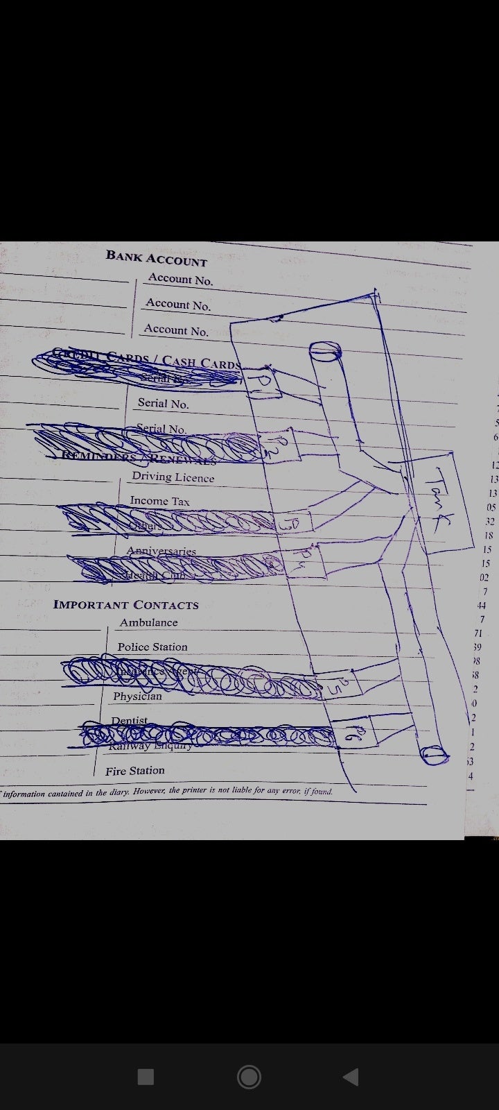

I have 4 pipes coming from sea (source tank) and these 4 pipes are taking water from sea with help of water pump(p1, p2, p3, p4) and put it to tank, which is in vertical height of say 6 meter from sea. I want know
Effective combined pump flow rate for this combination of piping system & parallel pump
Also flow rate at tank individually by pipes also

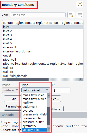

Forum ModeratorYou will know something, that may be the flow rate OUT of the system, no reason not to use a suction (negative velocity) boundary. If the flow is constant density use velocity bc, it's more stable and only takes a minute or so to work out.

SubscriberThere are many types of boundary conditions used in ANSYS like velocity inlet and outflow, pressure inlet and pressure outlet, mass flow rate, inlet vent, intake fan, outlet vent, and exhaust fan.
The most used boundary conditions are velocity inlet and outflow, pressure inlet and pressure outlet, mass flow rate. Here we show some basics of these boundary conditions.
From your question....
Mass flow inlet-outlet boundary conditions
Mass flow inlet boundary conditions are used incompressible flows when the inlet mass flow rate is known. It is not necessary to use mass flow inlet boundary conditions for incompressible flows because density is constant for incompressible flows and velocity inlet boundary conditions will fix the mass flow.
For analysis of mass flow rate at the outlet,Mass flow outlet boundary conditions is used.
You can refer to this article regarding different types of boundary conditions and where they can apply https://www.cadsys25.com/2020/06/cell-zone-and-boundary-conditions.html
December 7, 2021 at 11:48 amRob
Forum Moderatorthanks for the post. As a slight correction, outflow isn't widely used any more. It's an old boundary setting that is superseded by pressure outlet: I think I last used it in FLUENT v4 in the early 00s.
