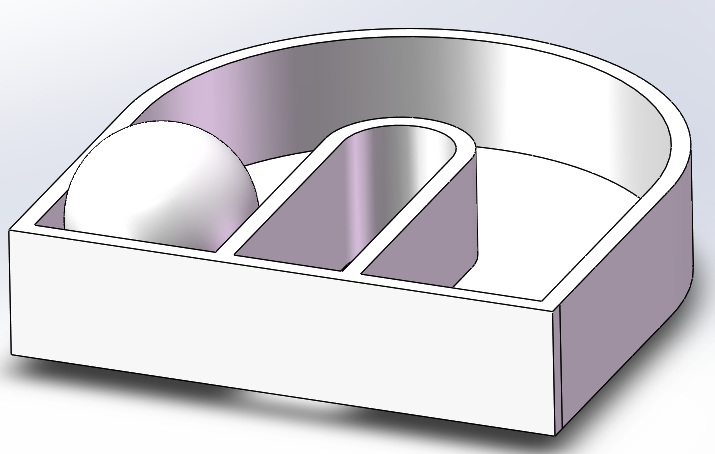

I have now tried the instructions you kindly sent and the attached is the outcome.
Attachments are as follow:
Workbench files: Bouncing ball - Community copy v2
Drawing for the main idea: object in the tube.png
Regarding the simulation, basically this is part of a bigger idea I am exploring. In the main idea, there is a pipe (bent) with some angles in which fluid is being injected from its inlet and is coming out from the outlet. Then a small object is being released close to the inlet and I am hoping to see the movement of the object due to the fluid and its gravitational force.
Regarding the time step, I have now tried changing the contact to frictionless, update the fixed surfaces and modify the timing. For the timing thought initially focusing on the step one out of three steps. (step1: falling before contact, step 2: contact and step 3: after contact). To keep it simple for now, I focused on the initial 0.0031s before contact.
But, still making all these changes, nothing happened. could you please help me on what I am not doing write?
as soon as this starts working, I will work on modifying the system by going to the 3 steps, then reducing the size etc etc.
