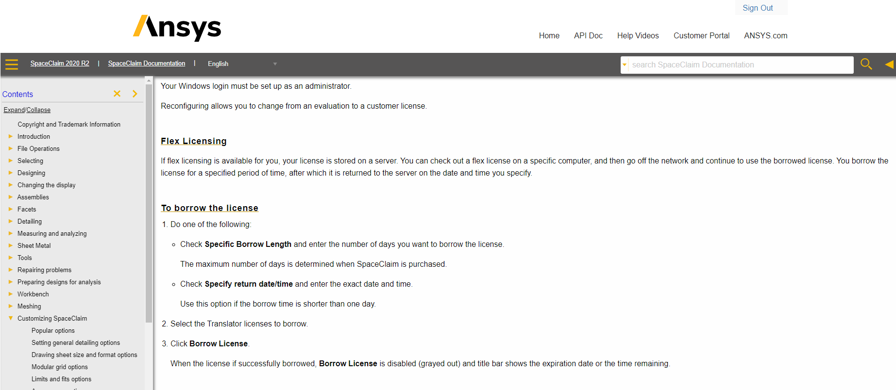

Forum ModeratorHello GUICAD I'm not aware of the procedure as mentioned in the SpaceClaim Documentation I will need to check with the Documentation team on this. Although, please use the below procedure to borrow licenses.- Kindly check the ANSYS license file; to be able to borrow a license the INCREMENT line for that license must include the word BORROW. for example: INCREMENT ane3fl ansyslmd 9999.9999 12-jan-2011 10 0E0E37E05A3C VENDOR_STRING=customer:0000000 SUPERSEDE ISSUED=12-jan-2010 BORROW=720 START=12-jan-2010
- Kindly find attached the details of borrowing the licenses.

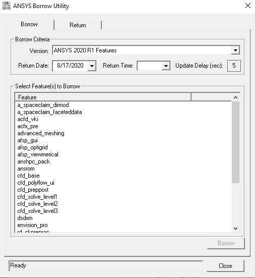

Launch the Client ANSLIC_ADMIN Utility 2020 R2 from the Start menu under Ansys 2020 R2.
Select the "Run the Ansys Borrow utility"
Borrow utility looks like this, kindly select the Return Date and Time carefully.
