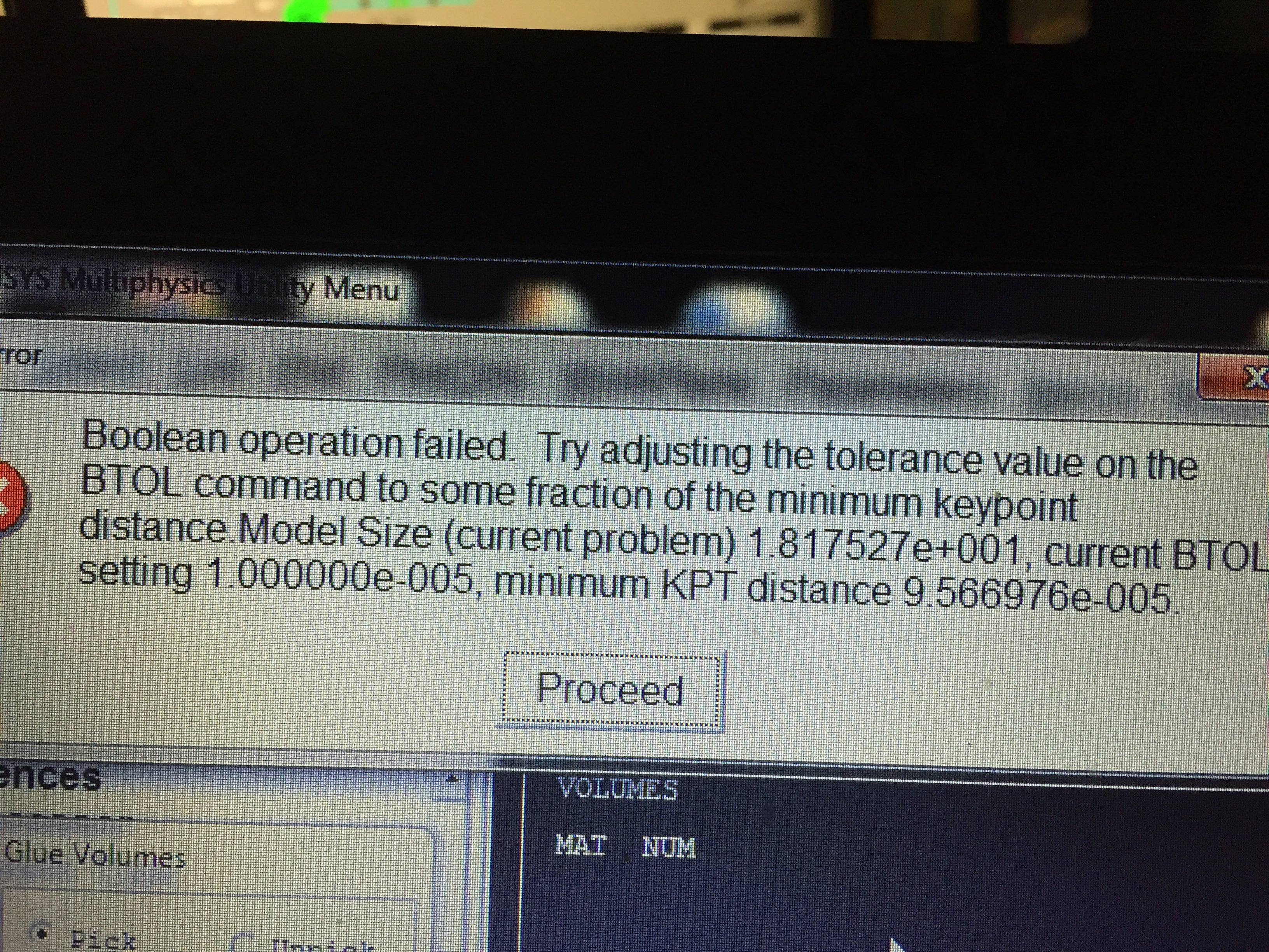

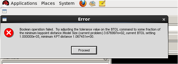

SubscriberDoes anyone know how to get around this error message?
August 29, 2021 at 5:03 pmMsayed
SubscriberI have same problem.please if you have answer about that problem inform me. thanks
August 30, 2021 at 3:36 pmAniket Chavan
Forum ModeratorCheck the default value of tolerance for boolean operations through BTOL, STAT command.
Provide a tolerance value about 1/20th to 1/10th of the minimum KPT distance using the BTOL command.
-Aniket
September 3, 2021 at 11:26 pmSeptember 3, 2021 at 11:28 pmMsayed
Subscriberand also build the model with less scale but the problem is still on. please if you have a solution inform me with steps.
thanks
September 6, 2021 at 10:40 amAniket Chavan
Forum Moderatorminimum kpt distance is 9.5e-5, so the BTOL value should be maximum 9.5e-6, or preferably: 4.75e-6.
current BTOL seems larger than that. Please setup properly using BTOL command, more info:
https://ansyshelp.ansys.com/account/Secured?returnurl=/Views/Secured/corp/v212/en/ans_cmd/Hlp_C_BTOL.html
-Aniket
