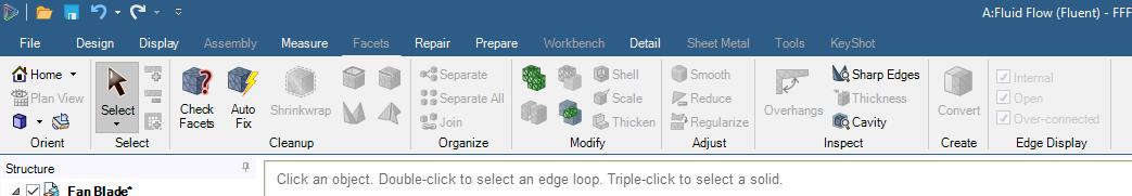

      I want to follow this youtube tutorial:
      The only issue is that I cannot find the Boolean feature in Ansys 19.0. Can someone help me? What should I do?

    • monicaagabriela
      I cannot find it. Please see the picture attached.
    • monicaagabriela
      I haven't got any "create" in my toolbar.
    • Keyur Kanade
      This is SpaceClaim.
      In this, you can use Combine tool under Design tab.
      Keyur
