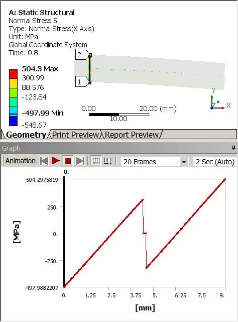

If you have the right material properties, you can produce the stress distribution shown for the Laminated configuration using shared topology. In the model below, I have a 3 layer sandwich, with a top 4.4 mm layer, a middle 0.2 mm layer and a bottom 4.4 mm layer for a total 9 mm thick sandwich. The middle layer has an orthotropic material property with low shear stiffness. I created a path through the thickness to plot the Normal X Stress. The graph looks like the Laminated configuration stress distribution you show above.
Here is the middle material:
I added a Coordinate system where Z pointed in the Global Y direction to use this material.
However, an orthotropic elastic material might not represent what is in your laminated glass. After the glass has been bent around the form and left for some time (maybe at an elevated temperature) and the glass is released from the form, does it stay curved or does is spring back to flat? If it stays curved, you may want to model the laminate as a viscoelastic material and the two panes will, over time, slide relative to one another.

Subscriberbsista, I like the idea of using the stiffness of the bonded contact to provide the shear flexibility of a two-layer model.
In my post above, I used a thin solid sandwiched between two glass layers, but I joined them with shared topology, not bonded contact. The stress profile matched the laminated scenario B.

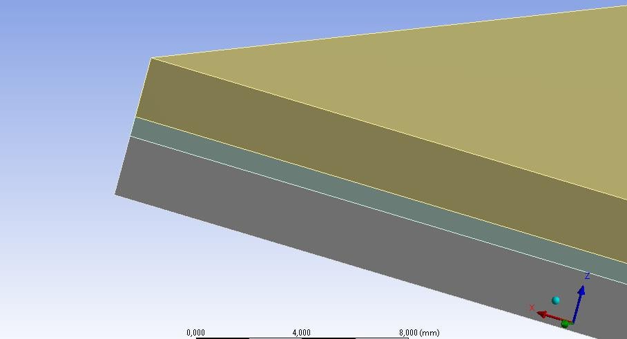

An isotropic material defined the interlayer should also give the graph shown in your picture. And to mention also your last part of the answer, I define the interlayer material as viscoelastic (in which the shear modulus will decrease with time). The Normal stress x graph, can be as "c" (my picture at previous comment) in earlier stage of loadings (since the shear mod is high), but after some time it should start to look like "b". But it doesn't in my case, even though I request the result after ~1year when Shear modulus is around 1-2 MPa.
I was doing some attempts trying Shared Topology: When I increase the thickness of the panes and interlayer [Fig 1], or when I increase the dimension in x, the behavior starts to look like "b".
Now one might think that since it works with higher thickness, the results when thickness is low is also correct. But exp results show a behavior as "b"
That made me think that I lack the necessary skills in ansys to implement something that captures the results at this position
I also tried to add more elements throughout the thickness and even tried to change the elements to SOLSH190 but no improvements observed.
