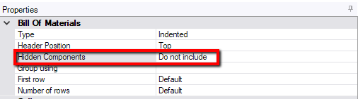

      1) When creating a BOM table it is not possible to delete a row is it a BUG?
      It is a limitation because it is not possible to modify the table

      Hi Roberto
      'Delete row' allows you to delete only empty/manually added rows.
      If you would like to remove any of the components from your BoM, you can hide the component in your structure tree and then, in the BoM properties, you can toggle 'Hidden Components' to 'Do not include'. (refer image).
      This option will eliminate the components hidden in your Structure tree, from the BoM.
