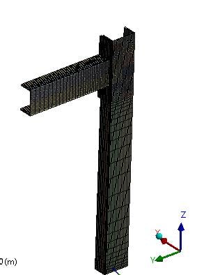

      Yes, it happened as I was expecting. I did not use slice, but form the part, and use base face split with mesh control.
      The results are the same, I have a peak of stress, and I do not know why. In the Eurocode this connection has Mrd = 100kNm.
      With the model Mrd is under 30kNm. There is something wrong in the model. I think that it is impossible to be the weld. As you see, the results are completely different from your model. Really, I don't know where is the problem with the model. If I take the element results, ts the picture below:
      If I take probe, in the node of the element before, the results are in the picture below. As you, see, completely different, nearer of the reality, but not reliable.
      Just a moment, I will attach the model which is solved.

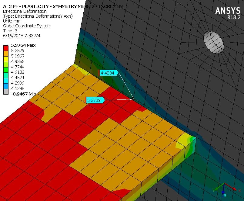

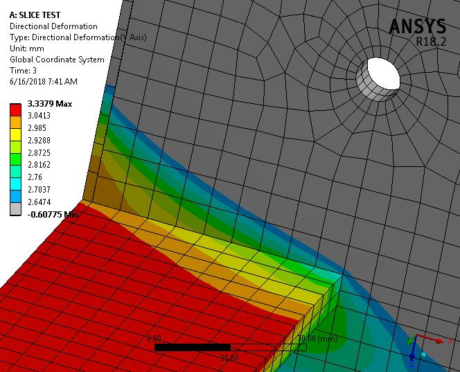

      There is something wrong with your model.
      Add a Directional Deformation for the weldment part in the Y axis and zoom in to the connection between the beam and the plate. The deformations should be continuous across the corner. Instead there is a 0.7875 mm gap opened up under this load.
      Your beam mesh is only connected at 4 nodes, not along the entire edge.
      I created a 2-element thick model, and when I do the same check on that as I describe above, it reveals an unconnected thin strip along the back edge, though there is a good connection of the beam to the plate.
      The corrective action is to loosen the node merge tolerance and/or add mesh edge controls so that coincident edges have the same number of nodes along them.
      I changed the Mesh Edit Node Merge group to a 0.5 mm tolerance and said yes to Face to Edge and Edge to Edge. Now 368 nodes were merged.
      Here is the new Y directional deformation plot. It appears that there is no longer a "crack" in the mesh.
      See this discussion for the question of how to find out about unintended "cracks" before solving.

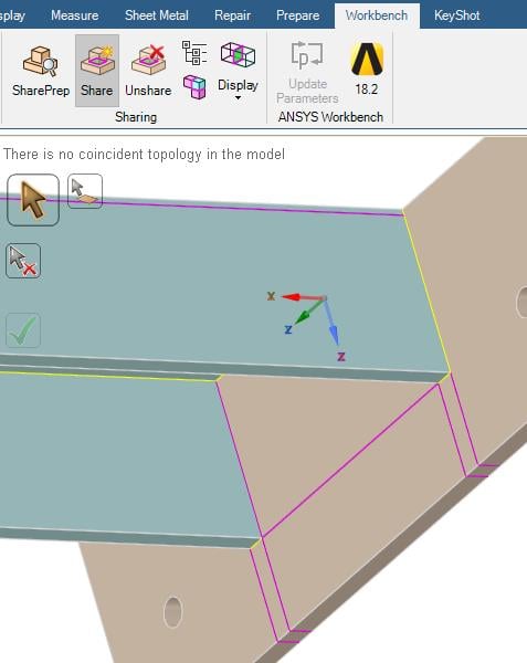

      I took the geometry into SpaceClaim and cleaned up all the faces, then made fresh sliced on the weldment and finally used Workbench Share to get the weldment to mesh properly.
      When I get a mesh that works, I plan to plot the force vs displacement curve.
      Peter

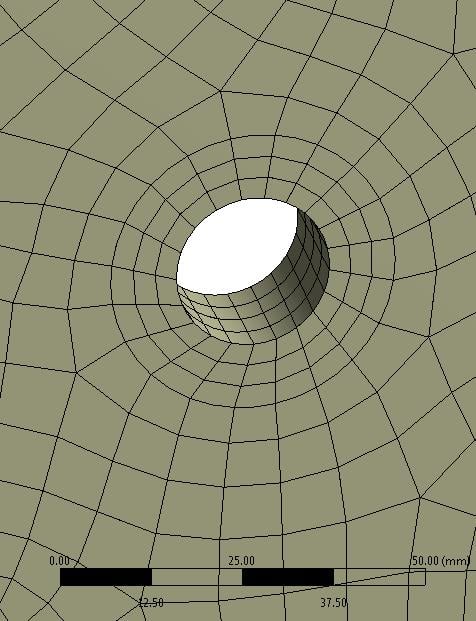

      To get a good mesh around the holes, I imprinted two circles and used Face Meshing to put 3 elements across the width.
      This model is solving now...
      NOTE: I changed all the materials, so change them back before you use this model!

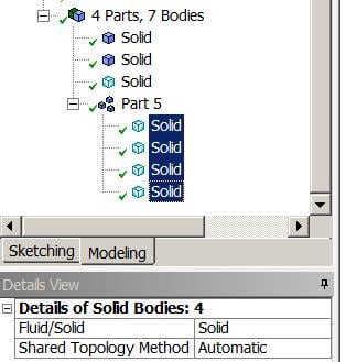

      I found a reason why meshing from the earlier DesignModeler geometry was failing to create congruent meshes.
      The part shows Shared Topology Method is set to Automatic, which is correct but...
      n
      ... the individual bodies had the Shared Topology Method set to None, which defeats the Part level setting.
      All bodies in the Part must be set to Automatic.

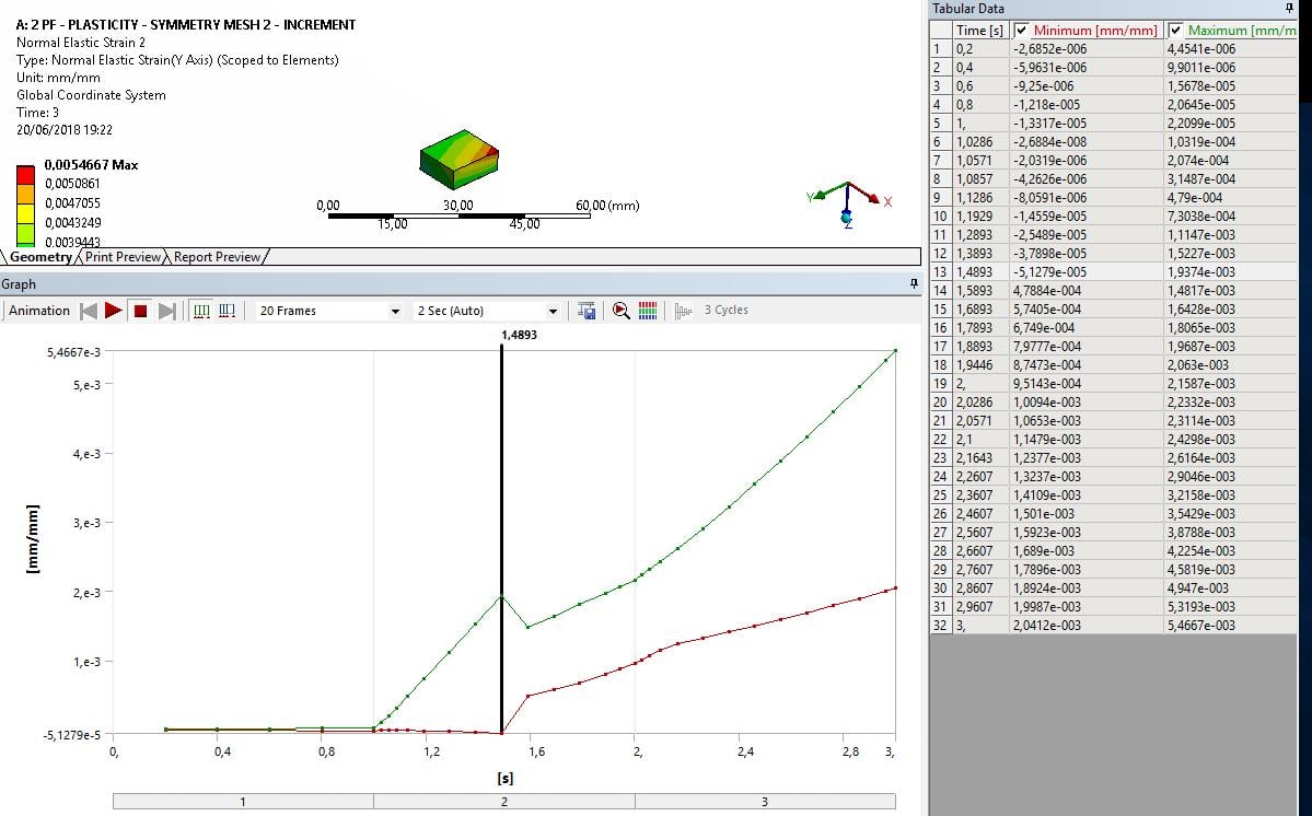

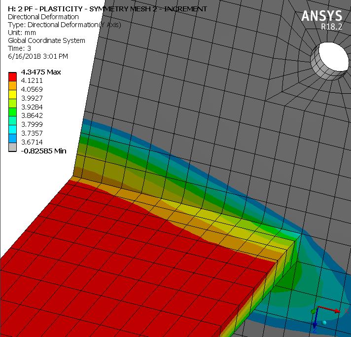

      PEAK STRESS AT ONE POINT
      In the image below, the peak stress is at a point. That is expected. A thin member is pulling away from a thick plate and the interior corner is dead sharp. That creates a stress singularity.
      If these materials were elastic, as the element size was reduced, the peak stress would increase without limit.
      Fortunately, plasticity has been added to the material model, so the stress is limited by the material model.
      If we look at just that one element in the corner and look at an earlier time with less load. Here is the picture:
      Note that the yield strength for this material is 345 MPa and the yellow boundary is about to reach an integration point on this element.  Now let's look at the stress-time history.
      The stress went down after this point. How can that be correct?
      Look at the plastic strain on that element. After this point, plastic strain begins.
      There is nothing wrong with this model. At the next load increment, this element goes plastic, and reduces stress and the surrounding elements that had lower stress at this time and are still elastic, pick up a little more stress to carry the next load increment, while this corner element sheds some load due to the change to plastic behavior.

      Peter, my strain graph is different of yours. Look at my graph:
      Your graph is similar to the minimum strain graph. The maximum you have the same peak. I solved the elastic model minutes ago and saw that in this point the beam reach the plasticity.
      But I did not understand why our graphs are different.

      The plasticity material means you can plot three values of strain: Total, Plastic and Elastic where
             Total = Plastic + Elastic
      You have plotted Elastic and I plotted Plastic.

      Now I understood. I think that I will try to model the column in place of the rigid plate now.
      Thank you for your help!!!
      You did a great job on the mesh so far, I'm sure you can whip the column into shape.
      You also know more about keeping the Shared Topology working now.
    • Fabricio.Urquhart

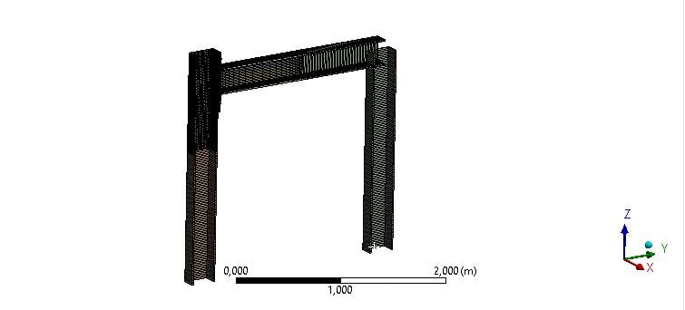

      Thank you Peter!!I I reachef an excelent mesh. Now I am modelling a portic, I am studying how to create join between cross section and solid model.

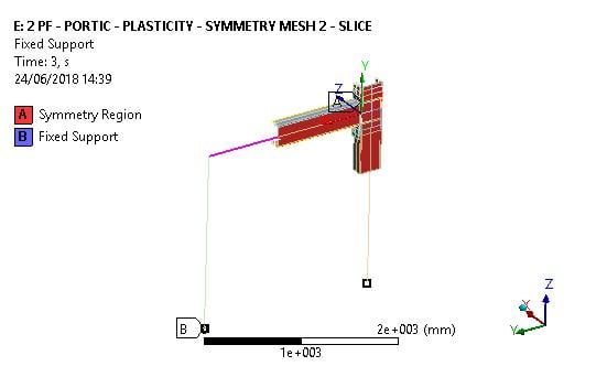

      Can you help me, explaning how I use line body orientation?Because element orientation is used to solid or shell bodies. So for line bodies I do not know how I change the orientation. Now I will try to change in the geometry. But is it possible to change in the model?
      I think you have to specify beam section alignment in DesignModeler. You can specify it in Mechanical is it is a geometry operation.
    • Fabricio.Urquhart
      Ok. I understood. And the symmetry that I have applied, is it OK for the line bodies?
      Another question, is about the load, I will add a load along the beam, and along the beam modelled by solids. So I have two points:
      1 - The local buckling that will occure in the beam solid, or with the symmetry, the load is applied along the center line?
      2 - Do I have to divide the load for two beacuse the symmetry, yes?
      Thank you Peter!!
      Loads applied to a model using symmetry must be cut in half if the symmetry plane is cutting the face the load is applied to is cut in half.
      When a beam is perpendicular to a plane of symmetry, that I understand is valid. I am unsure about using a beam that lies in the plane of symmetry. What happens to the cross-sectional area of the beam?  Is it automatically handled or do you have to manually alter the beam cross-section for beams that lie in the plane of symmetry?  I can't say for certain without some research.  You could build a small model to see what happens if you are interested.
      If you are interested in local buckling in an I-beam, don't use beam elements.  Beam elements have a fixed cross-section that cannot have local buckling of one flange in a local area.  If you model an I-beam with shell elements, then the shell elements can buckle out of the plane of the flange.

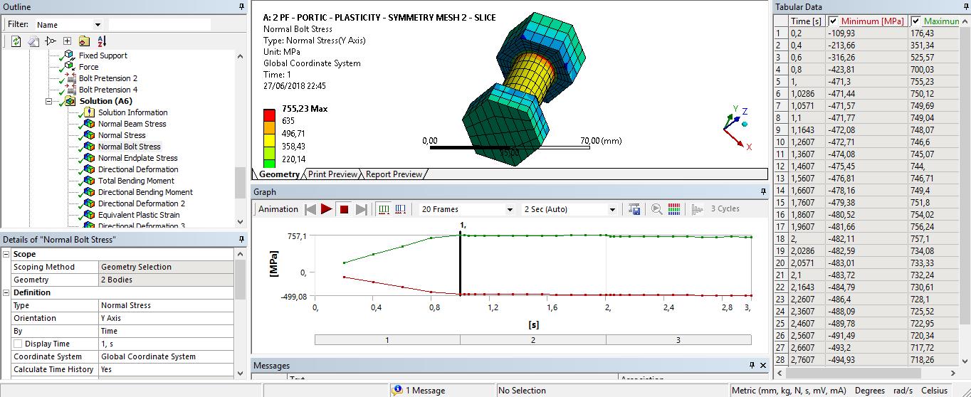

      Peter, I am studying the problem that is hapenning with de bolts. Do you have any article or post that talk about modelling bolts in Ansys?
      Because I think, that applying pretension and using plasticity it will be ok.
      Thank you!
    • Fabricio.Urquhart
      Using boolean in the bolts, this peak of stress disappear. See the picture below:
      Thank you Peter!!
      I am learning a lot with you!!!
      The reason is Average Across Bodies is set to No by default.

      When I compare the moment in the connection ( Moment reaction plus Horizontal Y Force Reaction multiplied for 2m, that is the column height) with the rotation (beam rotation minus column rotation, extremely near of the connection), have I to multiply for two, becasue the symmetry?I think that it is not necessary if I am comparing with the full solid, is it?
      You should have cut the load in half when you cut away half the model. Did you do that? In any case, the load you applied is used to compute the moment and plot that against the rotation.
      If the problem specification says to analyze a beam that supports 40 kN/m and you choose to cut the model in half and apply 20 kN/m, you will get the same rotation as if you had not cut the model in half and applied 40 kN/m.
      What matters is how you label your Moment axis in the graph, you could label it: Half moment on half model.  Then you would show the 20 kN/m moment.
      Or you could label it Moment and you would double the 20 kN/m and show the moment for 40 kN/m even though you used 20 kN/m in the half model.
      The point is to be clear what you are plotting.
