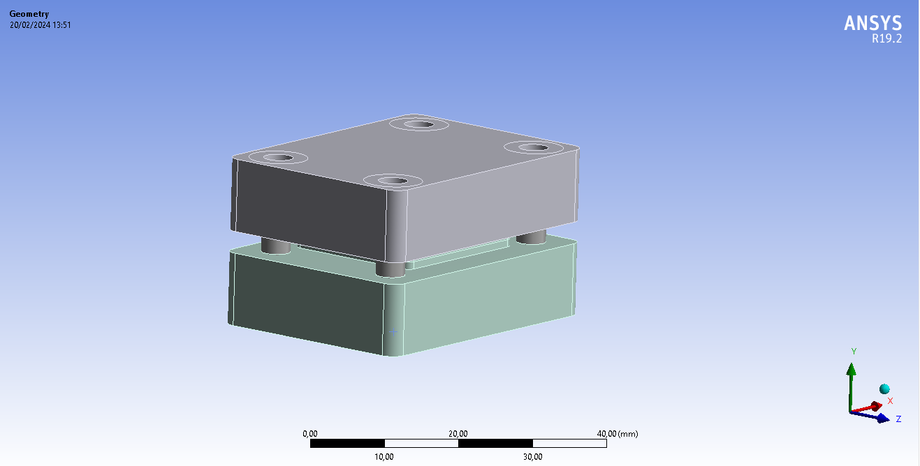

      Hello everyone,

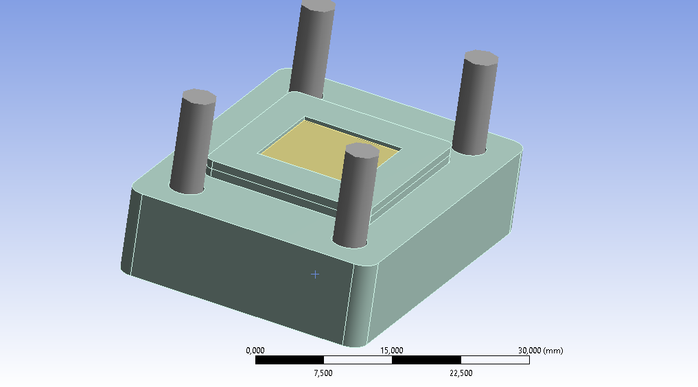

      I am trying modelling compression of a gasket between two plates caused by bolt pretensions. The assembly consist of two external plates bounded by four bolts (simplified modelling by beam connections), between them there are a gasket and a layer which is thinner than the gasket. The objective is compress the assembly to the gasket's thickness will be equal than the layer's thickness.
      I can not run the simulation because an error message comes up ("The L-2 norm of the residual force overflowed. This may be caused by PRED,ON or birth/dead elements. Please use PRED,OFF and try again.")
      I have tried changed the mesh, the contacts, enter the command "PRED,OFF", adjustment... I don't know what to do to solve the problem.
      I'd really appreciate any help.
      Best regards.

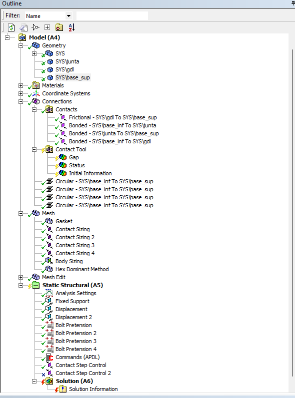

      thanks for your advice. I've tried reducing the normal stiffness (factor = 0,1) and changing the damping factor (value = 1). Unfortunately, it hasn't worked for me. I think that the problem is caused by the gasket because if I supress the body "junta" (which is the gasket one), I manage to solve it. However, if I supress the body "gdl" and I try to solve it with the gasket, the same error message comes up ("The L-2 norm of the residual force overflowed. This may be caused by PRED,ON or birth/dead elements. Please use PRED,OFF and try again."). I don't understand this error, is it a convergence issue caused by contact definitions?

      Did you mesh the gasket body with SOLSH190 elements? There is a special workflow that requires that the gasket body has exactly one element through the thickness. You need to use a Mesh Method of Sweep.  More details are in this discussion.

      now I'm trying to solve it with SOLSH190 elements, thanks for the recommendation. I thought that I had to use INTER195 elements for the gasket. I have a question about the Contact Step Control that I have defined for the contact between gdl and base_sup (top plate): at the beginning of the simulation the contact is near open (there is a initial gap) and lastly this gap will disappear due to the bolt pretensions, but I have to define the contact alive or dead in the contact step control?
