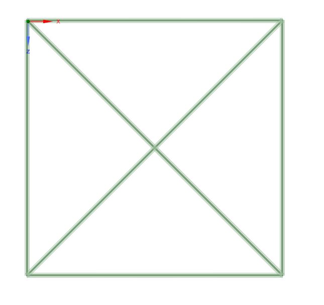

      I created a truss composed of cables and link/truss elements that take compression only. then i tried to apply a bolt pretension to my cables. however i get the following error:

      What is your geometry, just line bodies?  Can you post an image?
    • sam45
      Yes - circular cross section beams which i then defined as cables or link/truss elements in mechanical

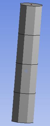

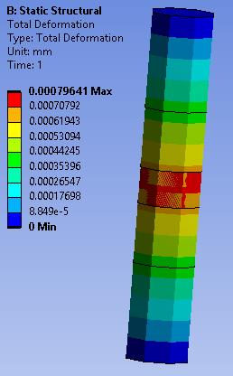

      If there is only one element along the beam length, then the solver cannot apply a Bolt Pretension load. It needs nodes between the ends of the beam to use in the Bolt Pretension method.
      Here is the deformation after a Bolt Pretension has be applied, the mesh is shown on the right.
