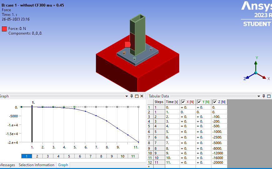

A concrete block with dimensions 400mm*400mm*150mm is the base. On top of this concrete block, a steel flange of thickness 20mm is placed. A rectangular pipe is placed on top of the steel flange. The steel flange is attached to concrete block using M12 Anchor screws. 20kN force is applied on patch surface of the rectangular pipe. The displacement of a point on the rectangular pipe at distance of 110mm from the steel flange is to be validated against the experiments.Contacts:

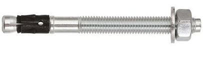

4. Below is the image of anchor screw. The length of shank inside the concrete is 80mm. In real time, only the black part is in contact. So the surface of screw shank and the hole in concrete were split and the bottom 10mm was assigned as bonded contact (i.e., a simplified model)
5. Remaining screw shank inside the concrete block (70mm) can be assumed as frictionless contact or frictional contact with small friction coefficient of 0.1.

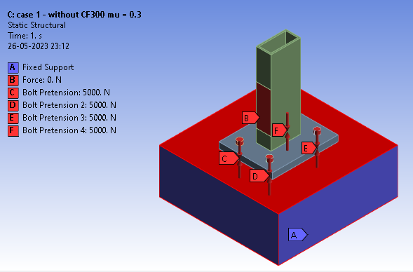

6. Bonded contact between steel flange and rectangular pipe.Boundary conditions:
1. Bottom surface and sides of concrete block are fixed support
2. A ramped load of 20kN force is applied in 11 steps on a surface as shown in the picture.

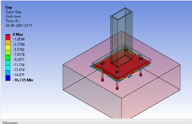

3. Bolt pretension of 5kN on each bolt during first step and stays locked for all further stepsLike you mentioned, I am already using the contact tool. The gap in contact tool show gap between concrete and the steel flange. But I see that this originates from the mesh in the contact region but not directly from the geometry itself. Here is the picture.
I just ignored it proceeded further. The convergence was not reached and the newton raphson residuals showed some problems in the contact regions. So instead of modelling the contact between screw shank and concrete (point number 5 in the contacts list) I suppressed the contact and run the simulation. If I understand correctly, I am just not modelling the contact (assumption in point number 5). All other contact settings that you suggested were left default.
