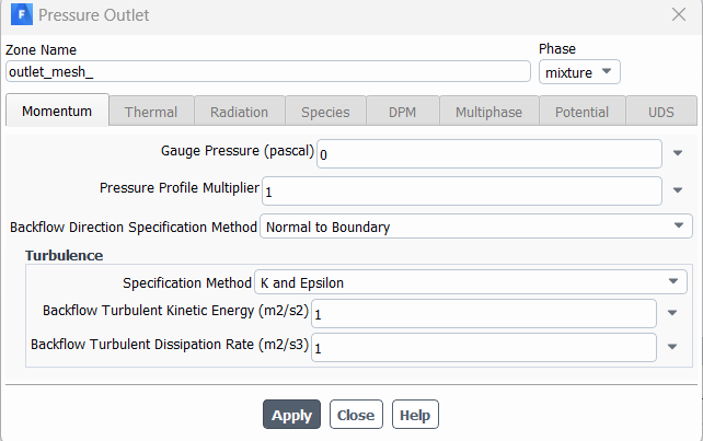

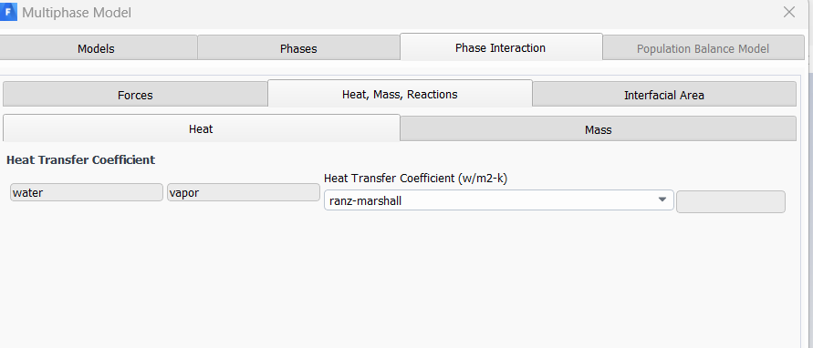

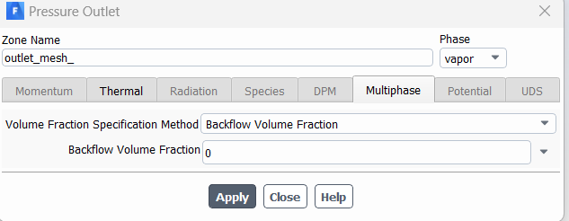

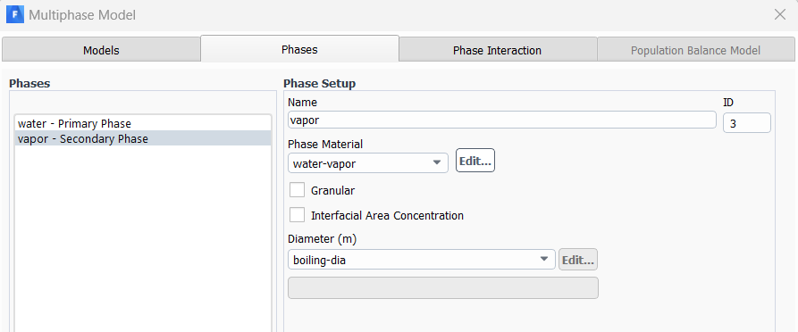

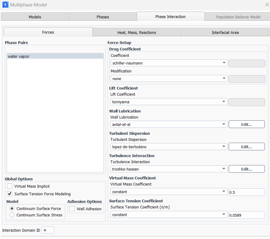

      Hi Dears,
      I am trying to simulate boiling around horizontal tube to check bevaiour bubble and find heat flux and boiling heat trasfer coefficinet with different super heat temperature ( super heat = tube wall temp. - water satuation temp.)
      I selelcted Eulerian- RPI model with kepsilon model.
      Please see which corelation I put for forces, ehat-mass transfer. ( taken from a article already done by soneone for PhD thesis)

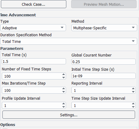

      Hovever, I am fixing time step as 10^-9 and mesh fisr layer = 10^-5 still havong floated error.

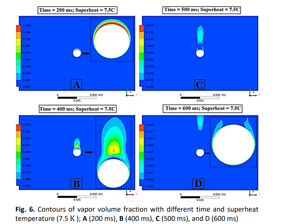

      Expectation :
    • sinan ozbolgili

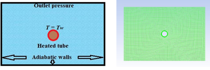

      the geometry as below picture
      Aso I wuld lik to specify, the vapur volume fraction getting redce after some time. and it it not coverage 10^-4. alswayas remains around 1 and 10^-1

      From the image I don't know what your near wall mesh is so can't comment.

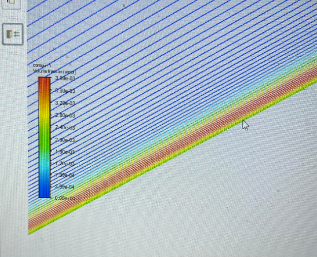

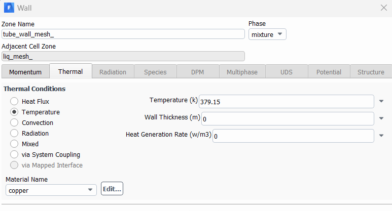

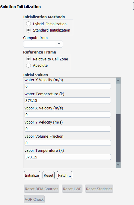

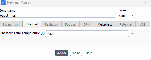

    • sinan ozbolgili
      HI, pelase see pictures.
      I am giving tempearure condtion surface of tube.  Second picture zoomed in
      You may want to read up on the boiling model, I suspect the near wall mesh is too fine. Aspect ratio is likely very high for multiphase too.
    • sinan ozbolgili
      Thanks, do I need to change first layer thinkes to increase and rescrease ratio ?
      If the mesh is too fine increasing the first cell height might be a good idea! Increasing the number of nodes around the pipe will also help with the aspect ratio.
