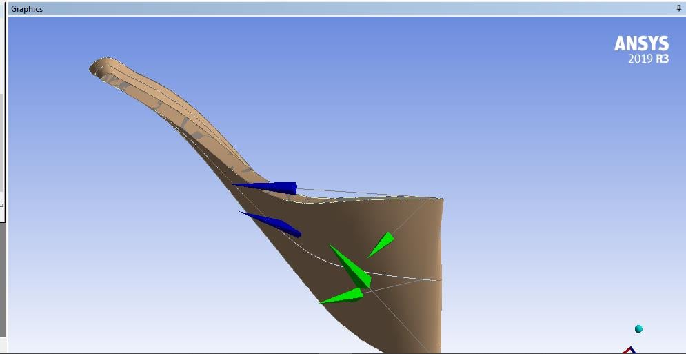

      Good morning Sir,
      here attached are visible the photos of a generical view of the blade in CFX Pre and the photo oof the blade only.
      Generical_View

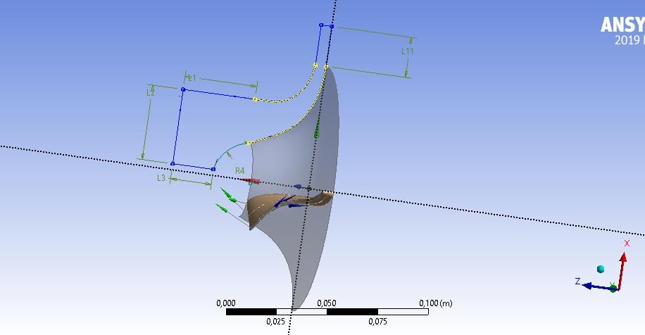

      As you can see, in the first photo, the blade seems to be "empty", because in DesignModeler I have used loft command between two closed 3D lines. Also, here below is show the DM window of the sketch.
      The dimensions are referred to the inlet and outlet domain. The blade is constructed starting from the hub/tip contour.

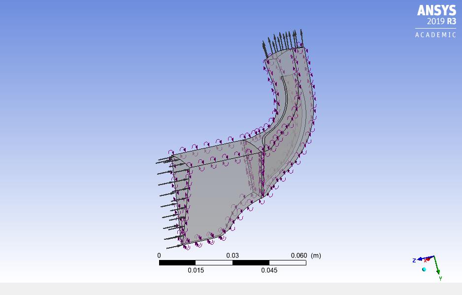

      I have used the command "Surface from edges" for create the hub and tip surface, and works well. Here below there is the image that represents the surface at
      the tip. Then I have created the hub surface, using the same command. I have used 0 m thickness both at the hub and at the tip. All the normals are flipped in a manner that I have the normal that is oriented outward (respect to the body).
      However, when I used "Body Operation - Sew" it fails. Also, it cannot select the blade surface, made with command "skin/loft".
      In the end, I try to make a new DM file. I imported the two 3D curves of hub and tip, I made loft operation for create the blade surface, I performed your suggested command for hub and tip but "sew" does not work.

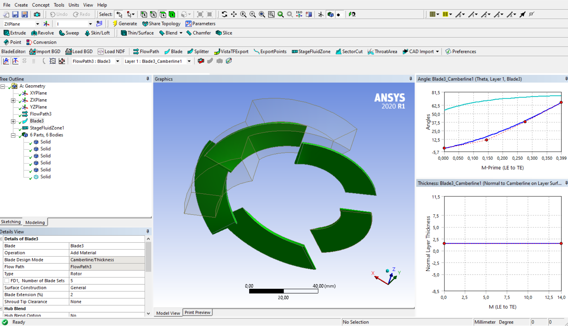

      Hi everyone,

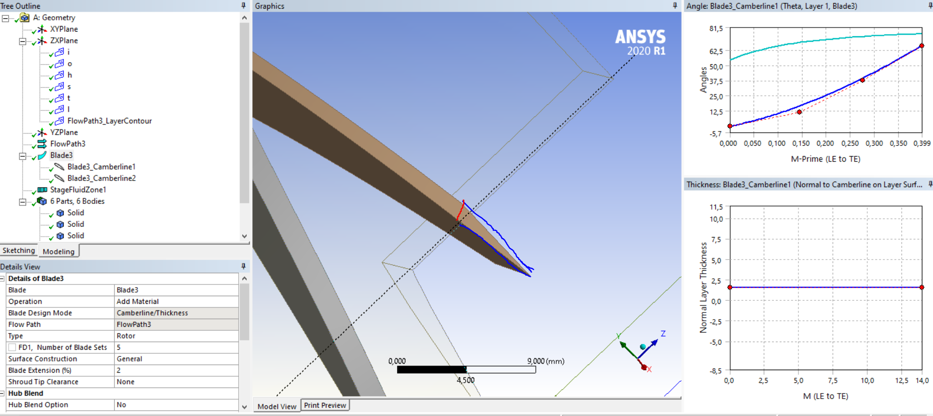

      I am trying to make a CFD simulation for the axial turbine. I created the blades in the blade modeler in DM. The turbine blades that we use in real have a constant thickness from the leading edge to the trailing edge and I wanted to do the same thing in design modeler but it gives me airfoil instead. As you can see in the picture, the tip of the blade has a sharp edge, I want it to be a flat surface. I mean when you look at the shroud the top surface of the blade should be rectangular. Do you have any suggestions about it?
      As you see the blue line represents the current tip of the blade and I am trying to make it as red line. The full illustration of the blades can be shown below.
      Thanks in advance
