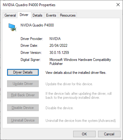

      Hi Support ,
      A customer is having big issues with Discovery not showing they are getting the black screen.
      The customer is using a p4000 graphics card that should be compatible, they are on the latest drivers and have tried multiple other drivers.
      The graphics card has all been selected in the Nvidia control panel.
      Anti aliasing is off
      Anything else we can try?

      Hi Charudatta Bandgar
      I have seen the issues with the 45x drivers this doesn't seem to be this issue as we have  tried 390, 460,470 and now the 512 versions.
      The customer has 2 graphics cards he is able to use the weaker one M2000 in Discovery 2021R2 but wants to use the 2022R1 for the latest features.
      The m2000 just gives blue results in this version so he needs to use his P4000 which is more powerful.
      We have specified which card Discovery should use and gone through all the steps but still getting a black screen.
      We have tried older drivers and with one the Explore mode doesn't even appear which suggest incompatible driver. With another it appears but then there is an incompatible cuda version.

      Hi, customer has managed to contact Ansys Direct and apparently there are issues with customers using dual graphics cards.
      The customer has a P2000 and a M4000.
      The solution is to completely disable the graphics card you don't want to use. This should be documented somewhere if this is a known issue.
