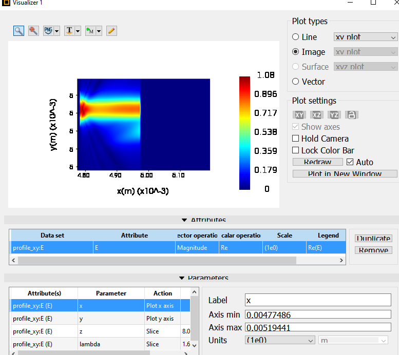

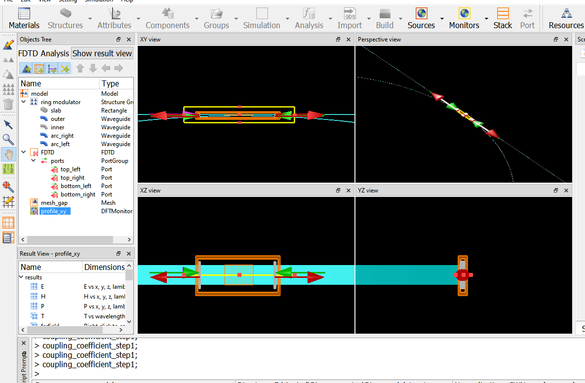

      As mentioned in the coupling FDTD (above section), I have tried for coupling of mode from bus to ring. Here I a trying for 5mm radius of the ring . The mode is not completely entering into the ring instead cutting off during half of the of the FDTD region (in bus itself). Hence I am obtaining coupling coefficient as zero. I a trying to replicate as in the paper "146510.pdf (hindawi.com)" by using a approach as mentioned in ring modulator "Ring modulator – Lumerical Support"
      I am attaching few images. Please let me now, where I am doing wrong. Simulation time is 1000fs and it taking 2 hours, shall i increase it?

      Hello, I am not able to download the screenshots. Would you be able to post the screenshot here (similar to what we have done in the upper posts)?
      If you notice that light stops half way and the simulation is done, chances are you may need more simulation time. For example, if neff = 2.5, simulation time is 1000fs, and it can approx travel 120um single pass.
      If your simulation region is larger than that or it has multiple pass events then it might need more simulation time. In fact, you can refer to the coupler_region.fsp file for some reference. If testing takes too long, perhaps you can start with running some 2D simulations. It should save you a lot of time for some initial tests.

      Thanks, by increasing simulation time it worked.
