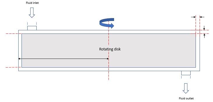

SubscriberHello everyone,
I have to simulate this geometry attached here. It has a rotating disk at the center like a Taylor Couette reactor. What would be the best mesh for this 3 D geometry? I must say that automatically tetra mesh is generated but max skewness is about 0.85 which is in the acceptable range.

Forum ModeratorPlease check the following video:
https://www.youtube.com/watch?v=RELLrEJ9chg
Also, you can slice the geometry to create a hex mesh but if you are getting 0.85 skewness that should be ok too.

Ansys EmployeeIf you are able to generate tetra with acceptable quality, please go ahead with that.Â
