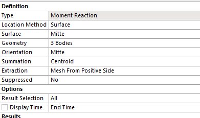

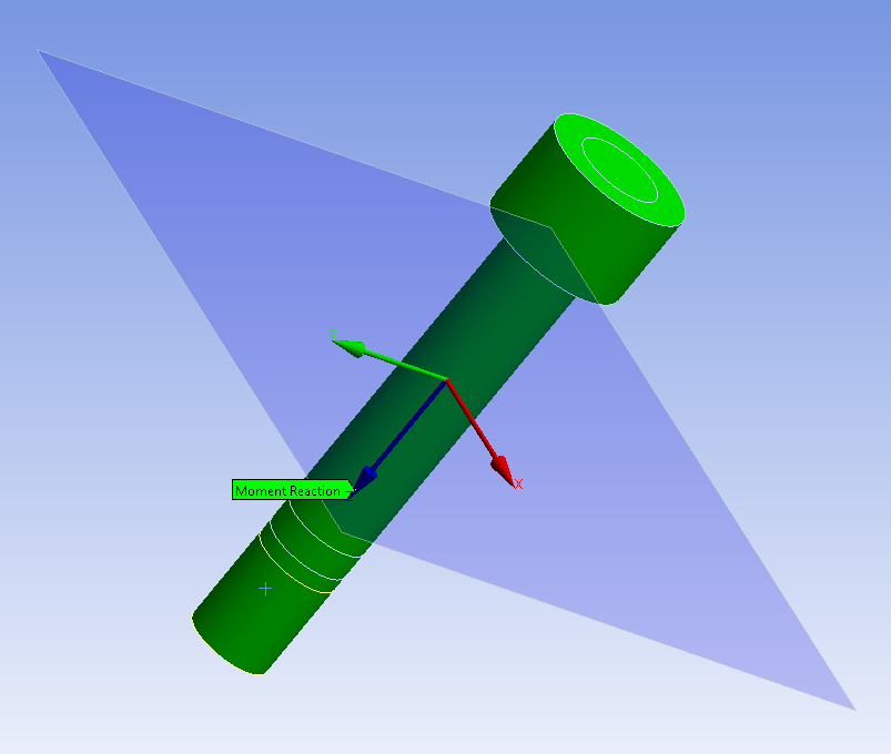

SubscriberHello everyone, I want to measure the bending moment of a bolt and I created a surface and tried to get the Moment Reaction out of the solution.
These are the Details of the Moment Reaction:
Apparently, there is something wrong with the control settings but I am not sure what. Do you have an idea?
It says: "A result is invalid with the current output control settings."

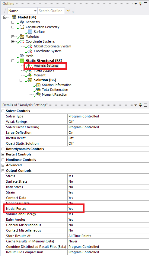

Akshay Maniyar
Ansys EmployeeHi Tim,
Can you try switching the 'Nodal forces' option under Analysis setting < output controls to yes and then rerun the model? It is mostly because the result file does not have the required results.Â
Thank you,
Akshay Maniyar
April 20, 2023 at 12:02 pm
Tim Dietl
SubscriberHello Akshay, yes it works now. Thank you!
