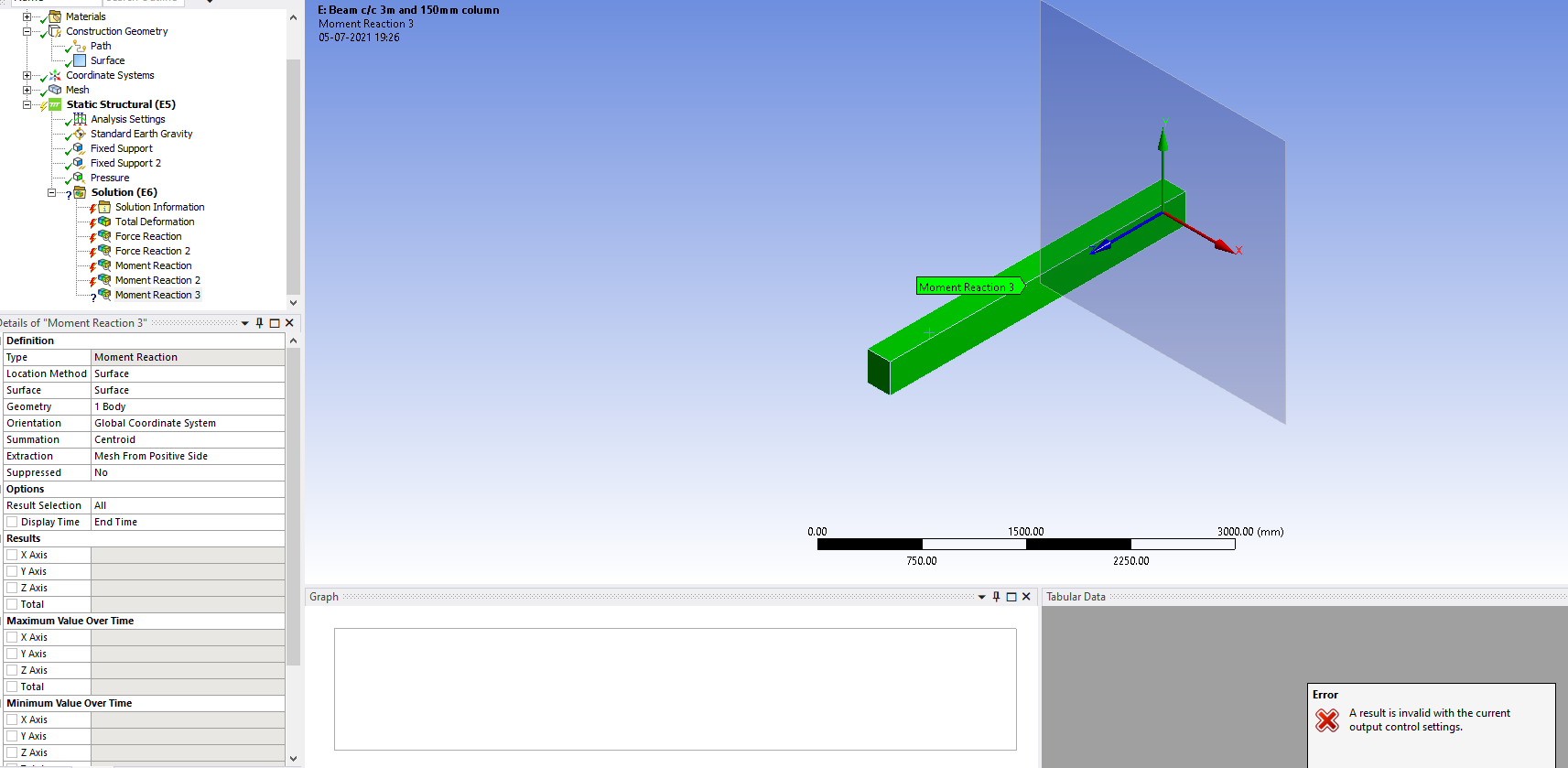

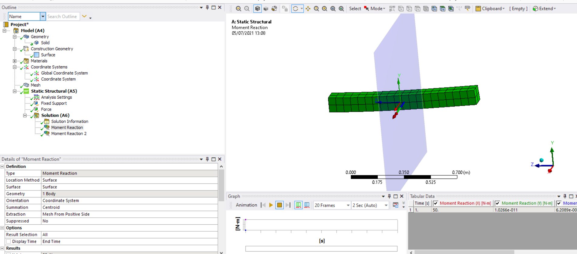

      Kai : I could generate the "surface" but could not produce a "moment reaction" using "probe". Please find the below screenshot. I want to generate Bending Moment Diagram along the beam.
      My attempt look like this
      While solving it software throws below error

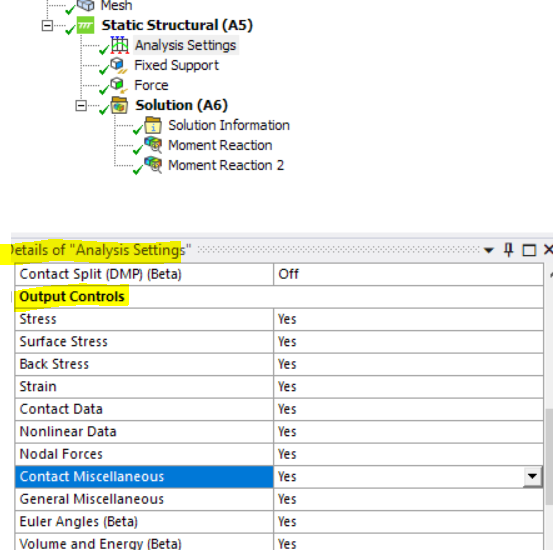

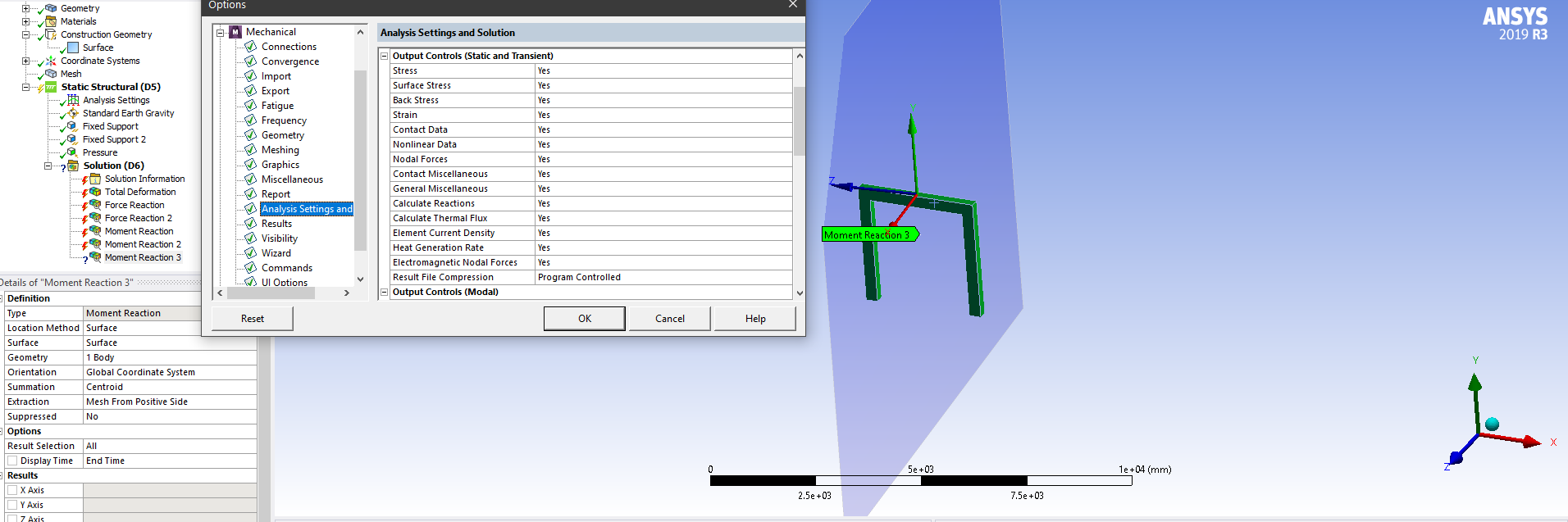

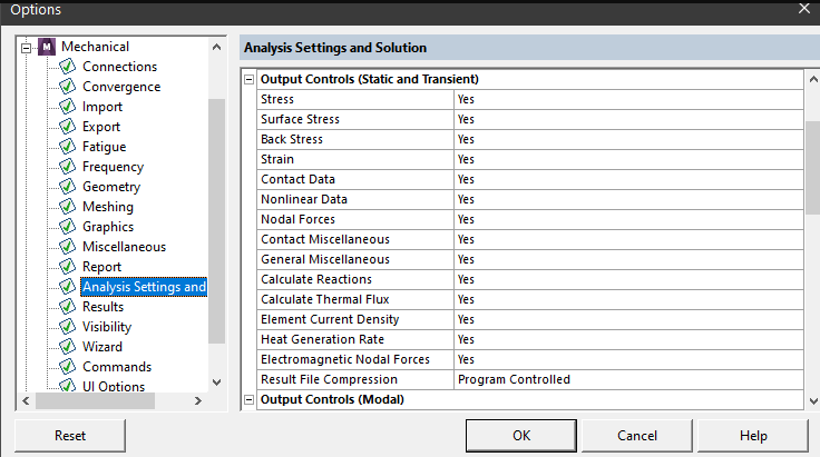

      First use a surface that is along the zy plane (we need the x nodal forces that cause the moment about global z) - finally under analysis settings, and output controls, set all to yes (so nodal forces, etc).
      Finally to generate the internal moments along that part, we would need to have several surfaces and then several moment reaction results (scoped to these different surfaces) in order to get the moment reaction along different locations along the beam.

    • ErKo
      Not sure - try it on one single beam/3Dpart so simplest of models (see below).
      Settings:
      That should work

      Getting same warning
      pdvelani
      You changed the Options for Mechanical to use in a new project.
      To change the settings for the current project, you have to be in Mechanical and click on the Analysis Settings as Erik highlighted in his images.
    • ErKo
      peteroznewman , many thanks for that.
      please as shown previously change the settings as shown below:
    • pdvelani
      peteroznewman ekostson

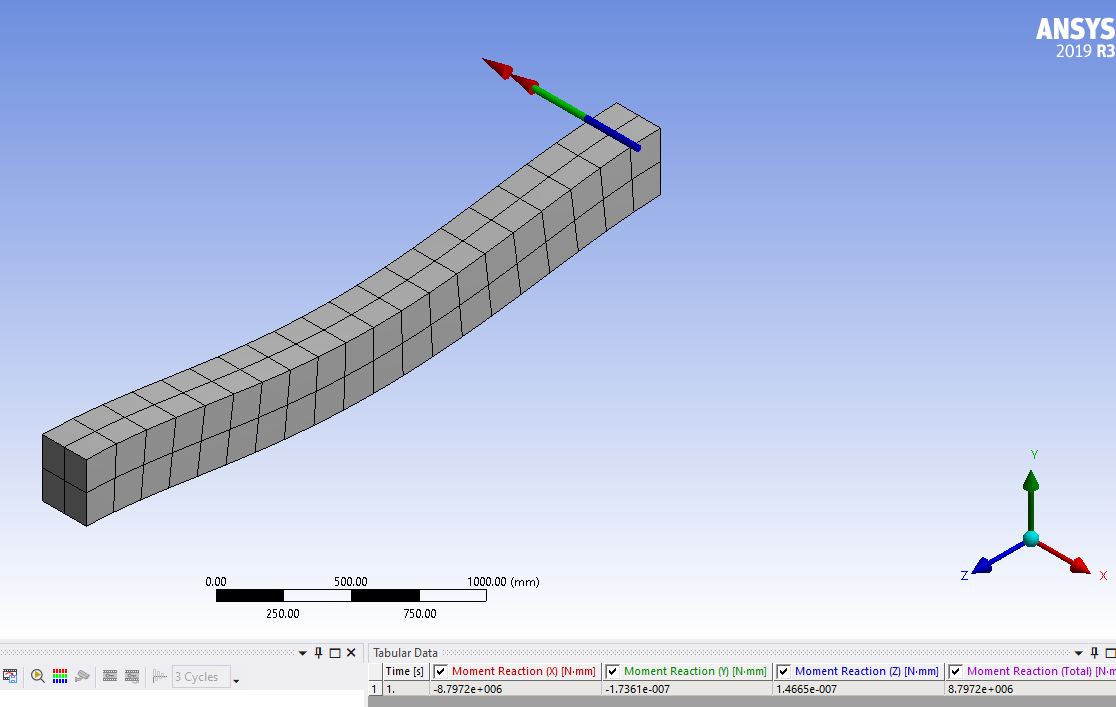

      Thank you for your response. I could generate the Bending Moment values.

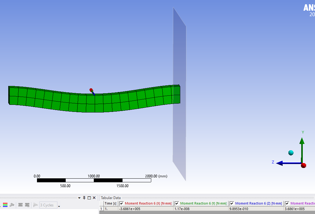

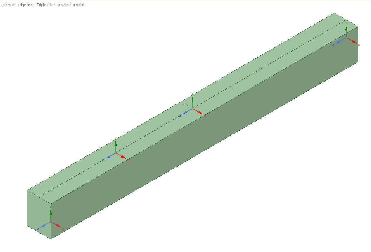

      However, I need small clarification/insight regarding the results. I am creating different "origins" at the start, at quarter length, at the midpoint, and at end of a beam as shown below.
      The surfaces are created at respective origins and bending moment values are generated. To my surprise except at the midpoint rest 3 locations the answers are not satisfactory. The values at start and end origins are not matching with the moment generated for the "Boundary condition".
      Correct values based on boundary condition --> -8.79 kN.m
      Inoorrect values based on surface--> - 3.686 kN.m
      Can you guide me in fixing the possible error in modelling?
      Further, Do I have to construct a number of origins and surfaces at all desire locations where I need Bending Moments? Is there any better way to construct Bending moments at many locations other than what we are discussing now?

      You should have a coordinate system for each surface and each location where we want the moment in/about.
    • pdvelani
      ekostson : Thank you. Any feedback on 1st question? Why there is a difference in values from "surface" and "Boundary condition" "moment reactions"?
    • ErKo
      One is the moment reaction on a boundary condition, and the one oe is the moment reaction taken where the surface is defined - so one would not use surface to get the moment at a boundary condition say fixed, we would use the boundary condition option, and ofcourse we need to use the surface option to get the reaction in the mesh and away from the boundary condition, say midway along the length of the beam.
      All the best
      Erik
    • pdvelani
      ekostson : Yes, I completely agree with your explanation.
      To verify the bending moment I am generating a surface at 20 mm before the boundary condition (near the right end of beam). The bending moment at this point is 17.23 kN.m which should be less than - 8.79 kN.m (moment obtained at boundary condition). Hence, I am not yet confident about the result and suspect shortcomings in my modelling.
