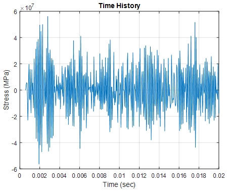

      I looked at the data in the excel file sampled at 25 kHz, which is an adequate sampling rate.
      There is a lot of noise in the data.

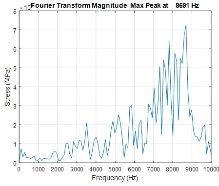

      If you do an FFT of that data out to 10 kHz, the high magnitude is in the high frequencies.

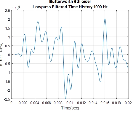

      You can filter the data with a 1000 Hz cutoff filter and get this time history plot

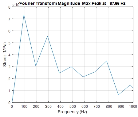

      Then do an FFT on the filtered data
      It still doesn't come close to the 161 Hz frequency you were looking for.
      I recommend using the Ay value from the neighborhood of the defect. That seemed like a nice clean signal.

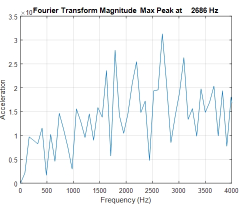

      I opened the Neighbour point. The sample rate is now only 10.42 kHz.  What happened to the 25 kHz that you had before?  When you ask for 6 times longer end time, you have to ask for 6 times more output also.
      Here is the time history of the last 24 ms.
      In any case, here is the FFT of the last 24 ms of the signal.
      Explicit Dynamics is notorious for noisy output. I don't know what you need to do to get a useful signal. Maybe add damping and simulate a much longer time scale (with a higher sampling rate).
