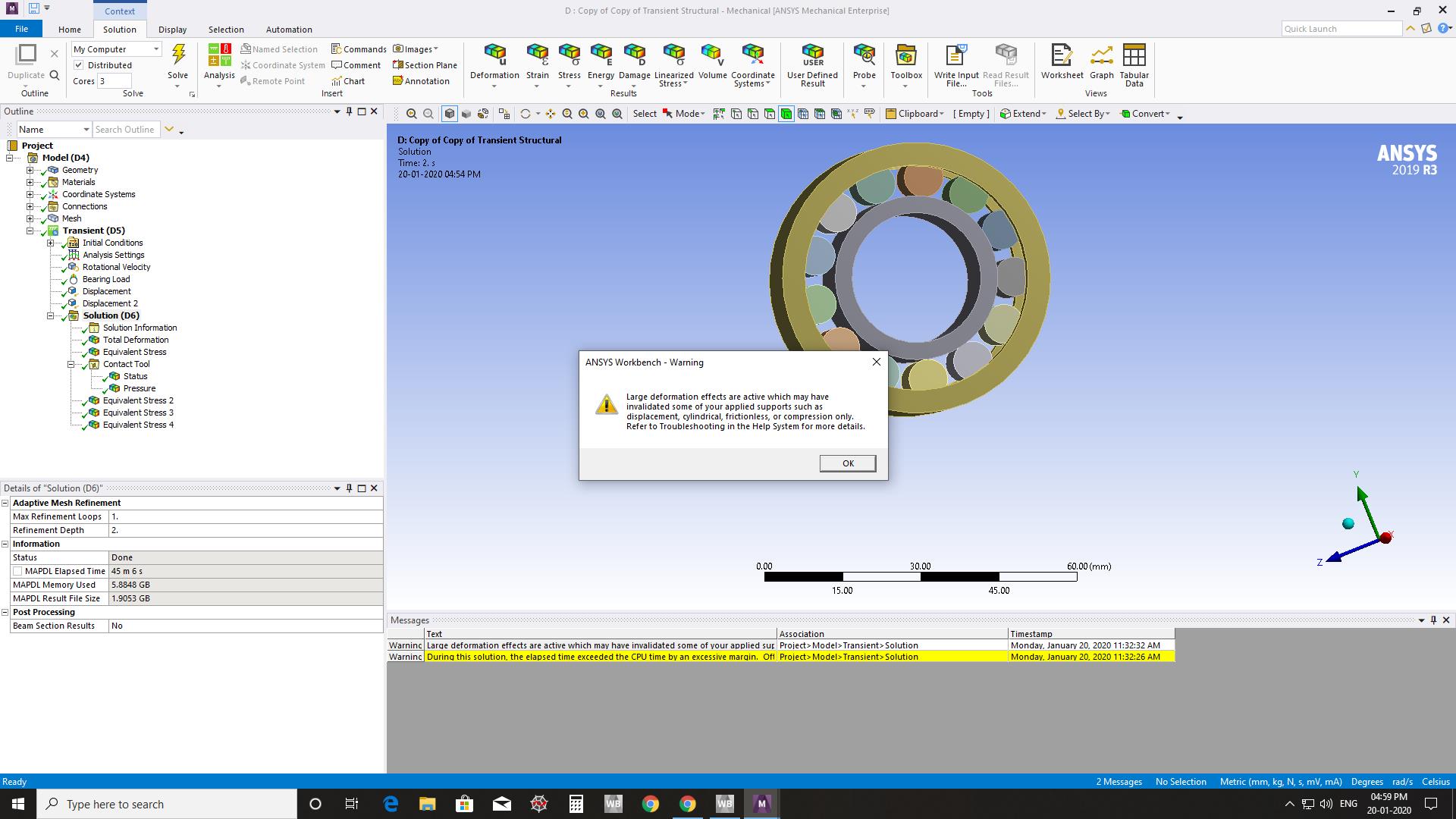

I am a student of mechanical engineering and I am working on bearing simulations. I am doing transient analysis of multibody system i.e bearing. I am using Augmented Lagrange formulation with normal stiffness as 0.1.
Still, the solution is not converging.Â

SubscriberDoes one of the rollers have a crack in the geometry?
It will be a very long simulation if you have to spin the bearing up from zero velocity.
I would recommend removing all revolute joints, adding a cage, and relying on contact only.

No, none of the rollers has crack geometry in it. I will add it later when the simulation will run without a crack.
can you elaborate what do you actually mean by zero velocity? As the bearing is running at a particular speed so I have taken two steps and in tabular data, I have taken 0 t0 300 rad/s and in 2nd step 300 to 300.
Ok, I will with that.

SubscriberYou used an Inertial Load called Rotational Velocity. You don't understand what this does. It applies a radial acceleration load to the mass in the model from the axis that is proportional to the radius and the rotational velocity squared. It does not rotate a body.
You can apply a moment to rotationally accelerate the mass of the inner ring.
There is no cage to keep the rollers spaced evenly.
I simplified the contacts, I reduced the bearing load temporarily to see if that helps it converge. I improved the mesh.
This model converges for a few steps, so I am uploading it for you to look at.

SubscriberI let the attached model run for nearly 12 hours on 15 cores on my computer. It computed 799 iterations to generate 59 converged steps to cover a simulated time of 5.4 milliseconds. In the attached zip file, you can see a movie of the rollers falling due to the gravity load I added. There is not enough moment on the inner ring to get that to rotate.
Considering that it will take even longer to compute once you add the cage and a crack, I suggest that is is not a fruitful method of studying a crack in a roller or race.
