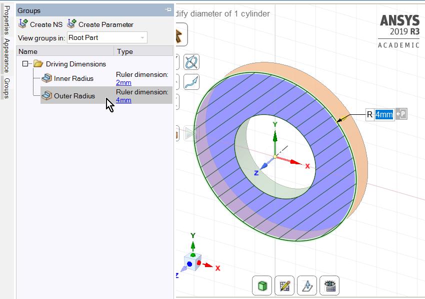

      In SpaceClaim, I expanded the Beam Profiles folder to get to the Extracted Profiles in the Structure.
      Right Click on one of the Extracted Profiles and select Edit Beam Profile.  Then a section of the solid shows up. It is possible to click on the circular edge and create a Parameter by clicking on the P.
      I renamed Group 1 and Group 2.
