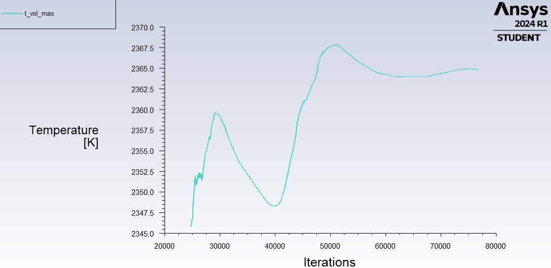

April 19, 2024 at 10:17 pm
Daniel Thomas
SubscriberHi Ren,
Following up on this, with another question. I ended up extending the domain in the y-direction to include the adjacent wall and sheath flow inlets, and repeated my mesh study to check the effect of refinement in the y-direction. With a refined grid, I was able to see the expected slight upward shift in the flame with conditions of slow flow and exaggerated gravity. Very nice to have that result -- and thank you for your help.
However, for flow rates corresponding to my experimental conditions, I am seeing peak temperatures almost 100 K higher than expected -- even with substantial grid refinement. I'm solving the energy equation with volumetric reactions using an imported mechanism. I've included the species transport inputs below. I didn't find any tutorial exactly matching this. Are you aware of any? I'd be particularly interested in any that includes radiation for this gas-phase (no soot) flame.Â

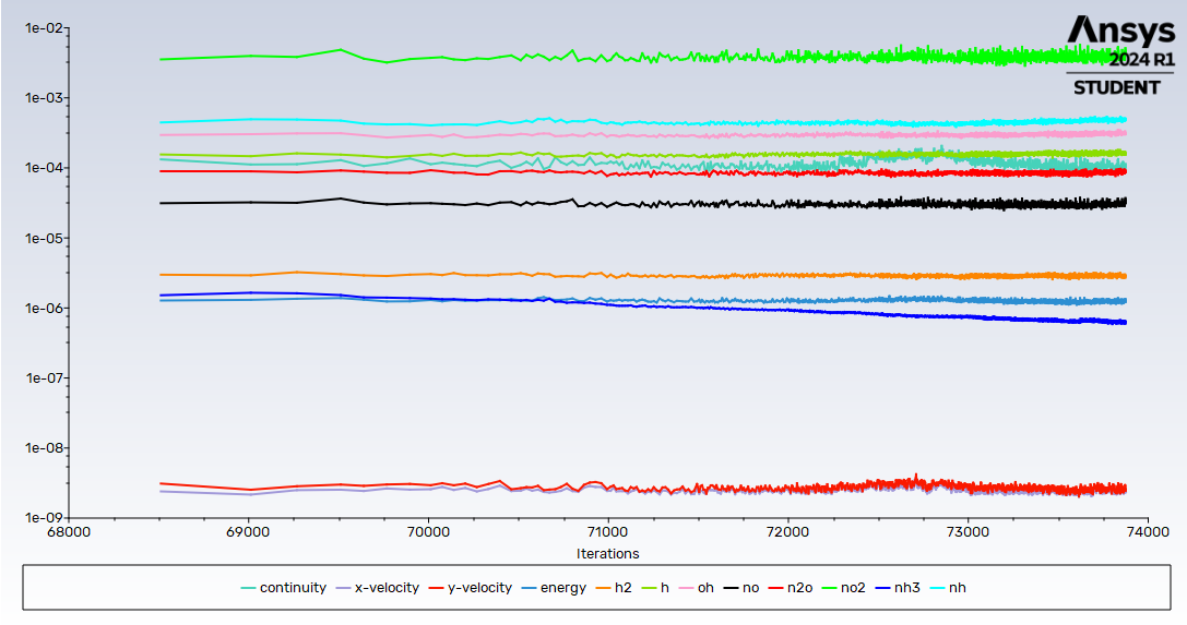

April 22, 2024 at 3:20 pm
Daniel Thomas
SubscriberHi Ren - Thanks for the note; the Integration Parameters are below. I have not used ISAT before this project with Fluent, and the settings there are default. Do you think I should reduce the ISAT tolerance?
The fuel is a mix of 65% H2, 35% NH3, molar basis, and I'm using a mechanism from Stagni et al, 2020, which is currently one of the better ones available for predicting N-H-O reactions in ammonia combustion (31 N-H-O species, 203 reactions, https://pubs.rsc.org/en/content/articlelanding/2020/re/c9re00429g ).
April 23, 2024 at 2:20 pm
Ren
Ansys EmployeeHi, Daniel,
The settings are fine. What is the energy equation residual looking like? Is it small enough?
April 23, 2024 at 8:16 pm
Daniel Thomas
SubscriberHi Ren,
Thanks for the note. The residuals plot is below, showing energy at about 1e-6. The only residuals that remain higher are the minor species, such as NO2, which are present in very low ppm levels. This particular simulation seems fine from the residuals, but is waiting for total energy and temperature parameter to steady out. Any ideas on other things to check?Â
April 24, 2024 at 10:16 am

April 24, 2024 at 1:30 pm
Ren
Ansys EmployeeCould you please try the following first:
- Define a monitor for max temperture in the domain, run the existing calculation further to check if the max T is still changing.
- Activate the DO radiation model, set the absorption coefficient method to wsggm-domain-based for the mixture material.
April 24, 2024 at 2:38 pm
Daniel Thomas
SubscriberHi Ren -- Thanks for these suggestions. I have been monitoring a maximum Temp variable, which does take a while to steady out (as do the average Temp and total energy variables) -- see below. For this current run, I'll continue to allow these to stabilize some more, although the current variation (~2K) is much less than the difference from expected temperature profile (~100 K). Â
Thanks for the suggestion on the radiation model; that was something I was going to ask you about. For this fairly high temp flame it should be significant though probably not accounting for the whole existing discrepency. I'll be in touch once I've tried that.
