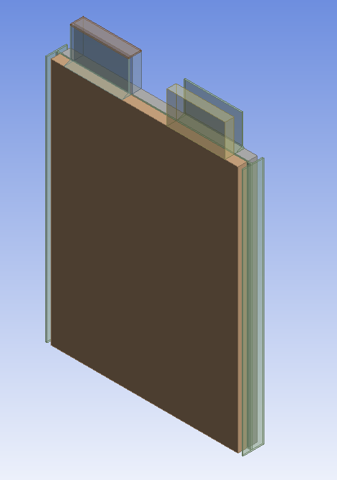

      I am modelling 2 battery cell using ntgk battery model and between these 2 cells i have placed a heat carrier plate to dissipate heat to a cooling medium. Now without this heat carrier plate, my simulation is running completely fine but when i am including heat carrier plate in model then solution is getting diverged.
      Can anyone please help ?
      For reference i have attached an image
    • Murari Iyengar
      Hi, what does the mesh for the heat plate look like? It has a thin cross section, so the mesh should be of adequate resolution.
    • thme21139
       Yes with fine mesh problem got resolved,thanks a lot
