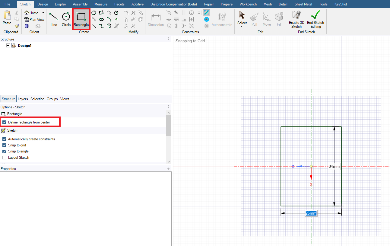

You can also use SpaceClaim for creating geometry. In SpaceClaim, you can draw a rectangle from the center by selecting the ‘Define rectangle from center’ option as shown in the below image.
