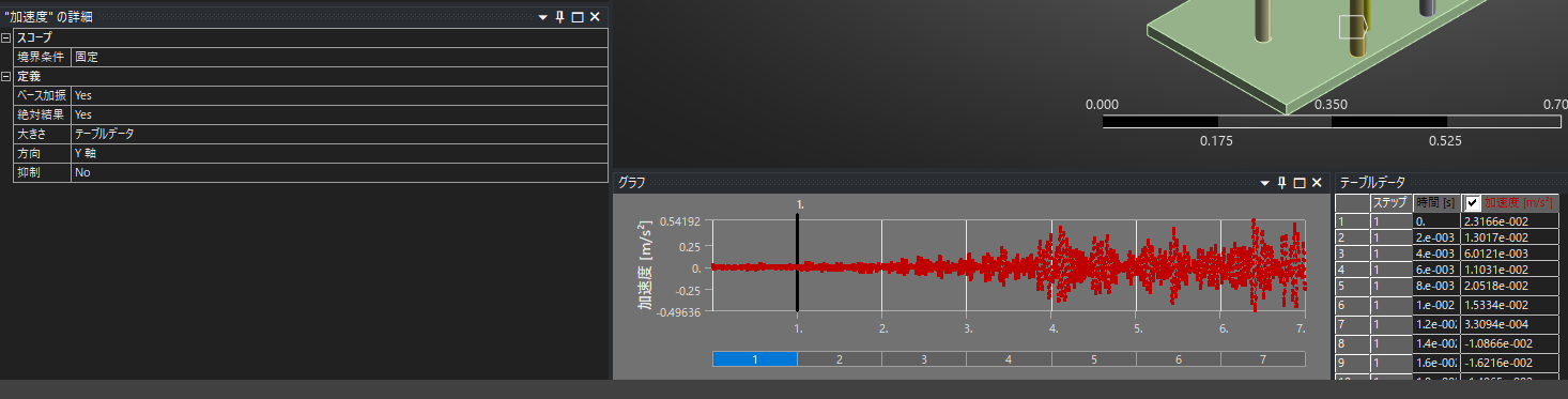

Base excitation is not working correctly in the time-history response analysis.
    • 22ek075

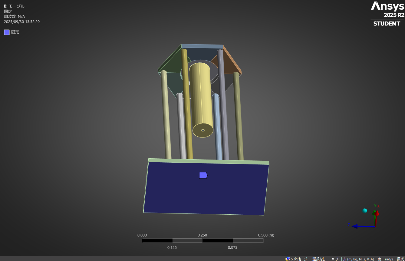

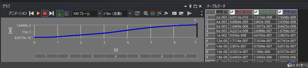

      Message This analysis was performed using modal analysis with the mode superposition method, and the acceleration is applied in the vertical (up–down) direction. The model should be fixed, but the entire structure moves (see the photos below). As a result, the expected response waveform is not obtained. What can be done to fix this? I would appreciate any advice.
      Analysis Settings(Input)
      fixed surface
      Result(Output)
      You get different displacement results for Base Excitation of a Transient Structural depending on whether you set Absolute to Yes or No.
      Read this discussion for an in-depth explaination: https://innovationspace.ansys.com/forum/forums/topic/base-excitation-absolute-result/
