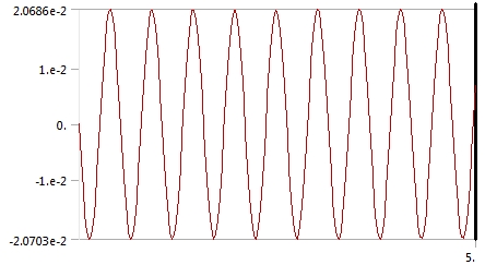

      Acceleration load sine wave with a 1 G amplitude has the following displacement amplitudes:
      • 30 Hz = 0.2761 mm
      • 100 Hz = 0.02485 mm
      ANSYS staff are not permitted to open attachments.
      The Modal analysis shows the following modal frequencies.
      At 30 Hz, the object is moving nearly 1000 times slower than it can vibrate. All one would expect to see in the output of a Transient model with base acceleration is a rigid body motion.
      Looking at the Displacement function in the Transient Structural, the amplitude is 0.0207 mm but there are only 9.5 cycles in 5 seconds. That is 1.9 Hz.
      What frequency were you intending to produce?
      To see the transient response of an object that vibrates at around 40 kHz, you need 20 time steps per cycle.  That means the sampling rate should be 800 kHz or a time step of 0.00000125 seconds.   The Analysis settings currently request 50 substeps in 5 seconds. That is a sampling rate of 10 Hz, you need 800,000 Hz.
      Under Damping Controls, there is no damping and there is no damping in the material either. Transient response is highly dependent on damping if the object is excited anywhere near its modal frequencies.  In this case, since it is so far away, it may not be important.

      Look at the Modal frequencies, mode 1 is 25 kHz.  If you want to plot the motion of an object vibrating at 25 kHz, you need to plot 20 points per cycle. If you plot less than 20 points per cycle, you won't see a smooth sine curve, you will see a jagged mess.  That means the plotting points or the points that sample the sine curve are coming at a frequency of 500 kHz. Therefore the time step is 1/500000 seconds or 0.000002? seconds.
      Now if you shake an object with a first modal frequency of 25 kHz at 25 kHz, that is called resonance and the object will have some response to that input. That means if you are holding the base and moving the base left and right by X mm, the tip will move by more than X mm. There will be some displacement of the tip relative to the base.
      But if you shake that object at 30 Hz, and move the base by 0.25 mm, the tip is going to move by 0.25 mm. There will be almost no relative displacement.
      You could simulate shaking that object for 1 second and watch it go back and forth 30 times, but you will need to have 500,000 time steps to try to capture the motion of the tip relative to the base.  But there will be almost no response.
      Now if you had a much, much lower Young's Modulus, and the first natural frequency was 40 Hz, then the sampling frequency would be 800 Hz.
      The 20 points per cycle applies to any sine curve in the time domain. You have a 100 Hz displacement function that lasts for 5 seconds. Therefore, you need 100x20 points/second or 100x20x5 = 10,000 points for 5 seconds.  You set the Number of Segments to 200 in the displacement function. That number needs to be 10,000.  In the analysis settings, you have asked for 500 substeps. That number needs to be 10,000.
      Remember, 20 points per cycle. It's a simple rule. If you have multiple frequencies, you have to pick the highest frequency to get the smallest time step. So if the 40 Hz natural frequency is being excited by a 100 Hz acceleration, then it is the 100 Hz that you use to calculate the time step.
