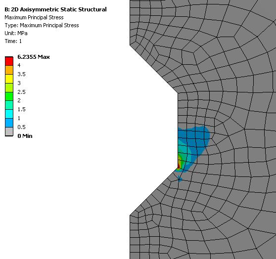

      Concrete in your model has a UTS of 4 MPa.  I applied 10,000 N to a 2D Axisymmetric model and found that at 6,400 N, the Concrete Maximum Principal Stress reached 4 MPa, so that is where the peak of the curve in Figure 1 is estimated to be.
      I didn't do a mesh refinement study, and this is a somewhat coarse mesh. Unfortunately, if you were to run a mesh refinement study, the stress would keep increasing at the 6,400 N load because there is a sharp interior corner and that represents a stress singularity in the model. You have to add a small radius to the geometry to get rid of the singularity.

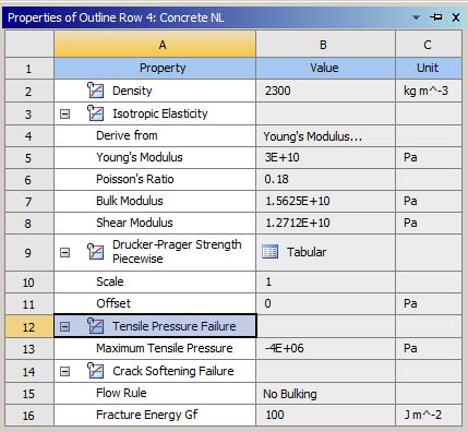

      1) In a Static Structural model, Concrete and Concrete NL are identical materials. They are both linear materials that only have a Young's modulus and Poisson's ratio. The entry for Tensile Ultimate Strength doesn't change the solution result, so the solver is not "using" that value. It is only there in post processing of the results to divide by the maximum stress to calculate a Safety Factor in the Stress Tool. I don't use that myself. I prefer to plot the Stress rather than the Safety Factor.
      If you create an Explicit Dynamics model, then the Concrete NL has a Tensile Pressure Failure criterion that allows elements to fail during the simulation. Now the solver is using the failure criteria by taking out elements that have exceeded the value of Maximum Tensile Pressure shown in the materials data.
