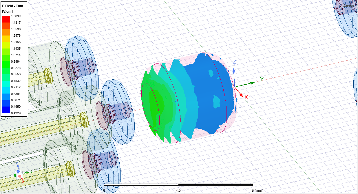

SubscriberI want to calculate an average electric field of an object and determine the percent of the object's volume having E field above 1V/cm. What are equations that I should use? And how do I set up in Calculator?
For instance, I have a cylinder with a diameter of 5mm and a height of 5mm. A range of E fields varies from 0.4-1.5V/cm.
