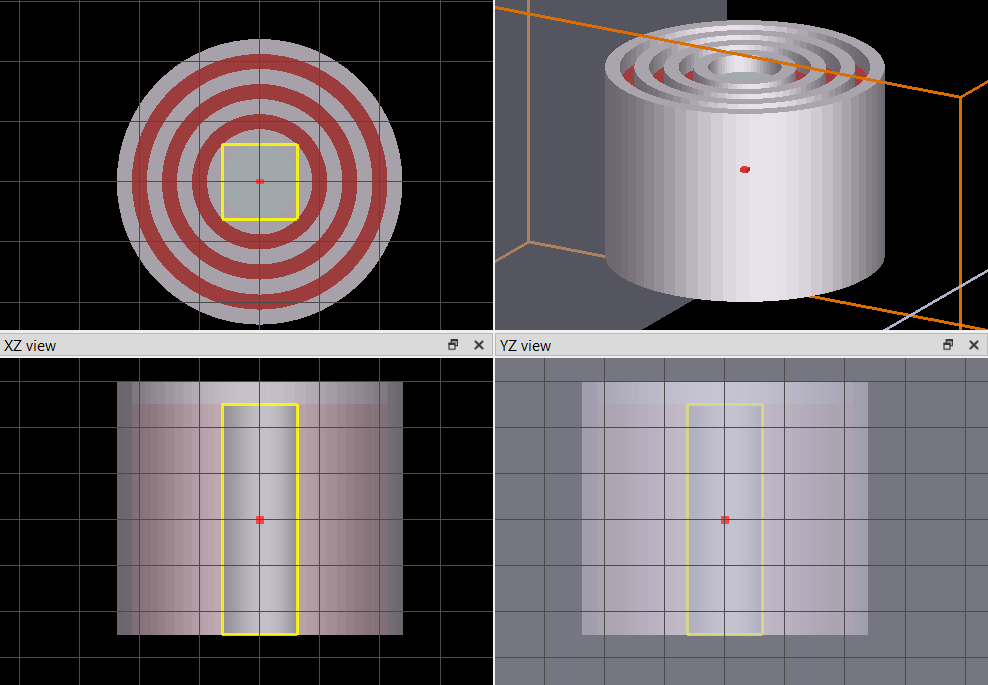

      Hello. I'm simulating an optical antenna structure. There is a fiber in the center of the structure.
      I'm using a 3D monitor as it seems in the below image.

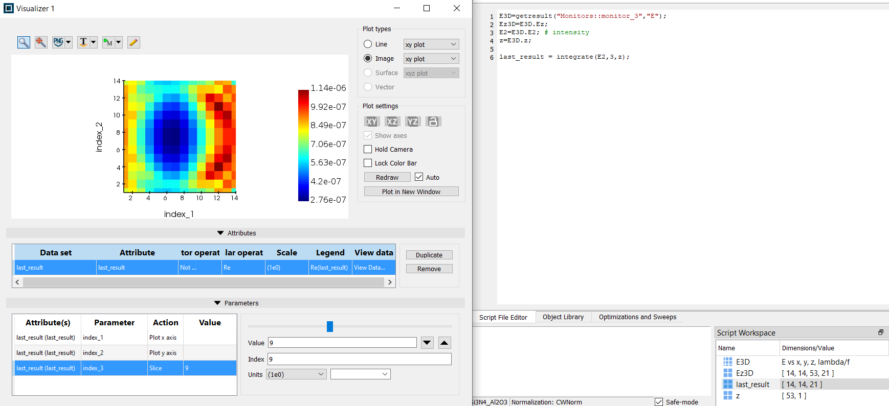

      Once you get the E-field from the 3D monitor, you can integrate along Z only. related scripts are
      getresult  eg E3D=getresult("monitor","E")
      dot operation  Ez3D=E3D.Ez  #Ez
                             E2=E3D.E2; # intensity
                            z=E3D.z
      integrate  eg integrate(E2,3,z);
      Please search online if you want to get more informtation for each script.

      Actually, not the cavity. There is an actual fiber there but it's hard to see a bit I think ? source is outside of the structure, it's located at x:-600nm , y: 0nm, z: 600nm. It's a plane wave source. Fiber is at the origin of simulation which is x:0, y:0 and z:0.  Whole simulation area geometry is xspan: 2000nm, yspan: 2000nm and zspan: 2000nm.
      I used the script you mentioned and attached the integration result to "last_result" variable. Then I visualized it. Here is what I get:
      I'm using 21 steps for the frequency band. When tried to see actual 3D monitor results, it gave me 53 datas for each frequency step. Now I can monitorize just frequency responses for "z" axis. I think this makes sense.

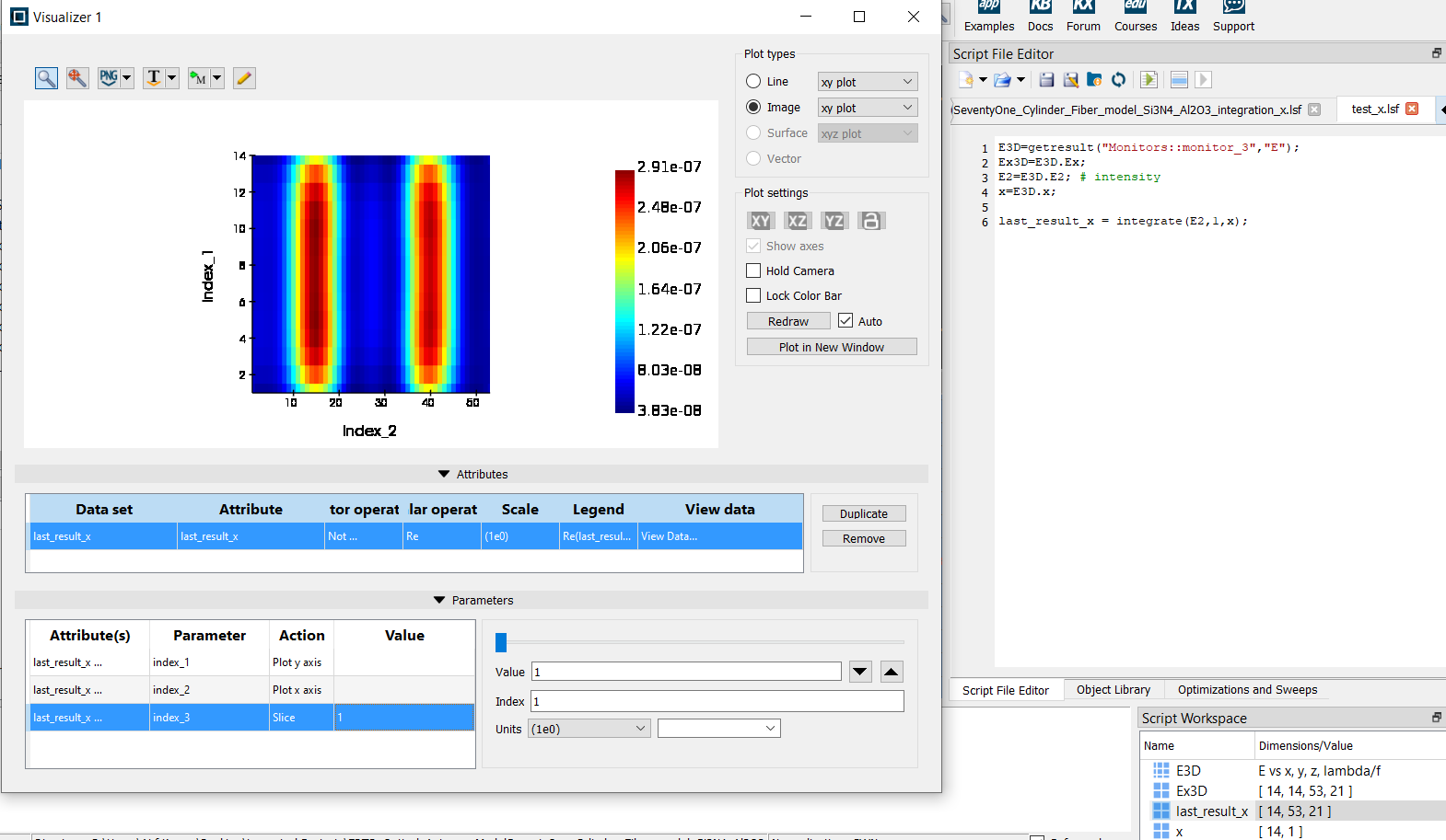

      First, with the same script, I tried to visualize the average E-field values for "x" axis and I get the image below. It actually seems that it shows the fiber cavity, but I didn't understand why it shows like there two fibers?

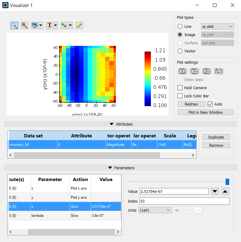

      Second, after the simulations I was able to see the E-field results like "1.23,1.03" etc. Like the first image I've sent. But after the integration process, when I tried to visualize results, it was like "1.14e-06, 9.92e-07". Like previous image I've sent. Why is it shows like this? And since the source's amplitude was "1", can I say there are some amplifications happens in some places on fiber?

      Please use dataset to create the image data so you will know which axis represents what quantity: https://optics.ansys.com/hc/en-us/articles/360034409554-Introduction-to-Lumerical-datasets
      There is no Amplification for linear simulation, as you can measure the transmission and reflection are smaller than 1. However, the electric field can be enhanced, due to interference, diffraction and reflection (forming cavity standing wave).
      Please note, you can normalize the intensity by dividing your current result with integrate(E2/E2,3,z). This way you can get relative field strength to the source amplitude. As you know the integration creates an additional length dimension.
      Since this is cylindrical device, it has symmetry so you see two "bars". SO I guess the index_2 is along its diameter, index_1 is along its length? from your first image, the strong E-fields are not at the center.
      It is not supprising to me, as you are simulating a cavity, with a plane wave excitation. Do you use TFSF local plane wave, or regular plane wave with periodic boundary condition so you are simulating periodic array? if your device is a single section for fiber, please use TFSF: https://optics.ansys.com/hc/en-us/articles/360034902133-Understanding-source-normalization-in-the-TFSF-source
