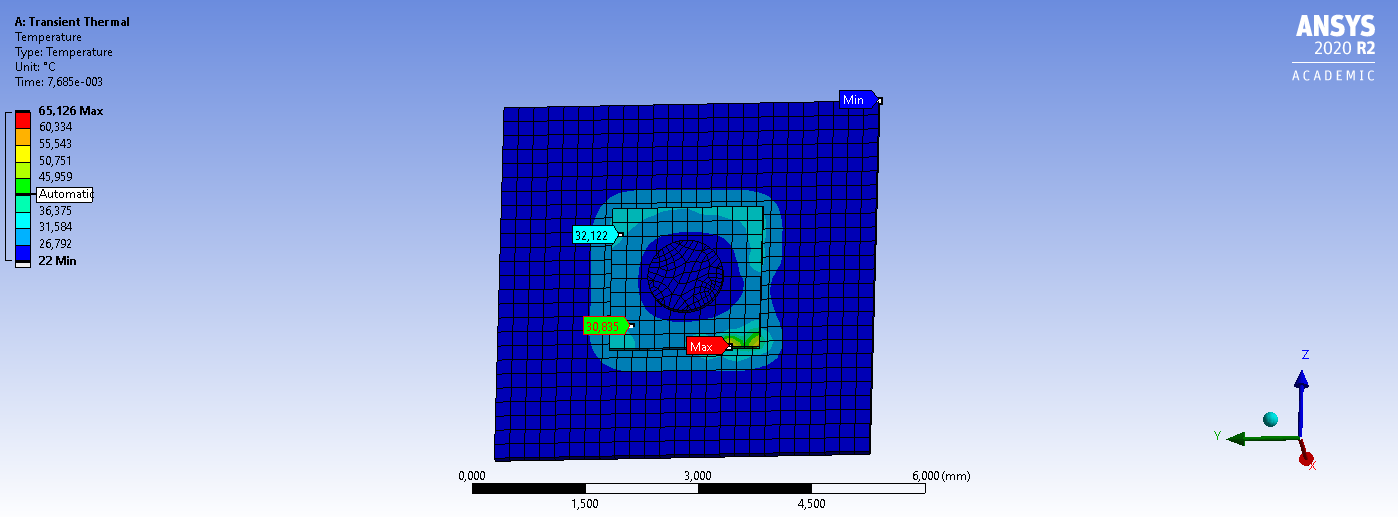

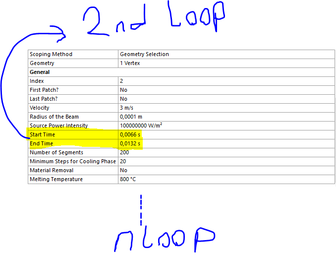

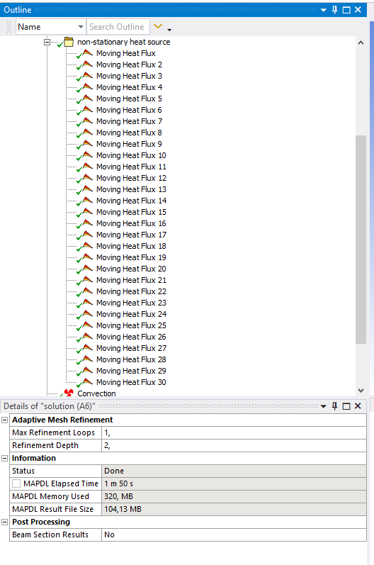

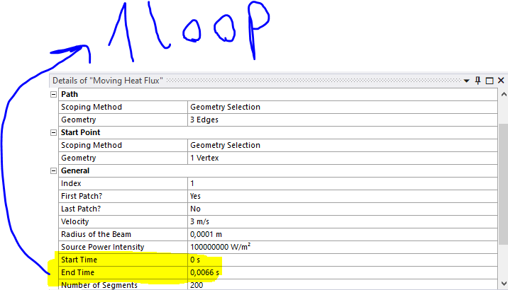

SubscriberAs it is ullustrated in the video, I would like to create one moving heat flux that can travel around the rectangular object as many as I want (like a loop). To do so, I needed to create 60 heat flux, but it is not practical when I want to make 500 loops with keyboard. If you suggest to create automate the insertion of moving heat flux, that is also fine. Could you elaborate how to do?
or any other ways to use same heat flux that can make 500 loops around rectangular object?
Or any way to change the start and end time in an automated manner since it seems to does not have parameter sweep properties.
