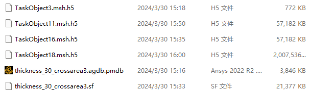

I'm using FluentMeshing and write a mesh. I found that in working directory, there is a work file containing following file.
Are these files still useful? I hear that SF file can be use for convenience in some cases but I cannot find further information about using SF file. Do you know how to use it and under what kind of circumstance can it be used? Can it be used in WTF flow?
Highly appreciated any suggestions!!!!!!!
April 1, 2024 at 5:42 am
Keyur Kanade
Ansys EmployeeYes, these files are important. These are back up files for WTF.Â
SF file can be used in different model with similar dimentions and geometry topology.Â
Please go through help manual for more detailsÂ
