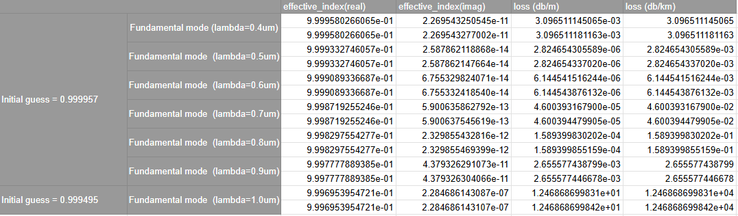

      Currently, I'm using SiO₂ with a constant refractive index of 1.45. My first guess for the effective index was 0.999957. Initially, I manually created a table with the effective index values and corresponding loss results. However, I now want to perform a sweep across the entire wavelength range to obtain a more comprehensive dataset.

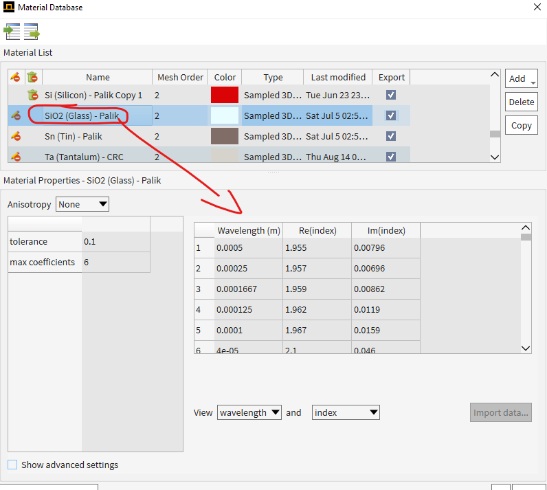

      Hello Gabriel,
      Thank you for contacting us.
      I would suggest to use a frequency dependent material (SiO2) as it is depicted below.
      In that way the change of frequency/wavelength during the frequency sweep will return the corresponding effetive refractive index for every frequency point you sweep.

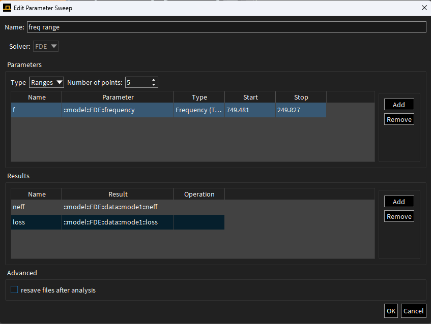

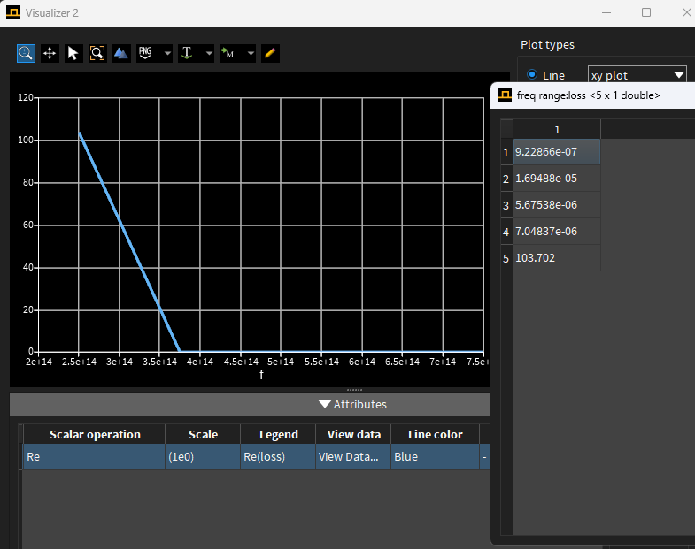

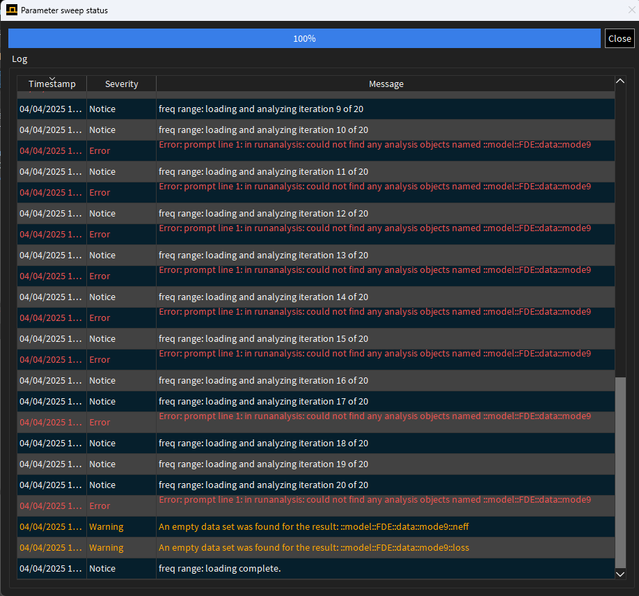

      As for the optimization and parameter sweep setup, I tried running a sweep but ran into an "empty data" error (as shown in the image below). Do you happen to have any insights or suggestions to achieve better results? Also, how many sweep points would you recommend using in this type of simulation?
    • Dimitris Polyzos
      Hello gabriel,
      thanks for your reply.
      I reckon that as the error message say the solver cannot find any modes. You could do a manual test to check the modes for each parameter and then proceed to a parameter sweep. The solver can find modes for your initial simulation and then it might not be able to find modes for every value of the parameter you are sweeping.  The sweep should save the files from each iteration of the sweep in a subfolder, so you can try opening those files and running them to see what the issue is. I would also recommend to start with less parameter sweeps, for example 4 or 5 and then move to 20.
      I think that you should decrease the number of modes that you attempt to calculate as well. I had a closer look and I noticed that the error is associated with the mode9, which means that you have set , I assume 10 modes, and the simulation of your structure can support 8 modes so the sweep cannot find any information for mode 9 and above. Again, I would recommend to use the steps in my previous paragraph and you will easily debug it.

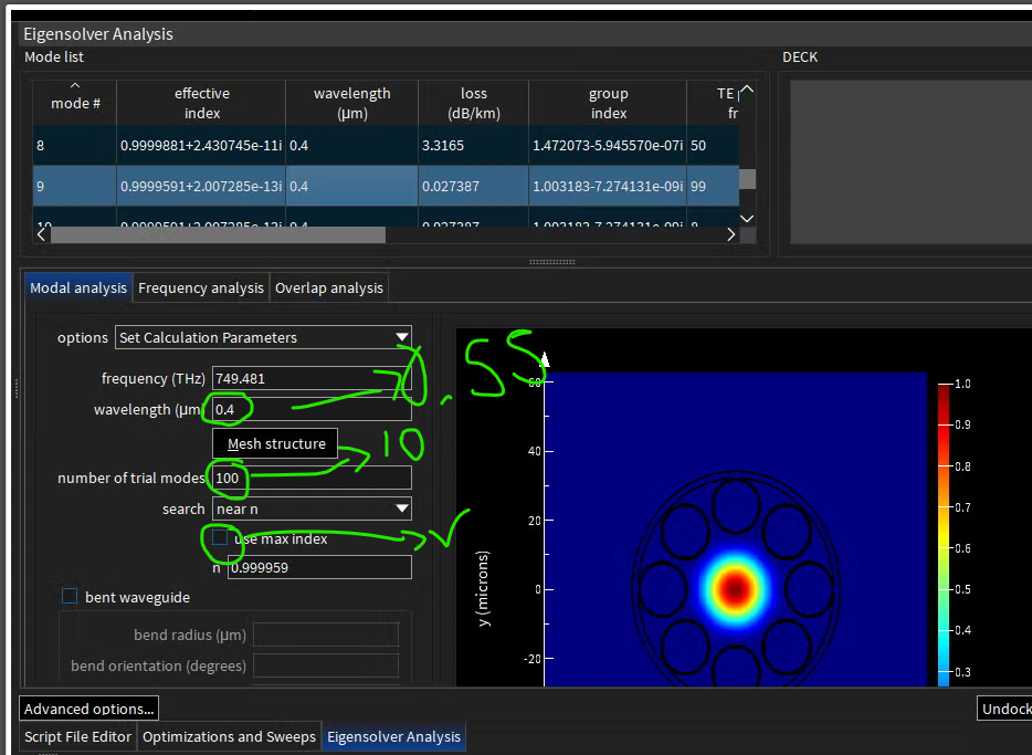

    • gabriel.morais
      Hello Dimitris,

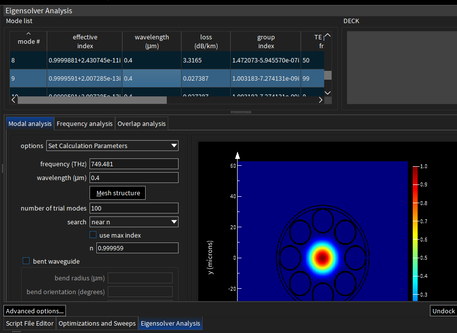

      Thanks for this information. I checked the files manually in the 9-point sweep, and it turns out the issue was that the software couldn’t find the fundamental mode.
      I tried adjusting the effective index initial guess to better capture the fundamental mode at 0.558 µm, but unfortunately, that didn’t solve the problem. Do you have any insights on how to improve this? Specifically, how can I stabilize the fundamental mode across the entire parameter sweep?
      Regarding convergence testing, I’m not entirely sure which parameters would have a significant impact on my system. Would modifying the span region or mesh refinement be the right direction?
      Looking forward to your suggestions!

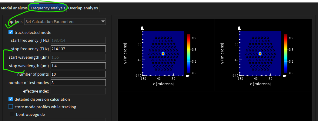

    • Dimitris Polyzos
      Hello Gabriel,

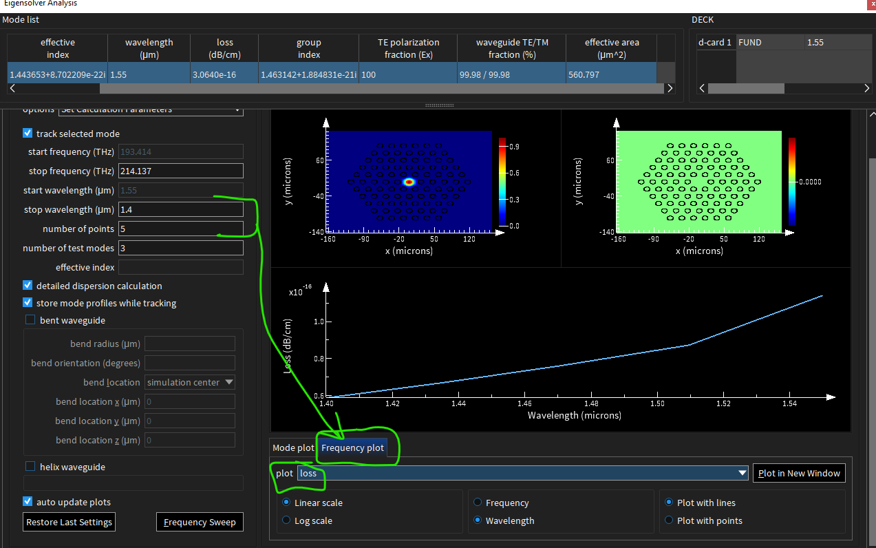

      I reckon that for start you should change the wavelength from 0.4 um to 0.558 um, and decrease the number of trial modes to somehitng like 10.
      The fundamental mode should be found for a specific wavelength and then you should perform a frequency analysis from the Frequency analysis tab. Then you can click to Frequency plot and choose "loss" to be plotted versus wavelength. This willbe for the fundamental mode that you chose. You can see how to navigaate to the Eigensolver Analysis tab from the images below:
      Regarding the convergence test I would recommnend to test only the mesh starting from a coarse mesh and getting to finner. At some point, there will be a mesh ize that beyond it the returned results are stable and have no contribution to the accuracy of them. Regarding the span I would recommend to do a convergence test of 3 points (you can do that manually as well). In general, the span should be enough large in order to confine the modes (choose fundamental) without chopping them in the BCs (you can check that by setting log scale at the E field visualization and see the Efield at tbe BCs, if it is less than 1e-6 the span is adequate and there is no need to make it larger).

      I’ve tried adjusting the settings for the number of trial modes, but the reason I’m currently using 100 is because when I lower this number, I start getting the “no physical modes were found” error.
      I also ran a frequency analysis, but I believe using the parameter sweep is the better approach here, since my goal is to plot a graph of loss (log scale, dB/km) vs. wavelength (µm) over that frequency range.
      So far, I’ve obtained some good results using the parameter sweep, with search in range selected for the modes.

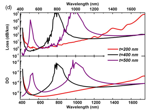

      1. To achieve a good-quality plot (similar to the reference graphic), how many wavelength points would you recommend including?
      2. Do you have any suggestions for a script command to generate a plot of loss (log dB/km) vs. wavelength (µm) using the parameter sweep data?
      I’d really appreciate any further tips or recommendations you might have.
      Thanks in advance!
    • Dimitris Polyzos
      Hello Gabriel,
      Thanks for your reply.

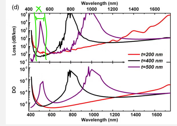

      I cannot say for sure a specific number of wavelength points but a rule of thumb would be as many your simulation can hold. As you can understand there in order to reproduce the plot from the reference the resoltiuion should be ideally 1 point per wavelength, where as I can see from the reference that the wavelength spans from 400 nm to 1600 nm. Even if you use 1 point per namometer you will need 1200 wavelength points which sound a bit of excessive to do so. Fo that reason I would recommend to try reproducing a small region from the reference (x = 50 nm) where a peak is depicted as you can see in the following figure:
      Try to use 50 points with resolution of 1 nm and check your results. Then I would increase the wavelength resolution to the full span of the reference with 10 nm or 20 nm per point. That depends on your computer resources and simulation time available, as it can run for hours in order to get a high resolved wavelength region.

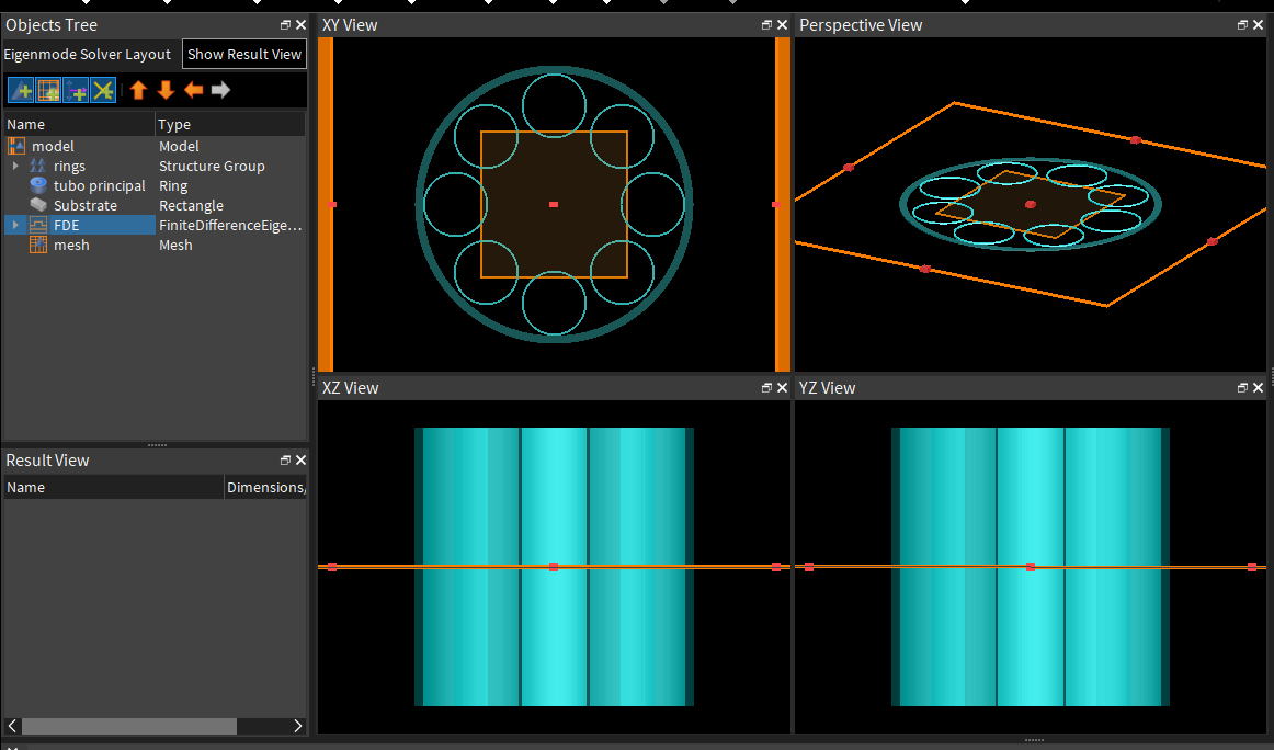

      A typical FDe solver region should be large enough to include all structures of your simulation model. In a previous post of mine I share a screenshot where the simulation region inlcudes all structures of the optical fiber. The PML region should be outside the glass jacket.
