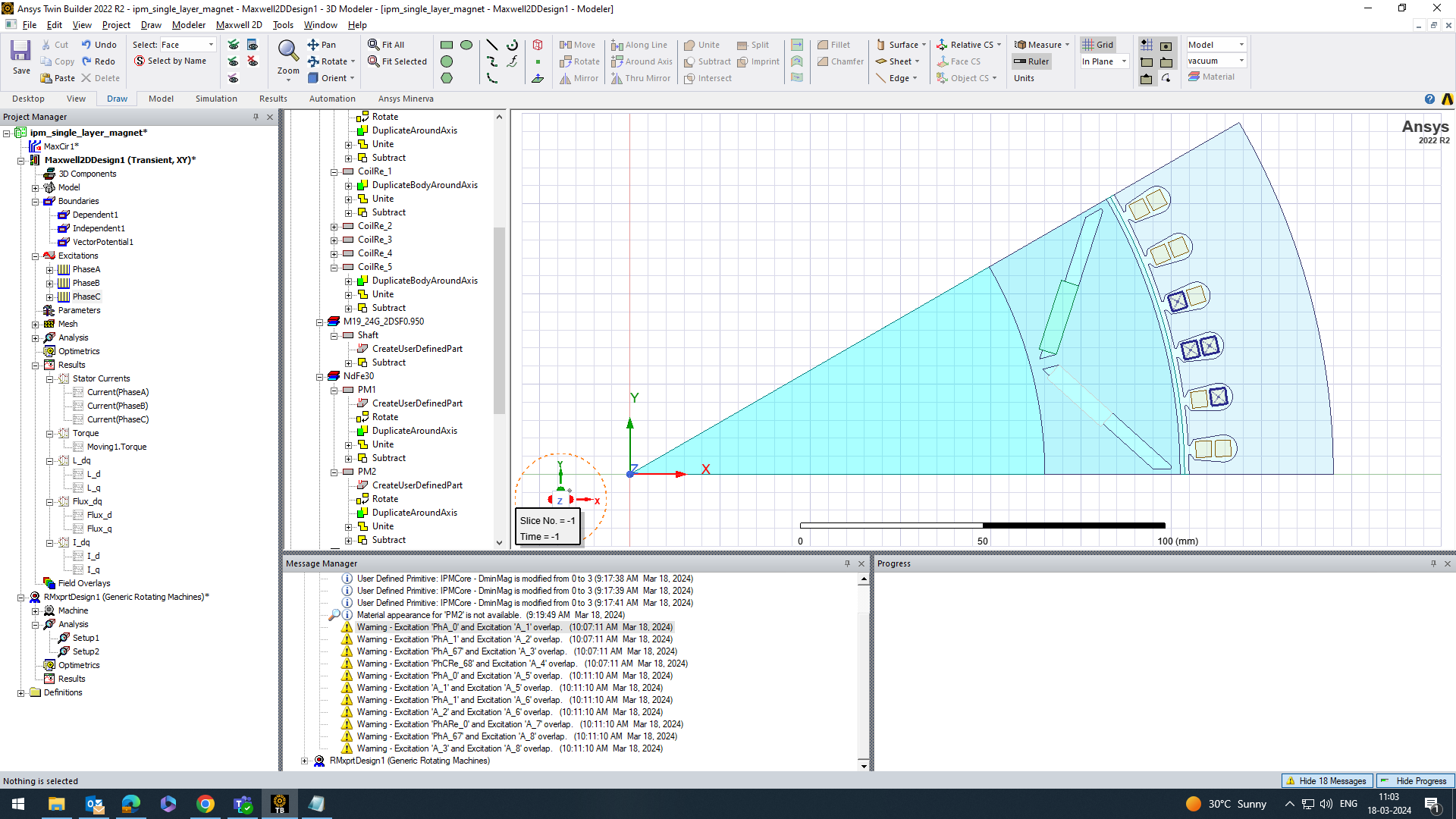

This means there are multiple squre coil objects overlapping at the same location. Please double check if all your coils are not duplicated. You can do this by select them in the model window and then hide them to see if there is another coil behind them.
