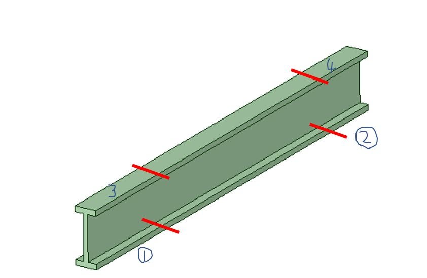

      Hi peteroznewman,
      Thank you for your explanation, that works!
      But if I want to divide my beam with trapezoid profile into 3 parts (like below picture). Since I would like to apply 2 fix supports at the bottom of the beam (place 1 and 2), and apply two pressure on the top of the beam (place 3 and 4). Do you know how can I do that with the method of extract?
      Thank you and hope you have a great day!
      When you have the full length solid, create two planes where you want the supports and use Split Body to make 3 pieces. Extract each piece into a Beam.  Then on the Workbench tab, use the Share button to make sure that the pieces share a nodes at each cut plane. Then in Mechanical, you will have a Vertex to support.
