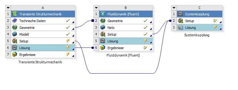

      I try to simulate a tank filled with water under an earthquake, for which I use ansys Workbench. That's why I chose a coupled analysis. I use transient structural mechanics and fluid dynamics (fluent) as analysis settings and system coupling for the interaction part (the tank wall should be assumed to be elastic). Now I try to apply the replacement load for the earthquake to the bottom of the tank and wonder how I can put an acceleration only on a surface of the tank volume. I am also open to other solutions or suggestions for solutions.

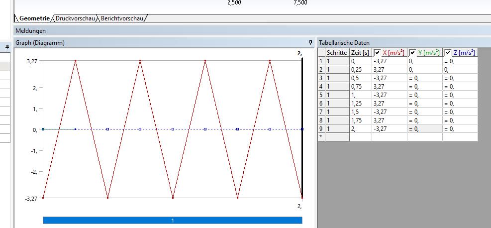

      Florian,
      I don't like your acceleration profile because the average acceleration is not zero.
      If you integrate that signal once, at 2 seconds, the tank is moving at 3.3 m/sec,
      and if you integrate twice it shows the ground moved 3.3 m from where it started.

      so for a simplified example, I would just have to make sure that the integral of each accelerator is not too far from zero, right? An example could be seen in the next image.
      It is a little better if the acceleration starts at zero and goes positive and negative, but this will work.
      You can do that by having the first time step be 0.125 seconds and the same interval for the last time step.

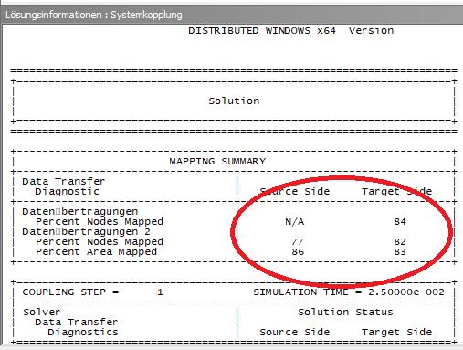

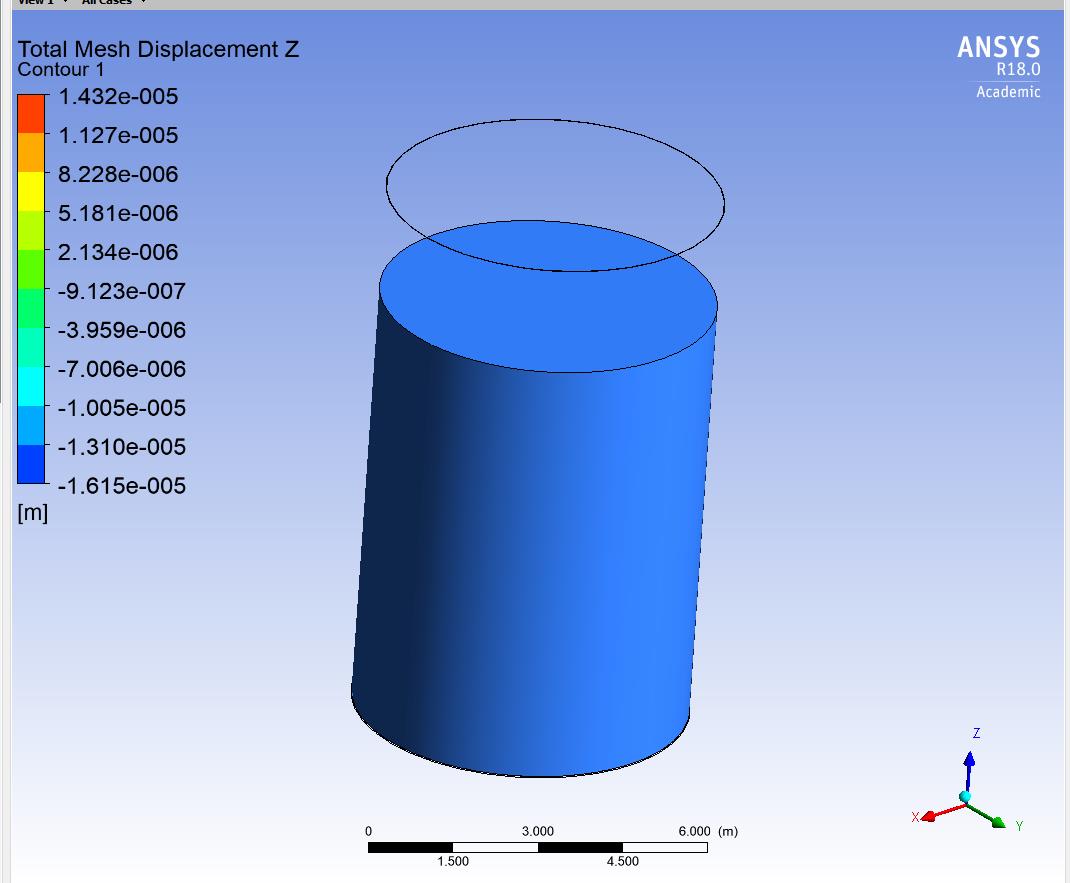

      Thank you again for the help so far, Peter. I've already calculated the problem a few times, but I never get a deformation of the water when I look at the results.

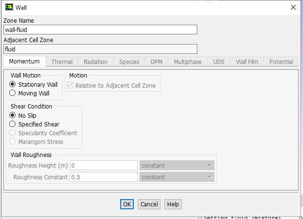

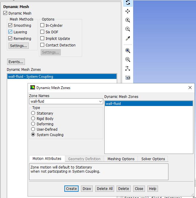

      An earlier calculation allows me to know that the "wall" of the water requires a dynamic mesh for the calculation. My settings for this can be seen in the image below. In addition, I think i remember that the boundary conditions of the water wall are set as a stationary wall.
      In addition, something seems to be wrong with my meshing, as the percentages here are not 100.
      I would be very happy about possible improvements/changes.
      I don't think the free Student license can do 2-way FSI coupling. That is where the motion of walls creates a force on the fluid, and the pressure of the fluid deforms the walls in a tight, 2-way coupling.
      I know the free Student license can do 1-way FSI coupling. That means if you have a Fluent model, which I expect would be a VOF model of air and water, you can simulate the water sloshing in a rigid tank in a transient model with an acceleration load. Then you can take the wall pressure results from Fluent and apply them to the tank walls in a Structural model and look at the deformation that causes.  That is 1-way coupling as there is no feedback from the wall deformation to the fluid.

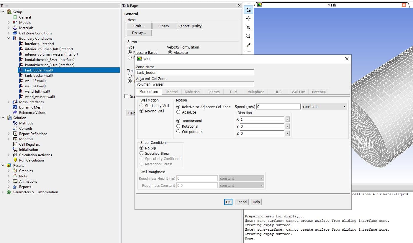

      Do I need a UDF to apply the acceleration at the bottom of the tank or is there another way to apply the acceleration? And if not what would this UDF look like?
      I don't think you need a UDF.
      Please reply with a screen snaphot of the Acceleration load in a Fluent Transient model.
      I'm just guessing, but I expect it has many rows and four columns for time, x, y and z acceleration.
      Someone who knows can reply with more information.
    • FlorianHenscheid1
      these are the boundary conditions i could enter
      Ty

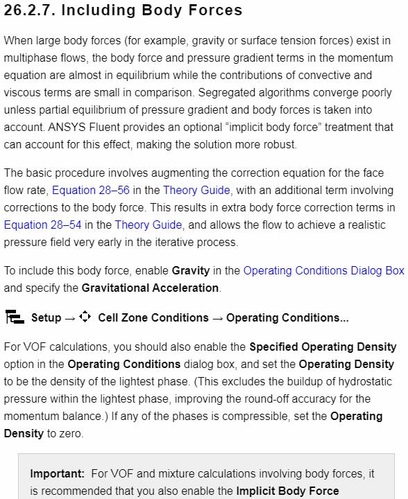

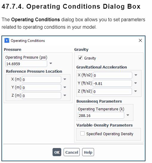

      I'm not sure, but I think there are no moving walls in this 1-way analysis.  All the walls are fixed.  The water and air move in and out of cells based on the acceleration body force that varies over time.  Look up Body Forces in the Fluent Help.
      I see there is Gravity that is easily enabled. You will want that on for sure.
      The question is can the acceleration be a function of time. I see there is a pull down next to the acceleration box. What is under that pull down?
