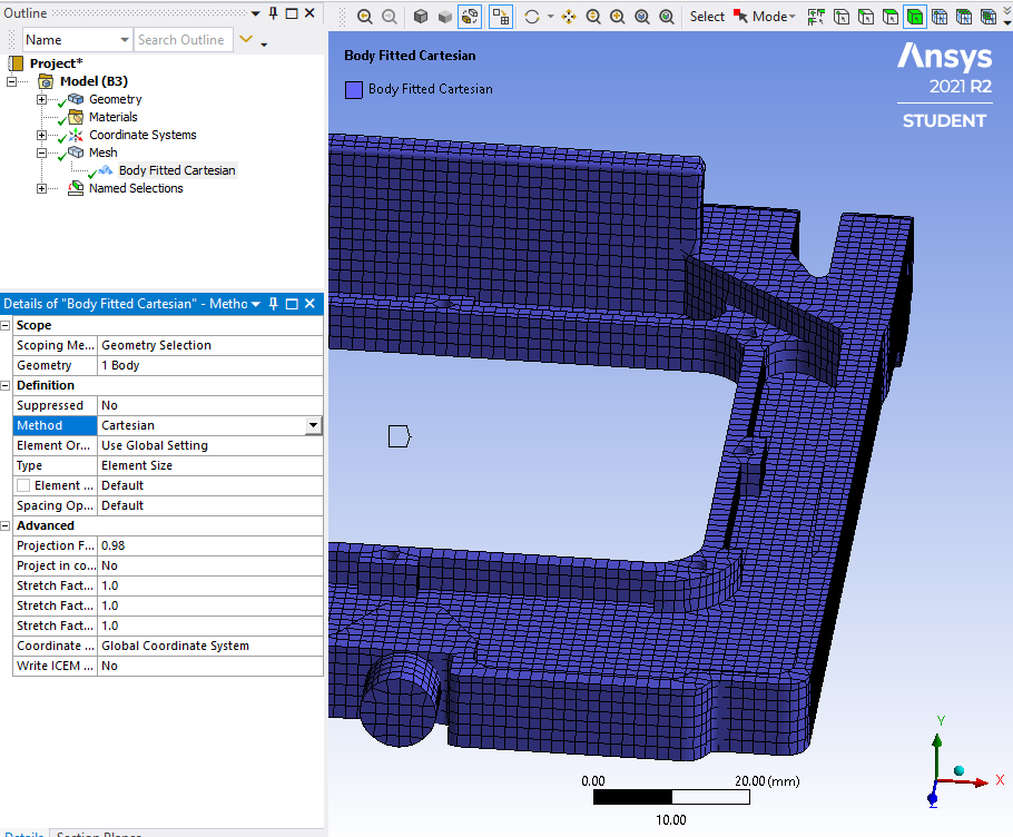

Could you please let me know where the cutcell meshing is in mechanical 2021R1? It was in "Advanced" part in ANSYS 2019R2, but now I cannot find it.

Forum ModeratorCheck it's not been labelled as "assembly meshing". Note, you need to set the solver to be Fluent otherwise it'll remain hidden.

Subscriber; The physics preference is on CFD and the solver preference is on fluent. I cannot find anything!

Forum ModeratorIt may have been removed as it was superseded by poly meshing and latterly poly-hexcore in Fluent Meshing.

Forum ModeratorThanks not sure I'd want to use that for a fluid region!
