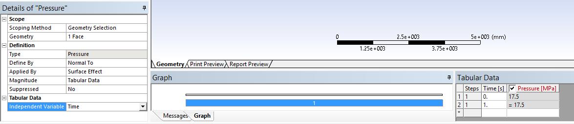

I am doing nonlinear buckling analysis in ansys workbench. To capture the nonlinear post-buckling behavior of the structure, i am using Arclength method. But when using it, workbench always shows the error "Arclength method does not allow tabular loads". I don't know why it happens?
I applied a pressure of 17.5 MPa , but it is converted into tabular form. how to rectify it?
I have attched the error msg.
Thanking You

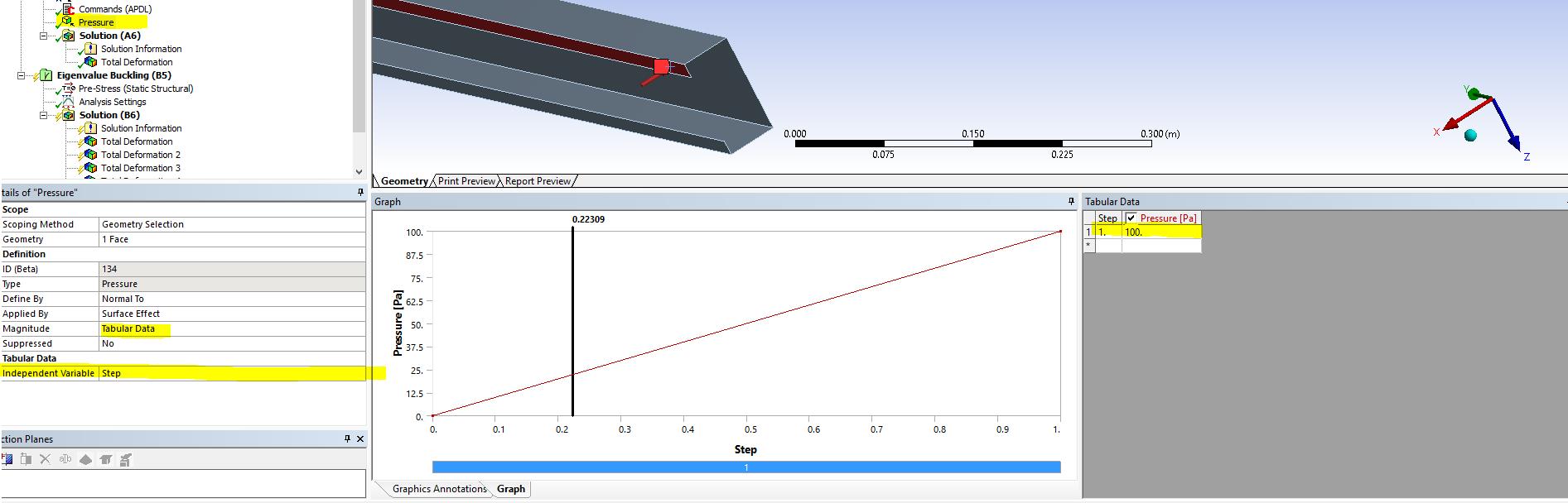

SubscriberI is funny this one. I would make sure you delete it and redefine it,Â
This will help to define it:
https://www.eng-tips.com/viewthread.cfm?qid=448149
(The above approach in the link, works, see below)
Alternatively I would use stabilisation if you have some complicated buckling (say snap through), which works much better, and is available in WB by deafult (no need for commands)

jj77
SubscriberWell just change it from the drop list next to it ??
July 15, 2019 at 10:44 am
venugopal4048
SubscriberNo sir.
It Shows only 4 options. They are 1.Time, 2. X 3. Y 4. Z
There is no Step option.

July 15, 2019 at 10:56 am
jj77
SubscriberÂ
I am talking about my post see image where I have chosen step. If you do not have it is likely due to the old version you have. I used 19.2 student version which you can upgrade to. (As for the command snippet that is from someone else not me - So I can not comment)
As I said if you do not want to upgrade just use stabilisation instead it is much better than arclength which I must say is not really great.

September 10, 2019 at 10:16 am
venugopal4048
SubscriberJ.Orooji!
Yes i solved the problem. I used ansys 18 version, where you select Tabular load, then select independent variable as step. Arc-length method works very well with this.
